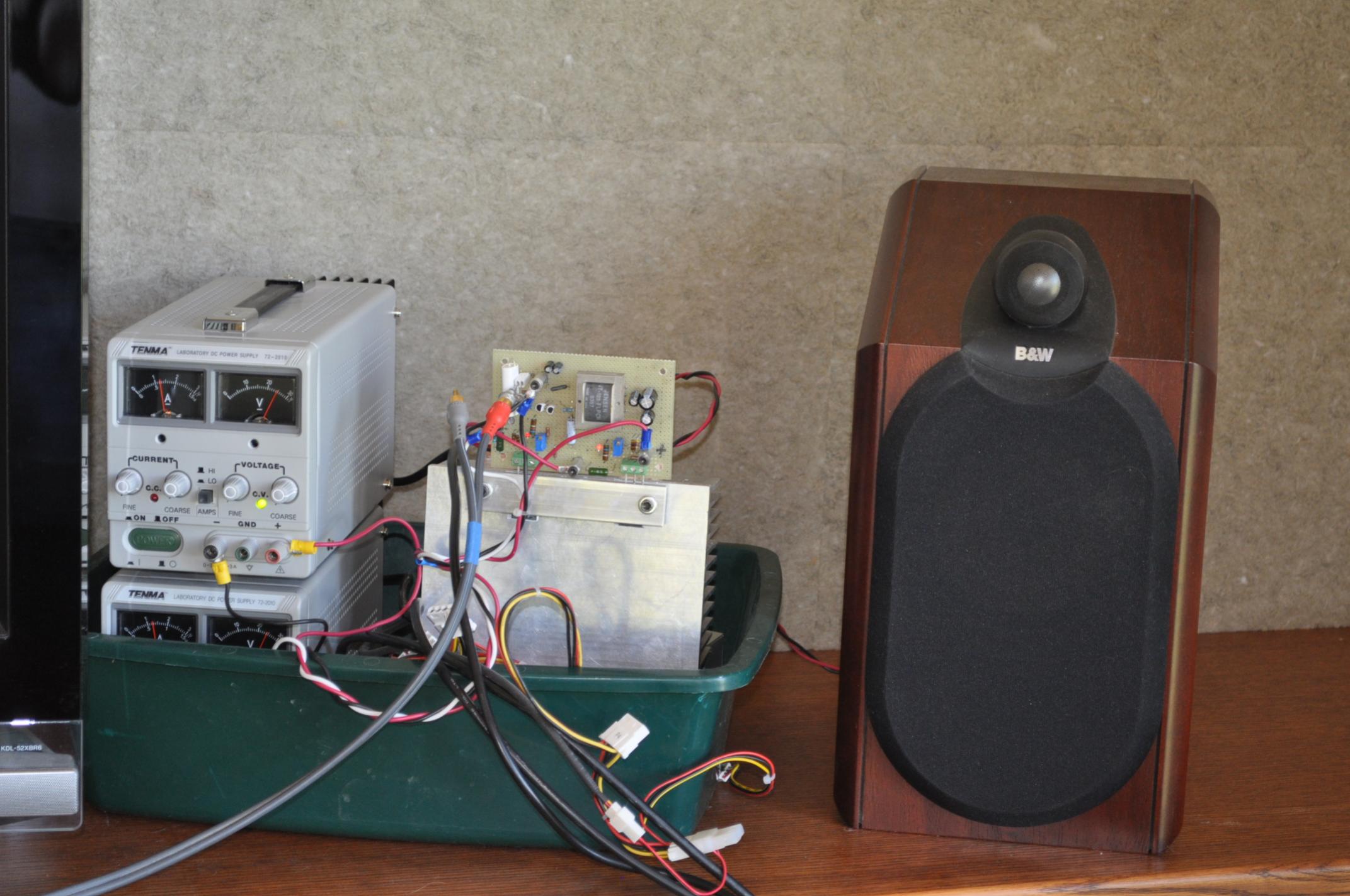

I finally decided to listen the my Guess5 (aka. Teaser) in my normal listening room as shown in the image. I played some selections that previously exhibited defects in other amplifiers.
  • Miles Davis "Sketches of Spain/ Will'O the Wisp: A good test for high frequency problems. Sounds fine.
  • Charlie Byrd & Ken Peplowski/ The Bossa Nova Years/Corcovavo: The guitar plucks can exhibit problems in some amps. Sounds fine.
  • J. S. Bach/ Toccata and Fugue in D Minor: Pushes the bass - my B&W CDM1 speakers are not up to the task. No problems detected.
With mono listening I cannot yet pass judgement on this amplifier. There is no obvious coloration. I did not detect any faults other than a minor power-off click, probably due to the bench supplies.
My next decision is whether to build another prototype board like shown, or to push ahead on the PCB.

No problems, sounds fine. You really got my interest now:rofl:

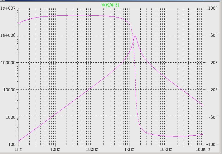

I think I have stumbled onto the secret of the F6. The clue was provided by my investigation of the transformer impedance vs. frequency reported on in post #1213. If that plot is made for the range 1Hz - 100kHz we get the plot shown, where the vertical axis is the impedance across the primary plus the series DC resistance of the primary (point Y to ground).
It occurred to me that I should experiment with different values for the impedance of the feedback network. Previously I had only used R1=50 ohms and R2=10 ohms. Today I did Spice simulations for other values of R1 and R2, with R2/R1=5, and found the THD vs. frequency at 1 watt was nearly constant with R1=5K R2=1K. The source resistors were 0R33.

R2=1k looks very strange.
What signal is left to the primary?
:headbash: My stupidity! The THD numbers were correct, but I neglected to notice that the output voltage was being reduced approximately by the ratio of the Z/(Z+R2||R1) where Z is the transformer impedance. :ashamed:

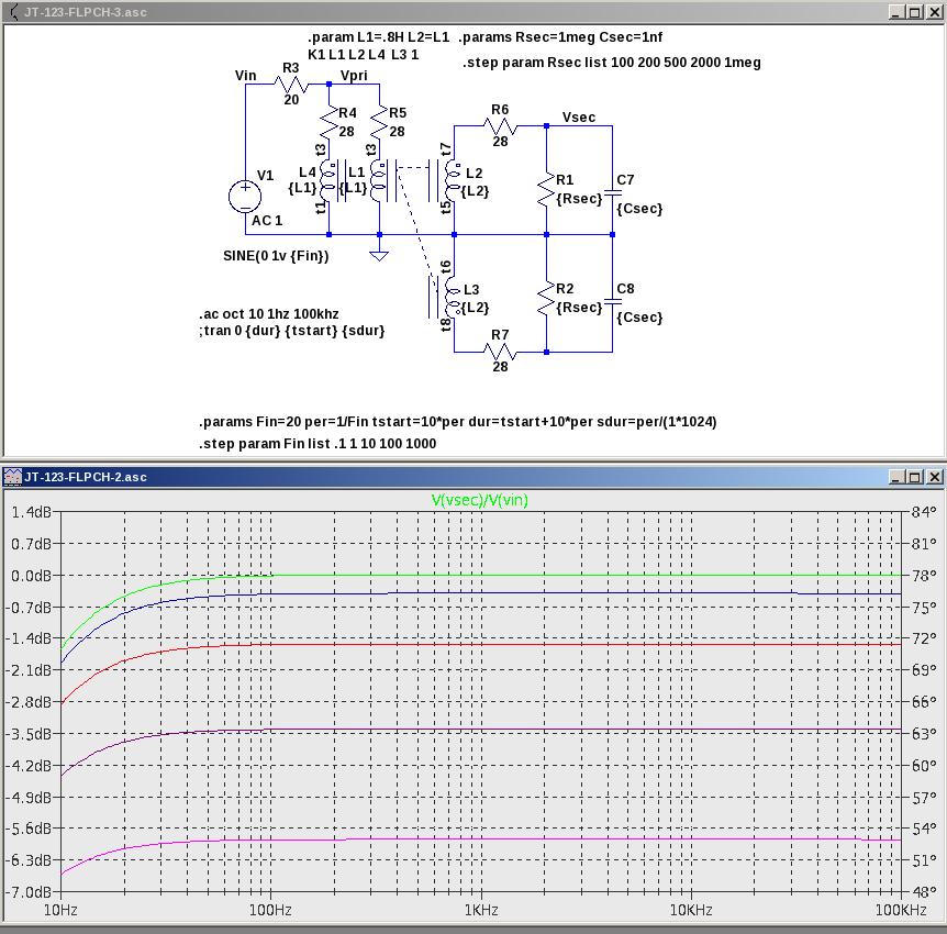

In fact, impedance curves show just the opposite: the input driver impedance should be low in order to flatten the output frequency response curve. In earlier posts, Zen Mod discussed the importance of secondary loading. Here is the transformer V(sec)/Vin vs frequency for different values of Rsec. From bottom to top they are 100R, 200R, 500R, 2K, 1meg. At 100R, the 20 Hz rolloff is only -.18dB vs. -.47dB with an Rsec=1meg. Unfortunately, secondary loading also reduces the open-loop gain.

Official Court Jester
Joined 2003
sim/calculate for prototype
then listen and measure
accent on listen
my remarks about importance of secondary loading are staying carved in stone , but if Pa is saying that SS gate impedance is low enough and flat enough for exact Jensen type , I would not argue for a second
especially if I'm not having Jensens on hand

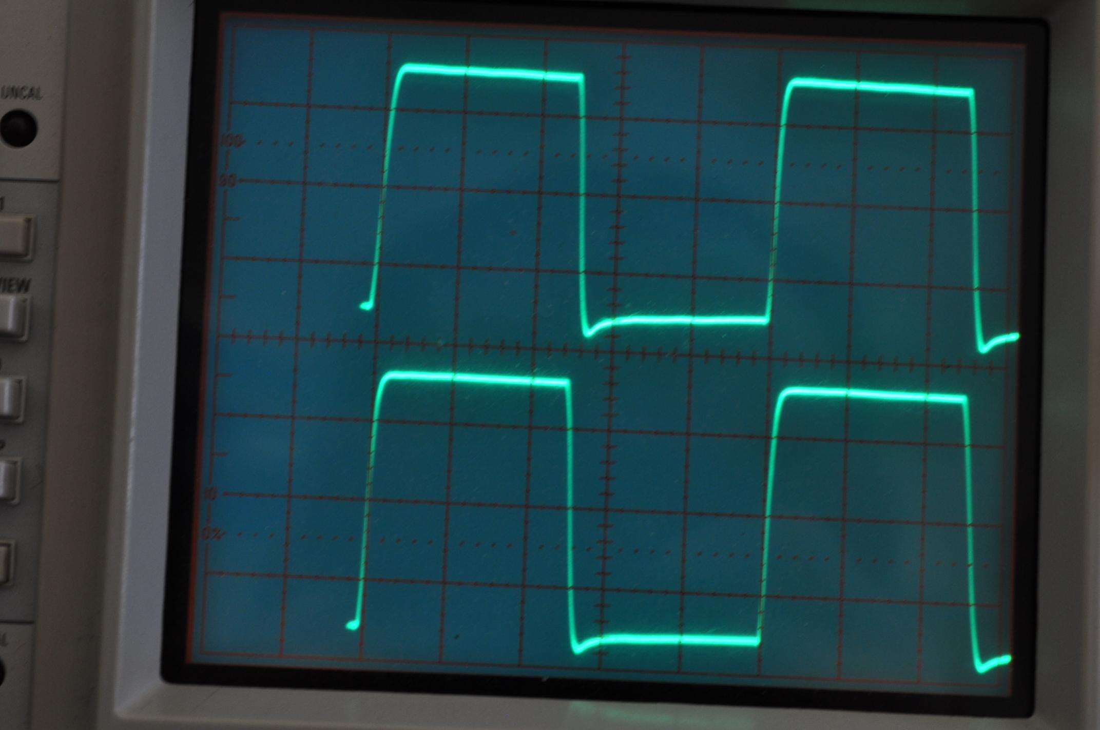

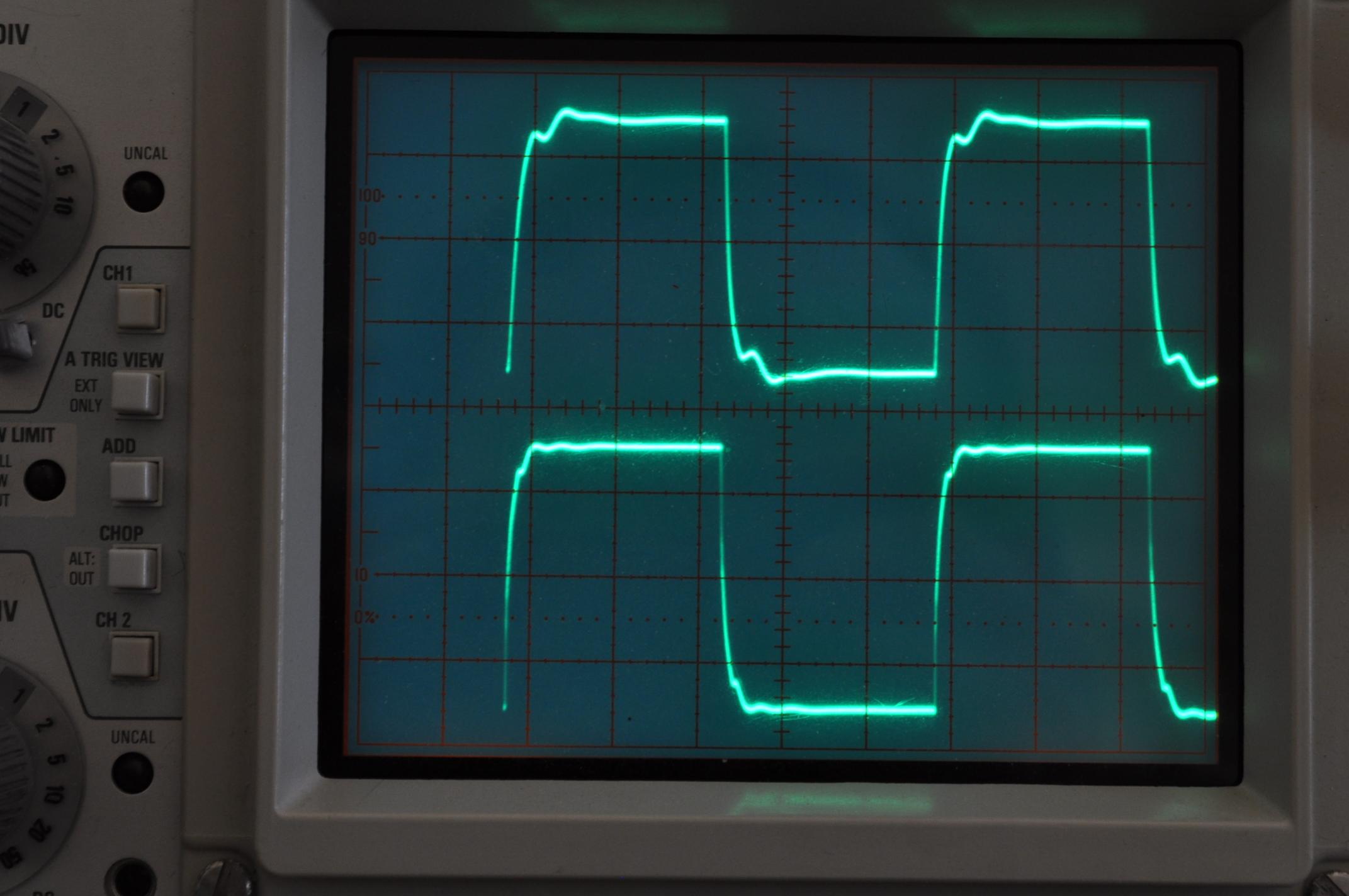

Those Jenson trannies seem to be very good. Here are scope photos of the square wave response.
The first image is for a 1MHz square wave from a 50 ohm generator directly into both primaries and no load on the secondaries. The bottom trace is voltage across the primary. The top trace is voltage across the secondary. Horizontal scale is .2us/div.
The second image is for a 100kHz square wave from a 50 ohm generator directly into both primaries and 1nF load on the secondaries (similar to the SS100 JFETs). The bottom trace is voltage across the primary. The top trace is voltage across the secondary. Horizontal scale is 2us/div. There are some artefacts, but I would not call it ringing.
Is that a good transformer?

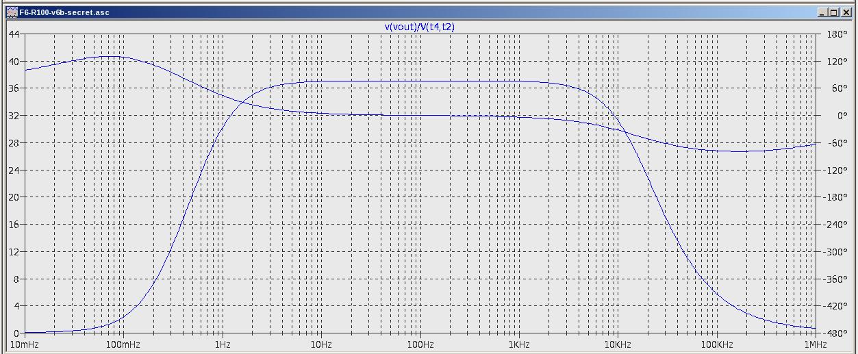

Here is a plot of open-loop gain vs. frequency. Too much roll-off at high frequencies for a no feedback amplifier.
Joined 2003
Does anyone know how much DC current through the transformer primary can be tolerated without added distortion? The question is motivated by the issue of the input JFETs not necessarily being well matched in IDSS. A potentiometer could be added to trim the input stage offset voltage at the cost of increasing the impedance driving the transformer.
do not bother yourself - just make input buffer careful as usual
