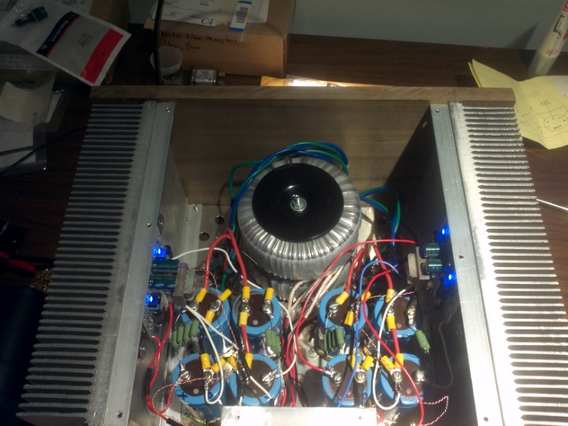

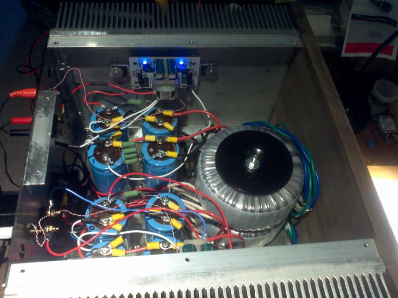

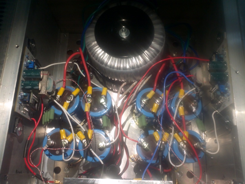

Hi PKI,
Thanks for that bit of enlightenment.
What I realized was that if I were to run the leads even longer, I could have bundled the wires at the base plate of the amp, instead of running them the shortest path. I can be penny wise, pound foolish. It's just the way I grew up. It's a behavior I'm trying to break. Also, the wiring is mostly 12 gauge and a bit of 14 gauge, so it's a bit harder to "hide".
Also, if I used a PCB for the cap banks, it might have looked more tidy.
I could have made a PCB out of perf board and just flipped everything and it might have looked "cool" with all the caps nicely presented, but hind-sight is best left to those who can see the future, or those better at building amps.
I like access to things inside, so I can reach them without taking heat sinks off or generally dismantling everything.
What you don't see (obviously ) are the 8 primary leads and 6 thermistors.
That's probably because they are at the base plate of the amp. Also, some of the extra wire allows me to remove the back plate and make connections with little difficulty. Again, coming full-circle, longer wiring runs could have allowed for the same.
I know it's nauseating to some, this horrible wiring. I feel the same way about builds with plexiglass or acrylic with LEDs lighting up large fonts that are advertising the make and brand they didn't design, but that's just me!
With the cover on, all this doesn't matter much. When you hear it, you will not care. Trust me!
Thanks!
Vince

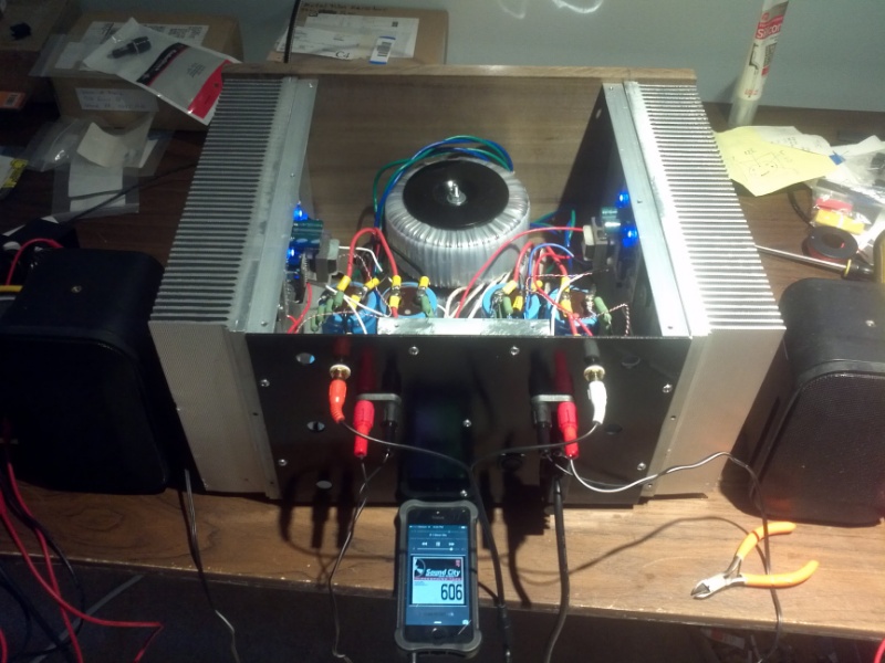

Vince, is the amp quiet? If so, make no apologies for the wiring.
Yes it is quite. The Jensen's are close to the toroids, but there is little noise at the 94db FR drivers. Have to stick your ear in the driver to hear any noise.
You know Jim, after 3+ months of building this amp, the pay off is the great sound. By the same token, I could have been more patient and considered the wiring more carefully.
BTW- I didn't expect it to sound that much different than the Zen 9 or L'amp CSS amps in the room. It does though. There's some resemblance to the others, but it's its own thing. I could go on and on about its sound. Most important, it has a shocking amount of power. Makes the other two amps sound polite by comparison. I heard the F5T v3. You'd think the F6 is 100w amp as well. Maybe it's just a good pairing with the drivers!
What they say is true. The instruments are huge in the sound stage and it has great depth.
I know the Semisouth FETs are a bit hard to get, but the DIY F6 is another great amp in the blood line, and should be strongly considered. Should be interesting to see what people say about the mosfets F6. If it's anything like this, build it!
As always thanks for your help!
Vince
