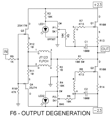

Gonna need degeneration and I can assure you that it is one of the major advantages of the SS. That being said, I expect them to do better than IRF, but could be wrong. Have some Exicon laterals coming that will allow for no Rs, but they dont haev the gain of the SS or other alternatives. Fact is, all others are a tradeoff. Semisouth fan still has some and so does TeaBag. expensive like good glow plug.

Why do you equate having the transformer secondary connected directly to the source and having a source resistor below that connection with degeneration? It is not degeneration since the Vgs does not depend on the voltage drop across the source resistor. The F6 (and other similar transformer coupled topologies) is unique in that the source resistor can be used for DC bias and thermal stability without affecting the AC signal coupling.
Who said i did. In my preferred version, I have a degeneration resistor on the top fet. Is this not an example of an f6 with degeneration.
