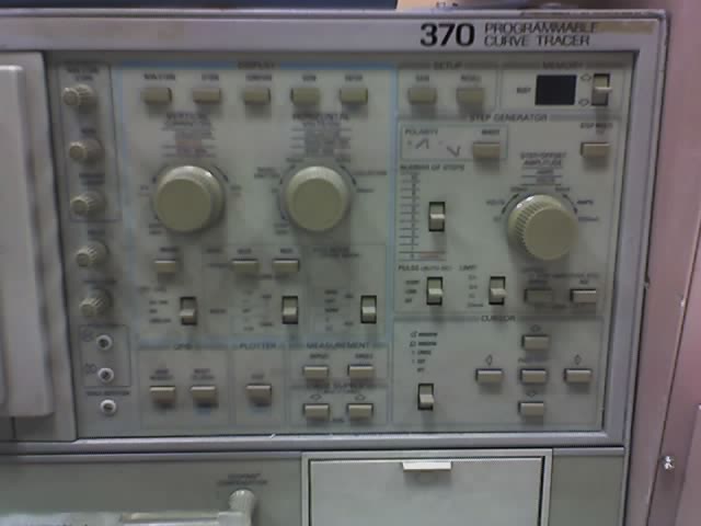

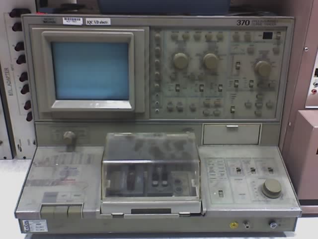

This would be a suitable instrument.
I found this in a South-Korean multinational company warehouse in Romania.
They had no idea what it is.
May be some kind of oscilloscope?
Arrgh...
Unfortunately, I may brought it home only to poor quality images.
