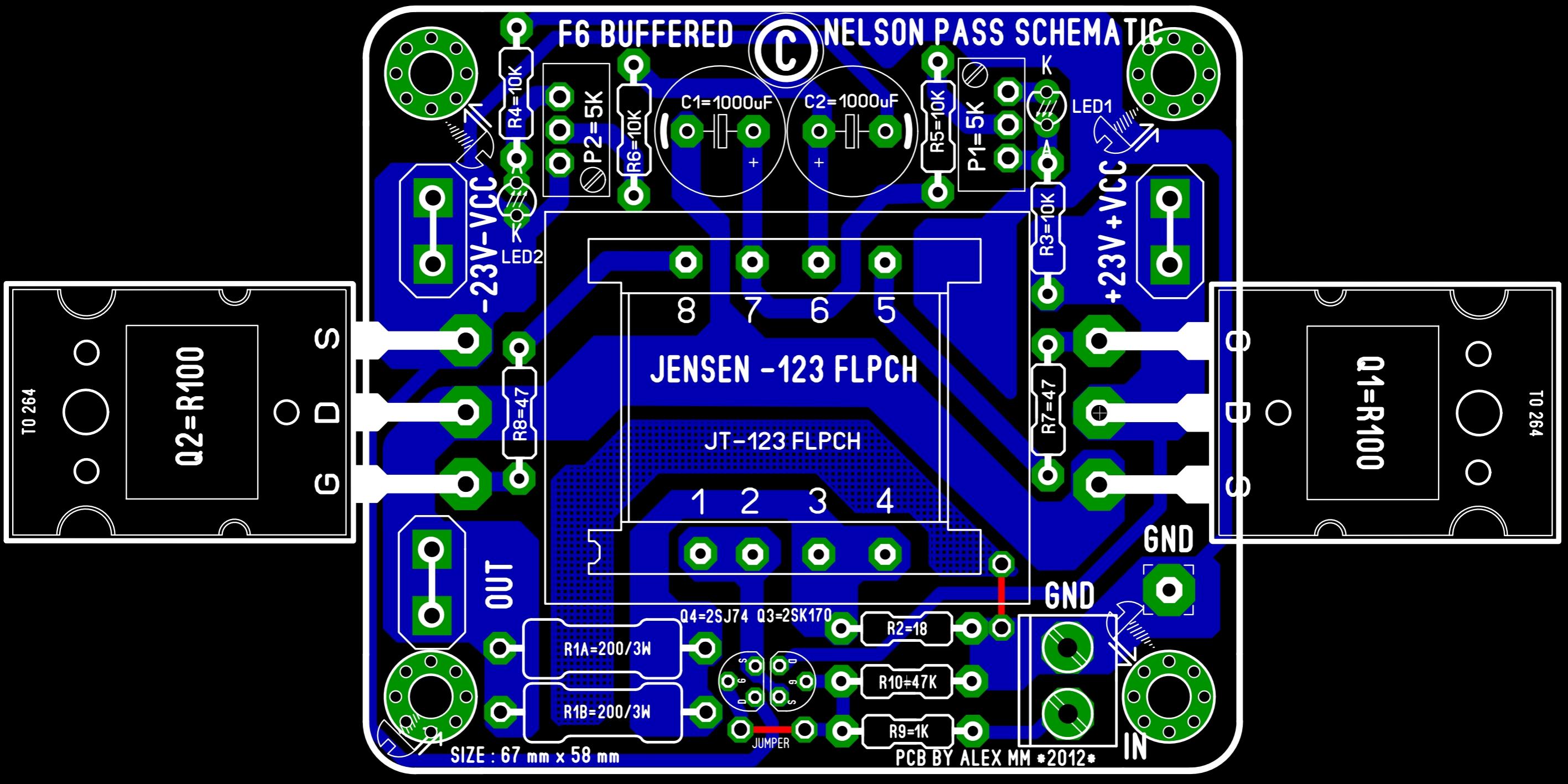

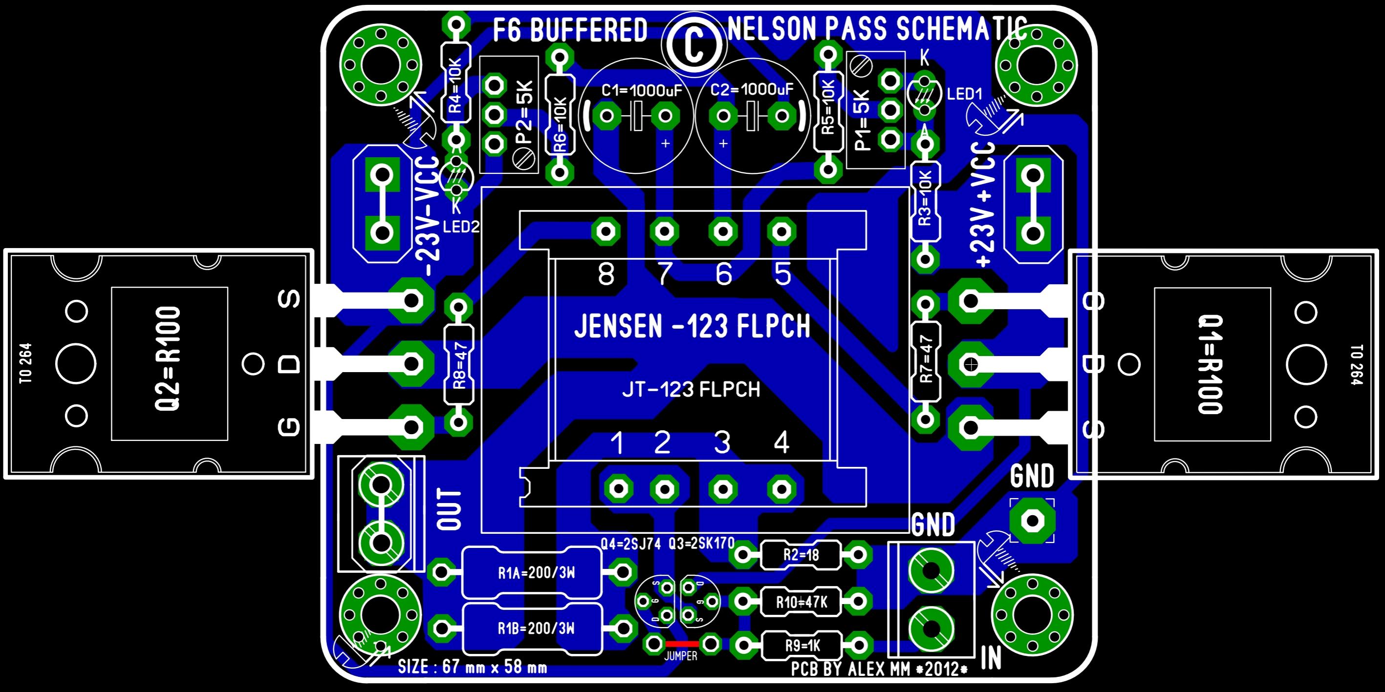

PCB F6 audio amplifier
........ my contribution :) single side PCB
Regards Alex.
