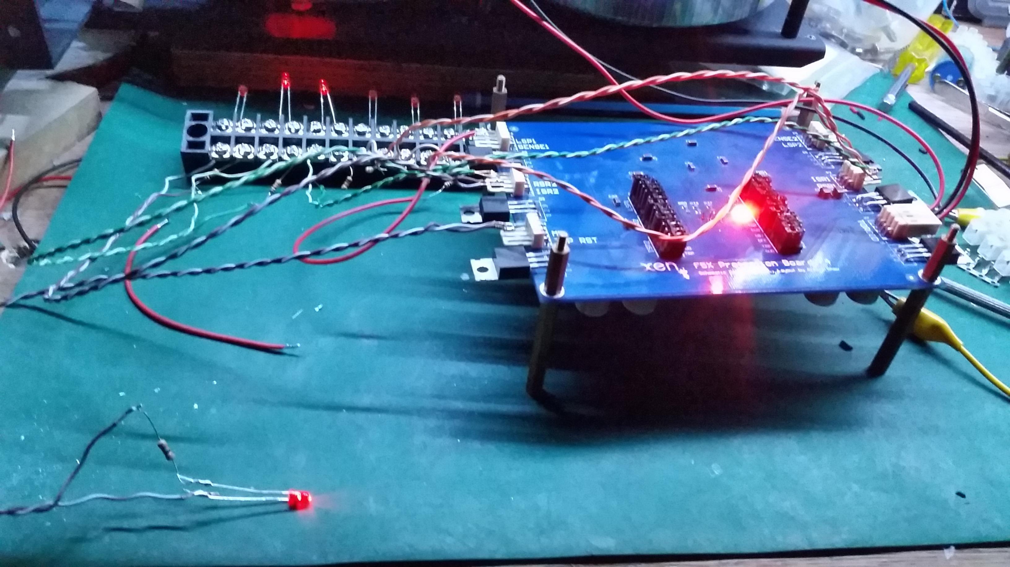

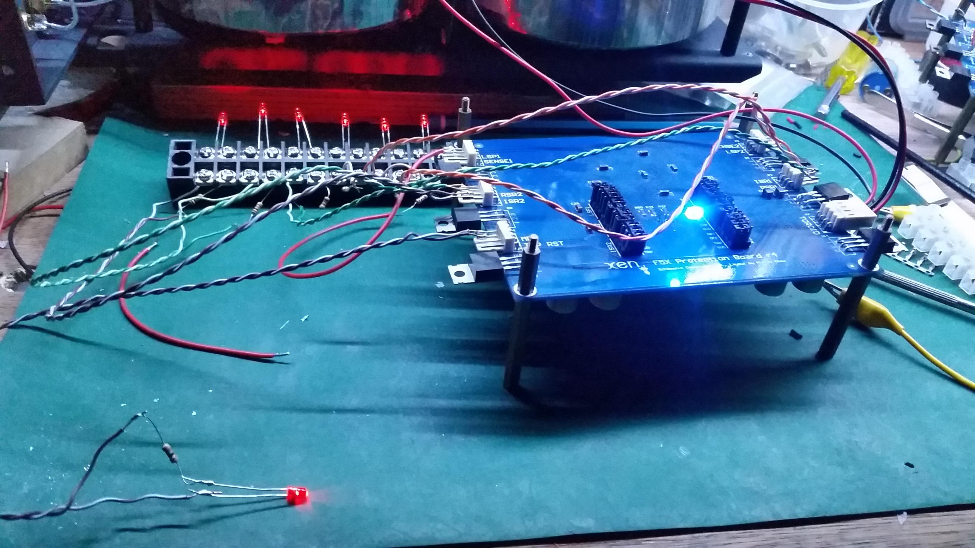

I have finally got my protection board working but I lost the 2 seconds delay when powering up the amp from the back panel on /off switch. Meaning to say, once I switch on the amp, the MR led lights up instantly. I think it should be okay since the speakers and inputs are still dis connect at this start up. I use flux to clean up the board but there are still tiny particles in between the really tiny legs of those semI conductors. What do you guys use to clean up the board?
I believe you still have some shorted pins somewhere.
Your 3-state toggle does not seem to behave as intended.
You should clean your PCB properly using a PCB cleaner spray.
And you can remove excess solder from the SMD parts using a thin solder wick.
It helps if you use 0.3mm solder and a magnifying glass, during solder and after (for inspection).

Magnifying glass and good lighting is crucial. I have removed all the excess particles on the board, including those in between the legs of those chips and now I have 9 seconds of delay time when powering on the amp from the back panel's switch. 3Vdc across the speaker sense shut the board down.
You're right, Patrick. I do believe that the excess solder particles are shorting the pins and altering it's behaviour. Can I use plastic screws (from those plastic standoffs) to mount the regulators, etc to the front panel? If I use metal screws it will connect the board to the ground.

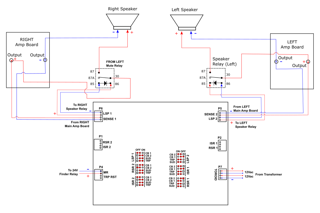

You can see the mute and regulator relays (D4) using protective diodes. Some automotive relays have built in diodes. If they don't, you should add one somewhere.
Thanks for the pictures. I can solder the diodes for the speaker relay directly onto the legs of the relay, correct?
Yes, the back emf diode can go across the coil pins.Thanks for the pictures. I can solder the diodes for the speaker relay directly onto the legs of the relay, correct?
Check whether the relay coil works both ways. Some are polarised and only accept +ve to a specified pin.
