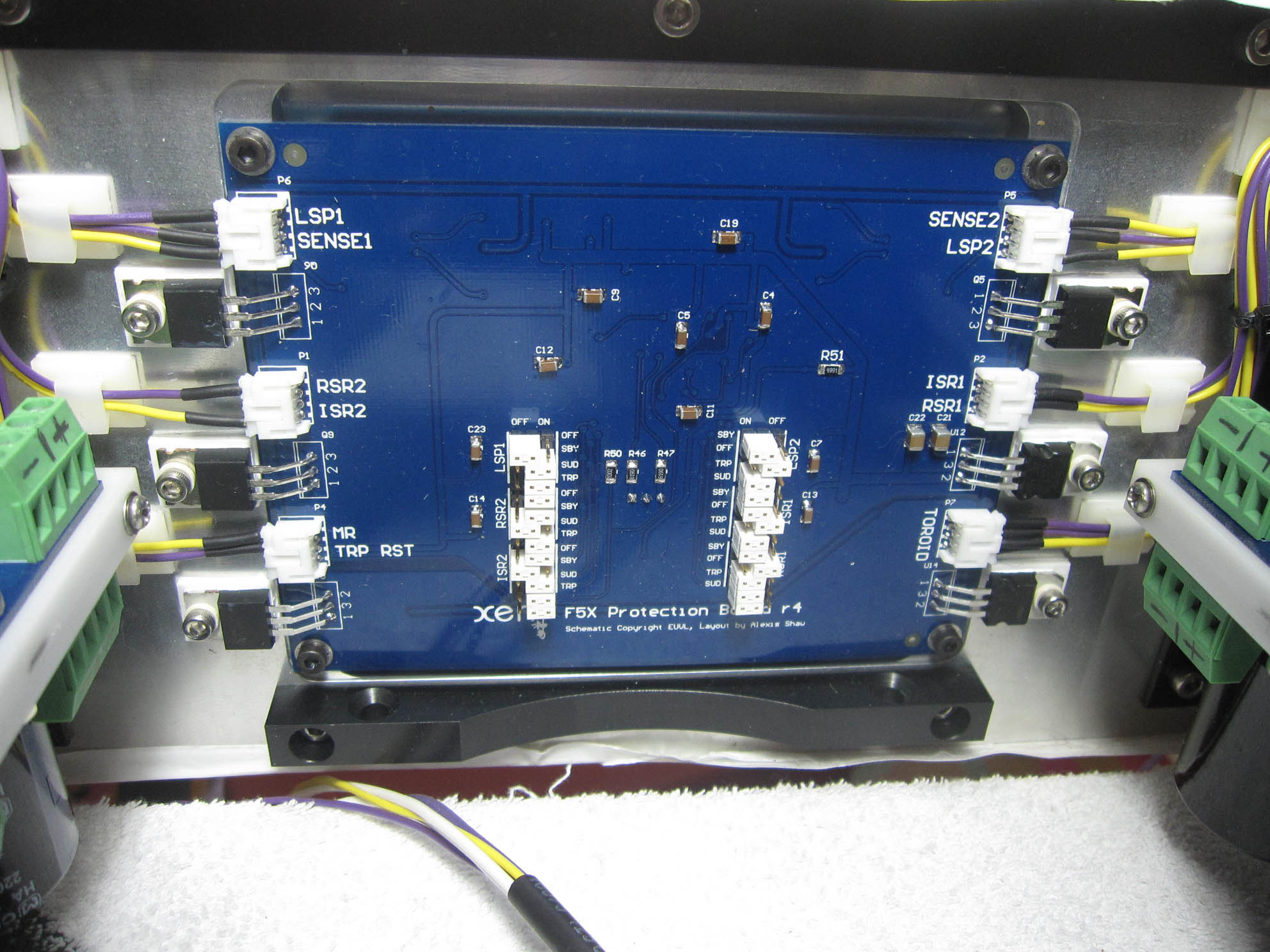

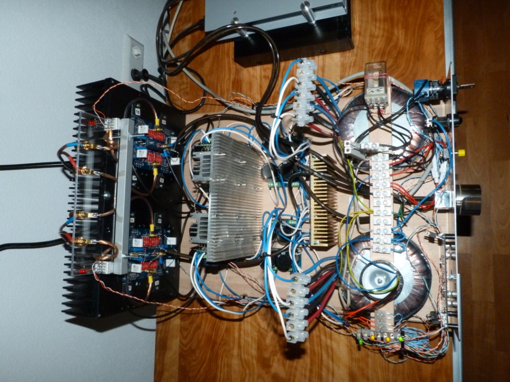

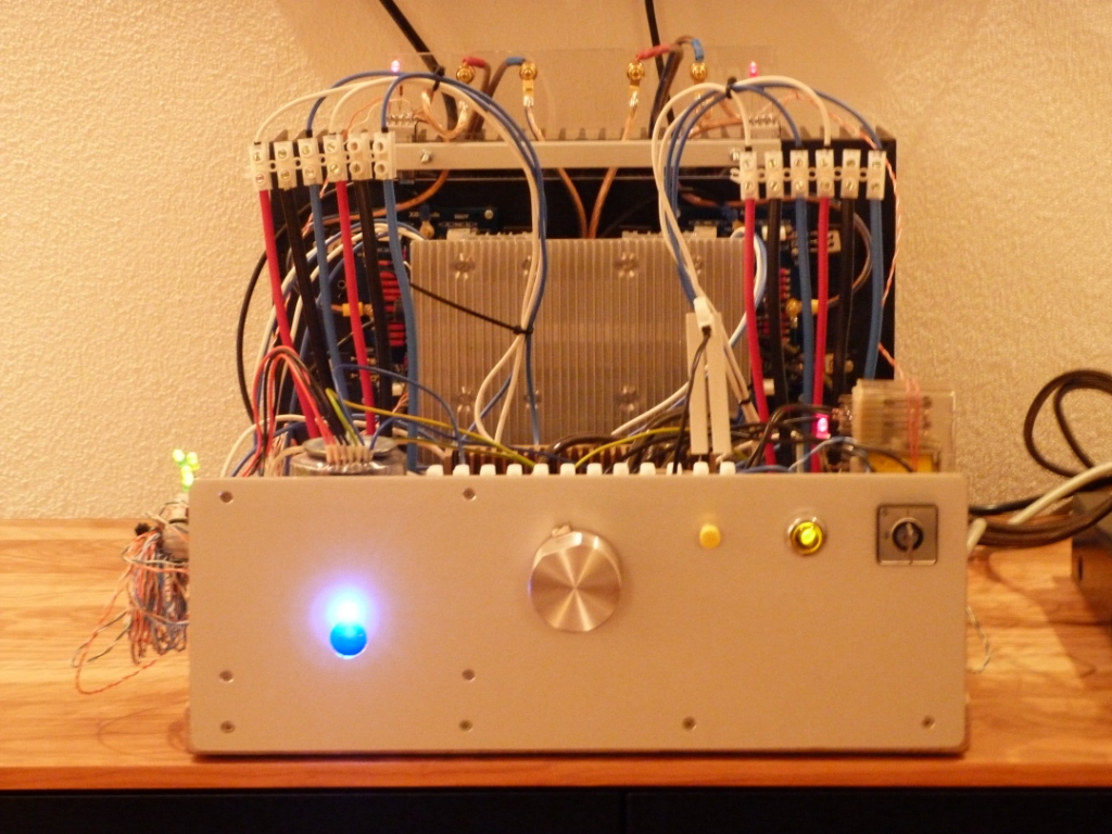

F5X proto II, protection board integrated
Our first protection board is now fully integrated in our F5X proto II.
The integration was straight forward, mainly mechanical and electro-mechanical work, which is also fun.
For sake of consistency I think I should report the list of deltas w.r.t. the original XEN audio configuration:
1) The rush-in current limiter NTCs are not in yet because I do not have them availabe yet. Instead I helped myself with two 100Ohms resistors (one for each transformer) bridging the mains relays. So right after switching on the mains switch the caps in front of the regulator board are gently loaded via the resistors. When the start-up delay time has passed the caps are at operating voltage already and the resistors are bridged by the mains relays.
2) The mute relays on the amp input board are not in yet. The startup behavior I have seen on my analog scope is so smooth and well-behaving, that I am not sure if I need the mute relays at all. Next step I´ll take some traces with my digital scope and then I will decide if I will integrate the mute relays.
3) The amplifier boards still do not have current limiters to protect the power devices in the case of a short-cut across the speaker terminals. I am a bit concearned about loss of audio performance but I have to admit that I do not have experimental evidence. Maybe I should think off a modification of the proto that facilitates a one by one test with and without current limiters.
Has somebody else related experiences?
4) The input signal is still single ended.
This configuration I have tested today.
Everything works as expected.
( Qualitative results only, measurements will follow)
Startup:
Smooth, no rush-in currents. no switch-on bumps on the speakers.
Speaker Protection:
Checked
Markus

If you use regulators, slow start is ensured. But it is still good practice to have the NTC.
The NTC at steady state has less resistance than a single relay contact.
And you WILL need the input shunt in case of trip, especially if you use a shunt trip at the speaker end (like I do).
It has been widely reported that the current limiting circuit has negative effect on SQ.
Since you already have full blown protection, I would leave that out.
And you are NOT giving the amp justice by not using a balanced source, which I know you have.
Patrick

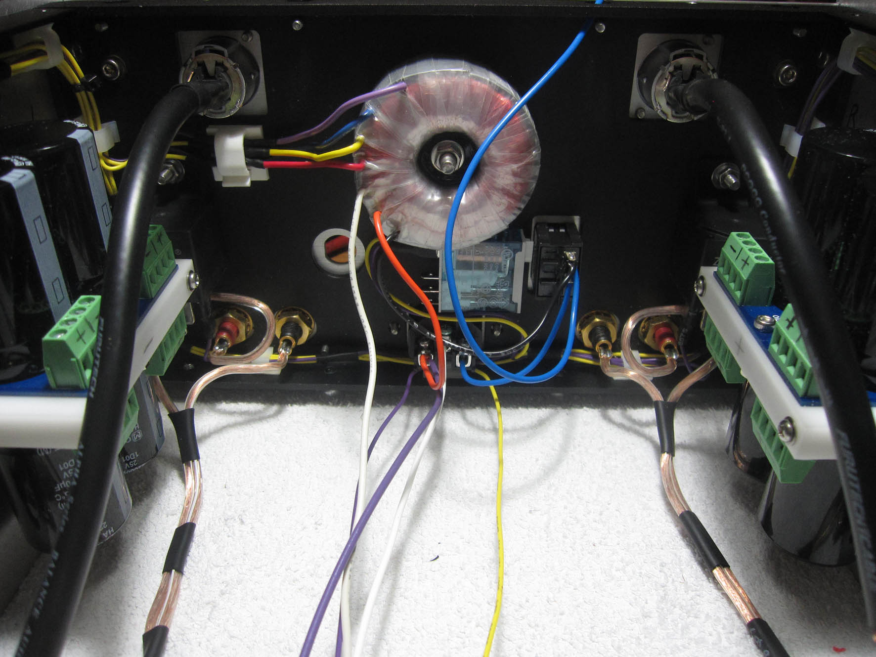

I’ve chosen the top, and routed my protection wiring accordingly.
Further, I found starting with the front panel protection wiring and routing it through the amp first worked very well.
Once hooked up to all the relays I was able to run another test of the protection circuitry in its final position.
I then hooked up the outputs and inputs. There’s not much now left to do until I receive the regulator conversion kit.
Tip: The fuse holder must have a fuse inserted to release it’s screw top cap. With out a fuse inserted and the cap screwed in place I stripped mine and ruined it
Very neat wiring John.
Seems that the input wires are as thick as the output ones ??
One suggestion if I may :
Those glued-on plastic wire clips probably would not last 10 years at 60°C.
I should consider not using double sided foam tapes to fix them, but M3x6 screws.
Which means you need to tape some blind holes on the heat sink and the front panel, unfortunately.
Patrick

Thanks Patrick,
I did consider the longevity of these clips, I knew there life expectancy at temp would be compromised, I plan to keep an eye on this
Edit; Oh yes, those inputs, more insulation and shielding than thicker conductors (18awg), the outputs are occ 16 awg... haha
Patrick,
many thanks for your remarks.
As soon as I will have the NTCs available I will integrate them.
The resistors are only a temporary solution, otherwise about every
second amp start-up we are sitting in the dark because the fuse in the
e-power cabinet trips due to the rush in currents ( > 16A)
Well, I think I got your point and I also understand that you do not like to have relay contacts in the signal line.
But the concept of a shunt trip at the speaker end I do not fully understand.
The amp is a voltage output amp of which output voltage is never exactly zero, even when the input voltage is shunted by the mute relays. So without a current limiter you will get a shunt current that is determined by output voltage offset of the amp and the sum of relay contact resistance + amp output impedance. Consequently you need to get the output voltage offset small enough (over lifetime) and the relay contact resistance plus amp output impedance high enough (also over lifetime) to make sure that the shunt trip will never destroy your power devices.
Therefor I guess this configuration is only an option for those who have enough sets of spare devices, isn´t it?
The majority of DIYers like me do not have this luxery.
I am currently considering an alternative concept and I am wondering what will be wrong this:
Why not shunting the power supply lines between regulator output caps and the amplifier board? Thanks to the cap-less amp design there is no energy stored in the amplifier. This means from speaker protection persective shunting the power supply of the amplifier board should be as good as shunting the amplifier outputs. In addition I would insert fuses in the power supply cables right in front of the shunt relays. The fuses will trip in both cases, when the speaker protection trips but also when the amp output currents exceed critical levels due to an external short cut.
Certainly you and others have already though this option through and there must be a critical point that I have missed. All remarks and hints are appreciated.
Many thanks for your advice. I will happily leave that out.
Yes, indeed. I´ll think about how to interface the balanced source to the proto. Tomorrow the local electronic shop here in town will have open, so I could get the missing parts.
The need for an appropriate preamp becomes more and more apparant
Markus
