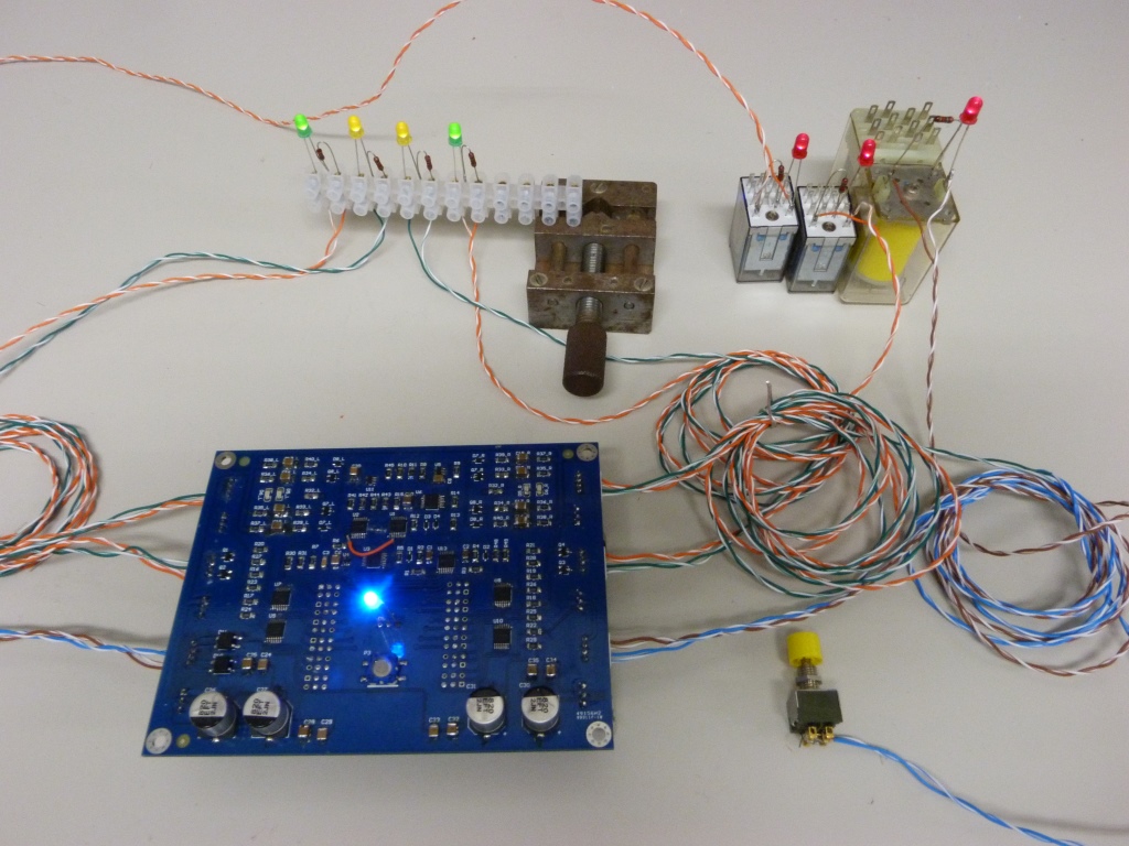

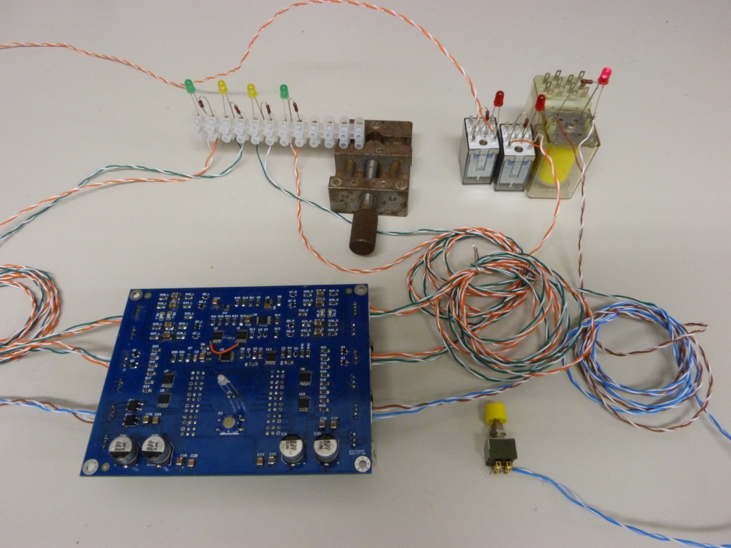

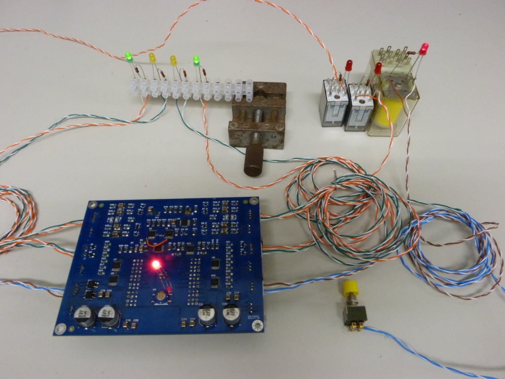

Protection Board Alive
Today our first protection board became alive.
Fixing the startup sequence with the wire bridge was a bit tricky,
but with some patience (and a magnification lens) no problem.
First time right, everything works as expected:
Start up sequence: checked
Speaker protection trip: checked
I guess that´s not too bad, all three of us made their first SMD soldering experiences with this board. Lucky beginners or naturals 🙂
But more important at this point, congrats to the designers.
Markus
