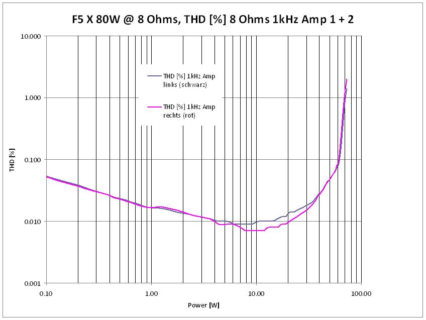

Could you perhaps show a THD plot below 0.05% ?
Patrick
As requested a plot with logarithmic THD scale for better resolution.
It's also a comparison between my 2 monos.
After listening a few days now these babys seem to be played in. They became smoother every day and man do these go low. Incredible low end.

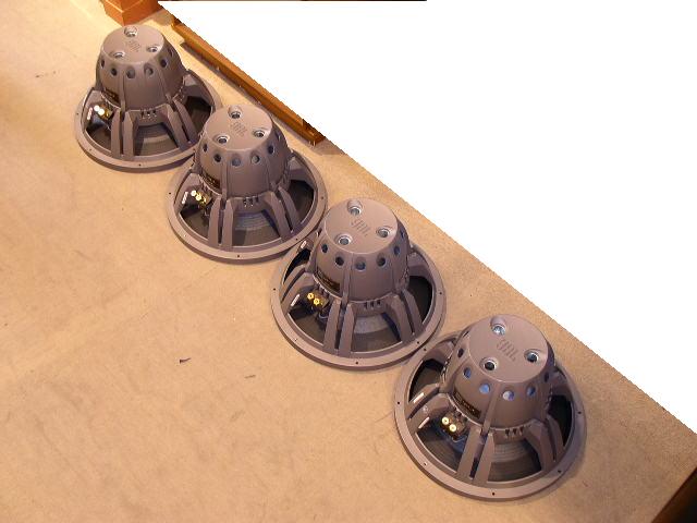

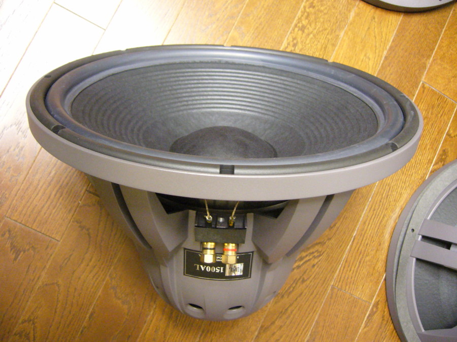

What are they driving ... BLS ? How will they handle the load of 2 1500's ?
Contingency ?
Cigar time !
No, Radian/Truextent, BLS Horn, 1400ND, new custom speaker project. But that's another story.
JBL 1500AL's ? 2 per side? I expect no problems.
Nelson said about the F5 "It will drive a 2 ohm load without burping, and 1 ohm without misbehaving."
The X version won't do worse

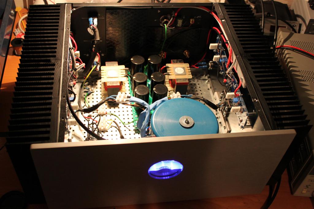

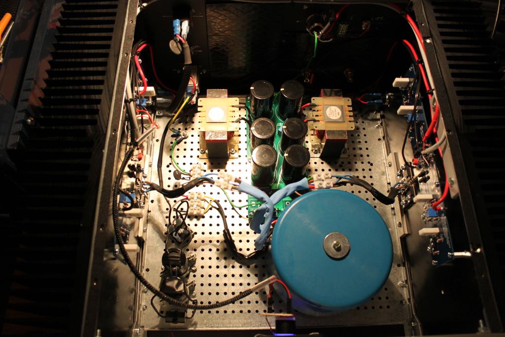

Here are some pics of the finished amp.
It's great to see proof of the IRF outputs in a Balanced F5!
In addition, you did the project without a huge expense for a case or PCBs any regulated power supply.
I tip my hat to you...

I did a Cascoded Balanced F5.
I started it about a year ago (around the time the group buy for the ongoing XF5 began) and finished it about 8 months ago. It was very easy and straightforward to build once I got over the prejudices of some of the forum members.
I used the Conrad heat sinks, degenerated complementary pairs, and the Toshiba outputs (I tried the 2SK1530/2SJ201 as well as the 2SK3497/2SJ618).
My total cost was under $600 from scratch. I was interested in trying the IRF outputs, but I was new to amp building and was talked out of it.
I have a J2 clone I'm experimenting with, and a secret weapon I'll bring out once I decide how to use the devices (the hint is the devices rhyme with "fit"). I'm on the sideline for a while, I move in a few weeks and I'm busy packing.

Amp Data
- Transformer 800VA, 2x18V per mono block
- PS CLC 2x 33.000uF 33.000uF 2.2mH/0.12Ohm 33.000uF; total 198.000uF per mono block
- Vrail +/- 21.8V
- Ibias 1.3A per output FET (gives 0.29V across R11/12), 2 output pairs! X-ed 4 output pairs
- output FETs IRFP240/IRFP9240
- input Fets 2SJ74BL/2SK170BL
- app. 70W into 8 Ohms, voltage clipping
- app. 130W into 4 Ohms, voltage clipping
- app. 175W into 2 Ohms, voltage clipping
- app. 200W into 1 Ohms, current clipping

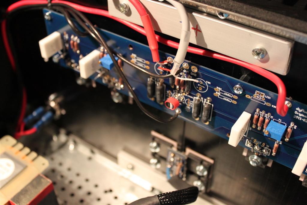

Yes, I know there is a thread giong on F5X EUVL Approach but the diy Store boards are available and why not use them?
I'm currently building 2 mono F5X with the P-F5c-2V20efrom the diyAudio Store.
those are the boards with cacode option and 2nd output pair option.
I'll build the 2nd output option and "X" 2 boards for a mono block.
AFAIK Smyslow did this with the 1 output pair boards but it was not further commented.
To "X" the boards two pcb connections need to be cutted. Not nice but the boards have no "X-Option". See picture.

hello. do you realy need to cut the connections? it look like you can just lift one side of the resistors R1, R2 and wire the X from there.
Of course you can do that. You'll have 4 resistors hanging around then.
not realy. they will be the tip of the wires you need to x the 2 PCB's.
then you don't need to damages the PCB's.
