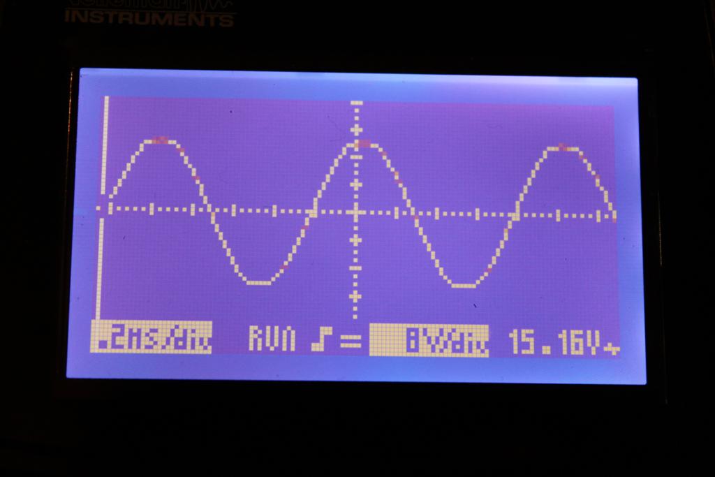

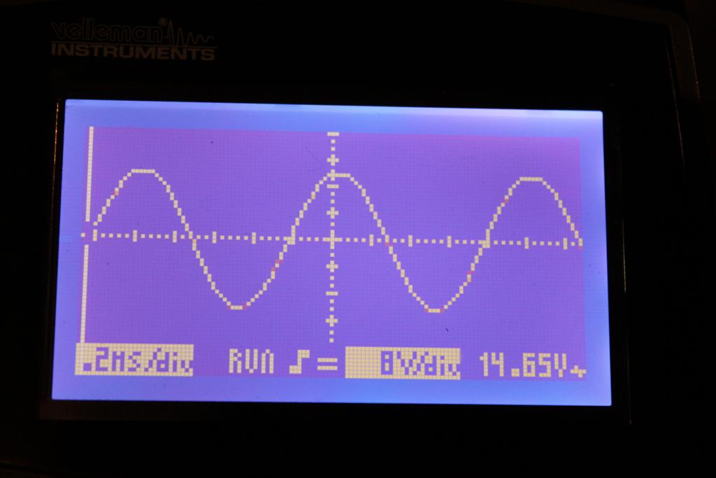

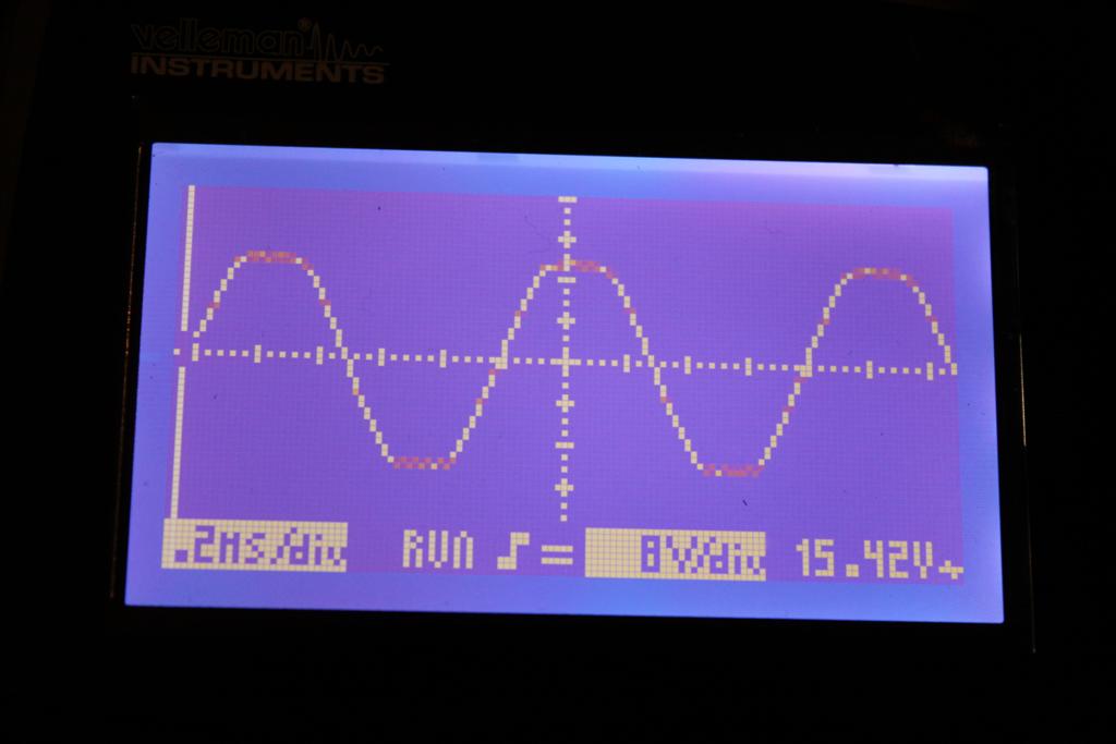

I understand that, but I'm missing a few Volts
Output with 2,3V in and gain of 6 (15,5dB) is 13,8V. With 22V Volt rail....
My PS is ultra stable. 800VA Transformer 2x18V, CLC with 2x99.000 uF, 2x 2,2mH/0,12Ohm.

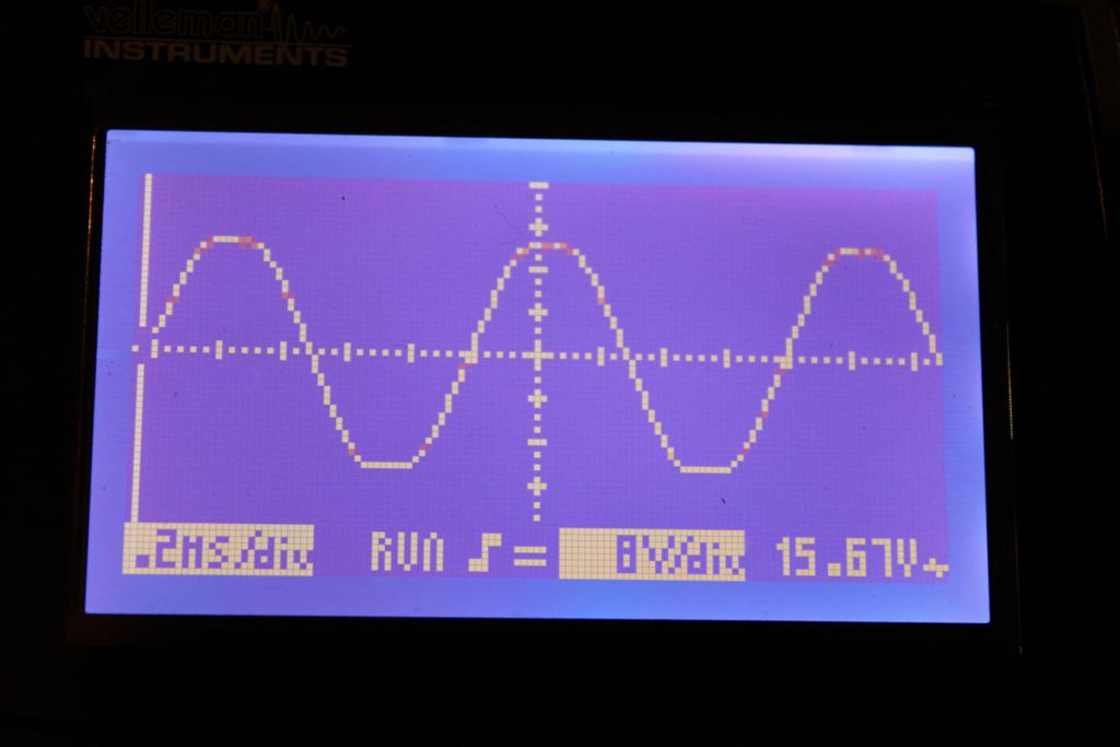

Measurements and Waveform 1kHz 8Ohm
Amp info:
Vrail +/- 21.8V
Ibias 0.6V across 0.47 Ohm 1.3A 2 parallel output Fets Total Bias 2.6A
I out of PS measured 5.4A
NOT X-ed yet.
1. 8 Ohm 2.5Vin 0.5%THD right before clipping
2. 8 Ohm 2.6Vin 1.5%THD start of clipping
3. 8 Ohm 2.8Vin 4.5%THD clipping

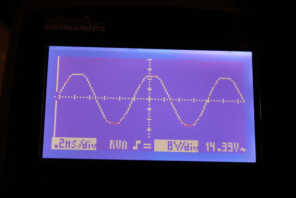

Measurements and Waveform 1kHz 4Ohm
1. 4 Ohm 2.3Vin 0.6%THD right before clipping
2. 4 Ohm 2.5Vin 3.5%THD start of clipping
3. 4 Ohm 2.8Vin 7.5%THD clipping

It looks like the voltage displayed on your "oscilloscope" is Vrms.
The peak to peak amplitude is approximately 5 divisions x 8V = +/-20V approximately.
Assuming that is the case, then the input voltages you quoted are also Vrms.
2.8Vrms = +/- 3.96V Vin
3.96V x gain of 6 = 23.8V Vout > Vrails.
This should explain the voltage clipping which is clearly visible.
Reducing Vin to 2.1Vrms should give you, IMHO, the correct max. output according to your chosen rail voltages.
Patrick

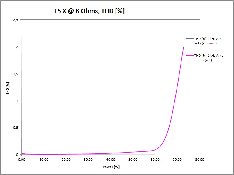

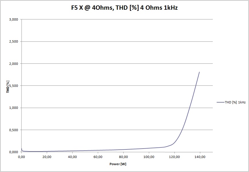

First F5X Mono is running
I've got my first F5X up and running.
Sound is fantastic. All measurements are also fantastic.
THD is incredible low
Power is amazing
Amp Data and Changes made to schematic.
Design
Amp Boards X-ed as described at the beginning of this thread
Post #1
Amp Data
- Transformer 800VA, 2x18V per mono block
- PS CLC 2x 33.000uF 33.000uF 2.2mH/0.12Ohm 33.000uF; total 198.000uF per mono block
- Vrail +/- 21.8V
- Ibias 1.3A per output FET (gives 0.29V across R11/12), 2 output pairs! X-ed 4 output pairs
- output FETs IRFP240/IRFP9240
- input Fets 2SJ74BL/2SK170BL
- app. 70W into 8 Ohms, voltage clipping
- app. 130W into 4 Ohms, voltage clipping
- app. 175W into 2 Ohms, voltage clipping
- app. 200W into 1 Ohms, current clipping
R10 = 33,2k
R21/22 = 22k
R17/R18 = 702
R117/R118 open
R11/R12/R111/R112 = 0.22
That’s it.
