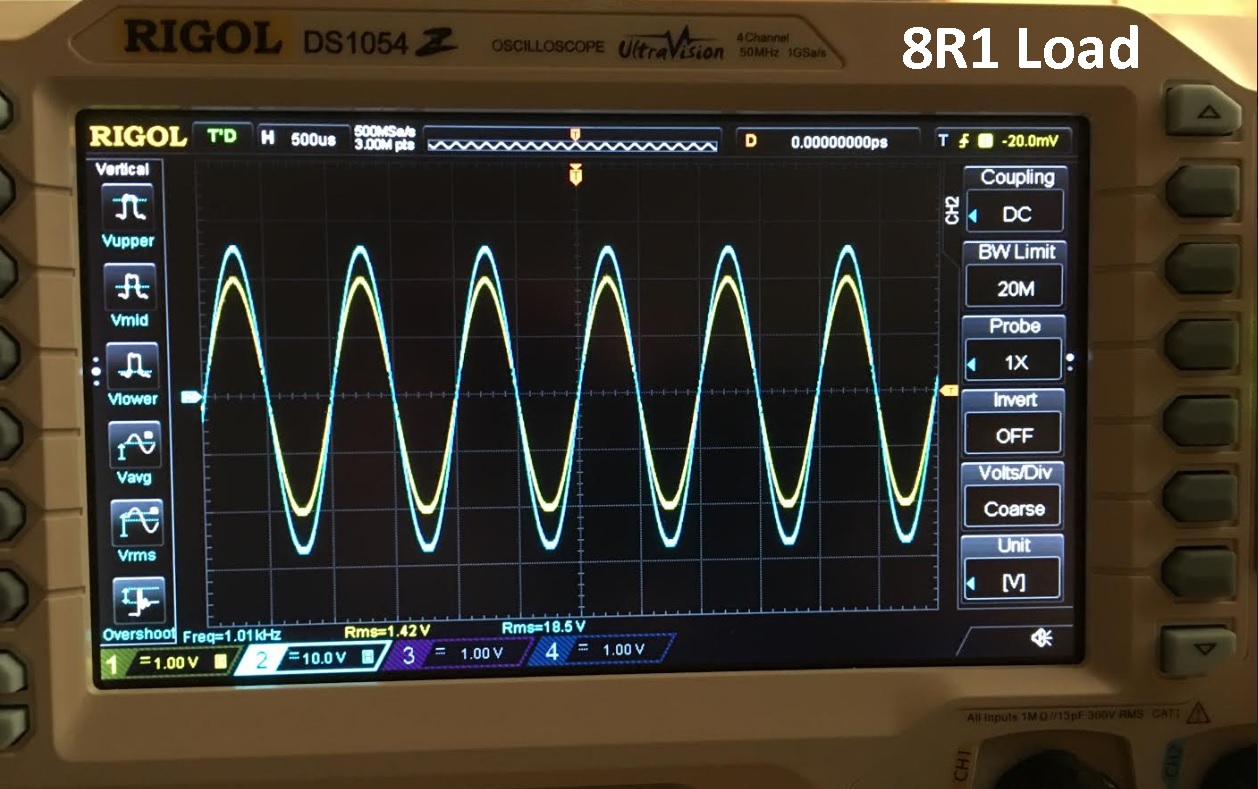

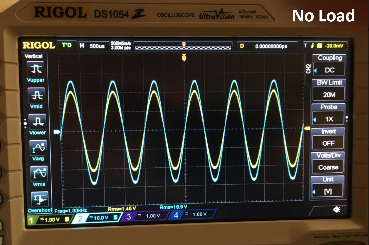

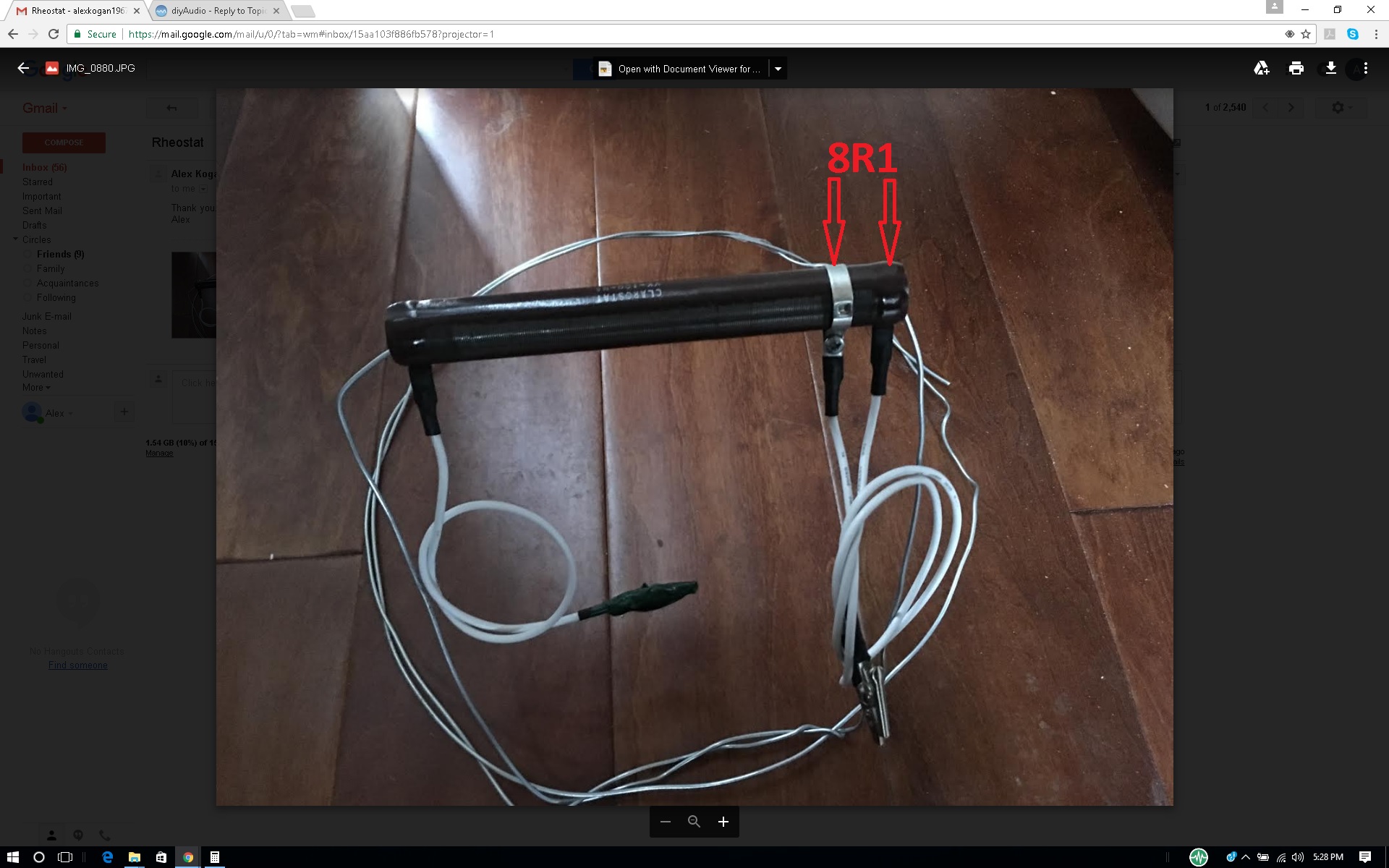

No much difference when I measured OPEN (NO LOAD) and with 8R1 LOAD. Please see attached images.My load resistor (I used 100R 100W rheostat which I set to 8R1) got hot and resistance bit changed to 9R5 during my short test. So, No LOAD, Gain is 24.8dB, with Load 24.7dB.

I would not expect the gain to change. Your numbers confirm that.
But the maximum unclipped output voltage will be very dependent on the load resistance that is being driven.
Typically I would expect a very good amplifier to show a drop of ~0.5dBv going from open circuit to rated resistance of 8r0.
then drop a bit more ~ 0.7dBv for a 4r0 load and finally to drop a further 0.7dBv changing to 2r67 (one third of the rated speaker impedance).
My targets are set to drop a little bit less than those values.
Open circuit XdBv
8r0 -0.5dBv - rated load.
4r0 -1.2dBv - half rated load.
2r67 -1.9dBv - one third of rated load.
Don't do that to your rheostat. You will end up damaging it.
If you have a 50W 100ohms rheostat, then the maximum CURRENT is given by
Imax = sqrt(P / R) = sqrt (50/100) = 0.7A
If you were passing (28v5/9r5) 3A through it, then you would require a 1kW rheostat to stand that abuse.
I assume that my testing already reviled about 22.3dB Gain, 1. 42v input and 18.5V Max, and -0.5bB with 8r load vs. open. The rest of tests will be as a sport that I do not have equipment to run it. So, based on currently known results, what should be safe Gain recommendation for my DCB3?
