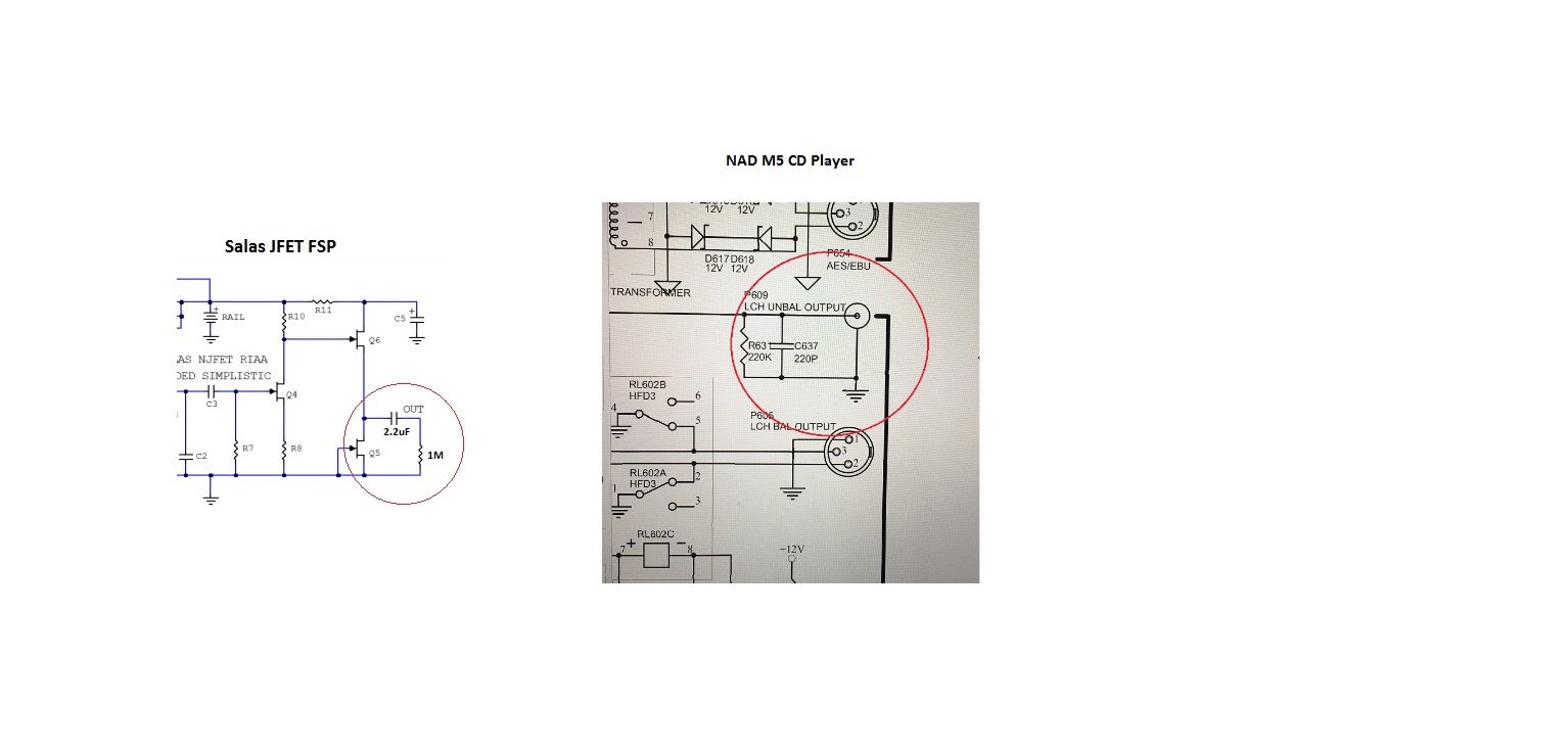

Thank you Andrew. I am sure I have Hypnotize PCB with one input. It is fine by now since I am using that unit as my headphone amp buffer and I connected it as a test device to see how low impedance input is impacting general F5T presentation.

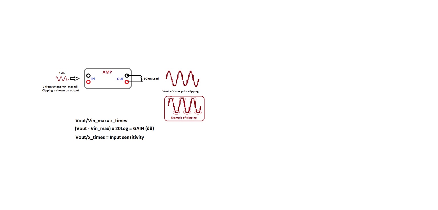

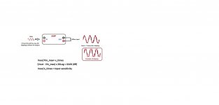

It is my gap since I did not measure input sensitivity till clipping yet. Is any special ways to measure it for my needs? As far as I understand, I need to set like 8 Ohm dummy load, then I need to increase input voltage of 1k sine till I'll see flatness starts on pos and/or neg sine picks on output (on dummy load resistor). That V input will be my input sensitivity of clipping. I'm I correct?
I used my amp with Salas FSP phono which has 1mOhm output resistor. Also, I think that my NAD M5 CD player also has high impedance on output.

You must adjust the input level to ensure there is no clipping of the signal in any intermediate stage.
I assume if I'll have a point when I'll reach clipping on some of intermediate sages (like on fist, second and etc. pair of MOSFETs), then I see clipping at the output any way. So, If I understood the whole procedure correctly, I need to find Vin right prior clipping starts to shown. That would be my MAX input level. Then, I'll measure Vout and Vout/Vin will give me X-times gain.
yes.
Let's assume by way of an example that you have 125mVac at the input as measured on the 199.9mVac scale of your DMM and you have 4.51Vac as measured on the 20.00Vac scale of your DMM.
Then gain = 4.51Vac / 0.125Vac = 36.08times (=+31.1dB)
