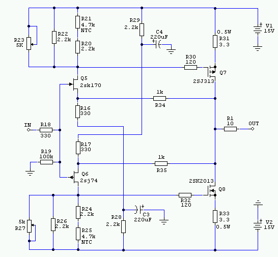

F5 with 2SK2013/2SJ313
Prakit,
there is a way how to further optimize this circuit in order to use it as a preamp.
The thing is that feedback resistor are heavily loading the output which is not a problem when driving speakers and using 3 pairs of MOSFETs in output, but for just one pair it's not optimal. In order to raise the value of feedback resistors we have to raise the value of input JFET's source resistors and the only way to do it (and keep the high Id through JFETs) is to introduce appropriate DC bias to JFET's sources. That's what R28 and R29 are for. C4 and C3 are shunting JFET's sources to ground, AC-wise.
R34 and R16 ratio (as well as R35 and R17) is responsible for the ammount of closed loop gain. R23 and R27 are setting the current through output MOSFETs (300mA or higher) and DC offset (the same way as in original F5).
Should be easy to try, and it should sound better. I'd like to hear your impressions...
I forgot to mention something about the preamp in post #42 :shy:
Using higher value source resistors for input JFETs lowers the OLG, but it's not very important since we need lower CLG in the preamp anyway. I suppose the most will need the gain of about 2V/V so feedback resistors can have lower value than 1k (470R will result in gain about 2.2V/V and it's still high enough resistance that won't overload the preamp).

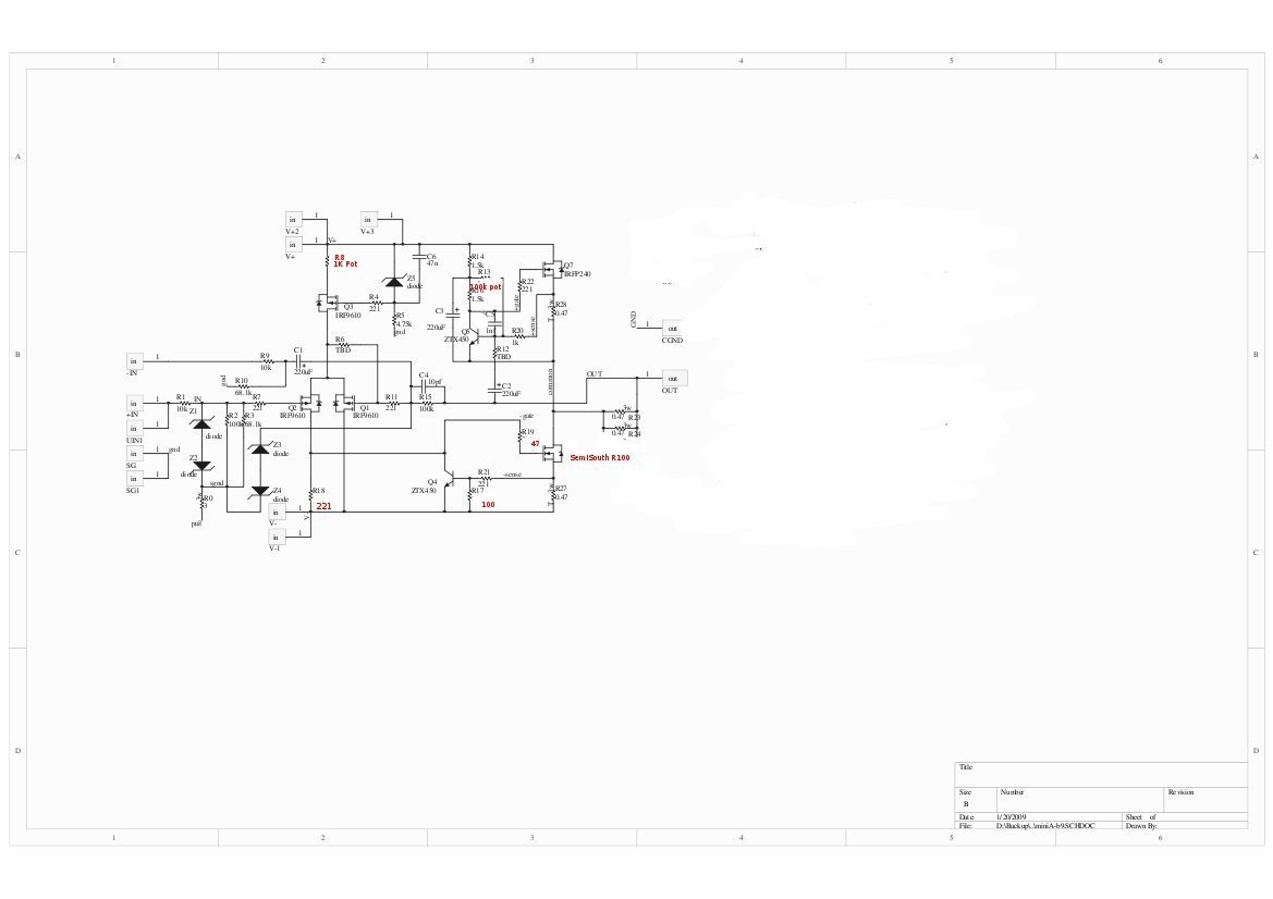

Joined 2006
Juma-
Thanks for the response. I was thinking the 2sk313's as input and CS, and the IRFP240 as CCS and SemiSouth R100 as output. Replacing with one pair of sj74's won't do the heat, but the TO-220's do. I have this running now with the IRFP9610s. Here is a pic. Sorry it is hard to look at. More sorry this is off topic, but I find these Toshiba buggers exciting.:D
If we are talking +/-15V supply optimal version is the one mentioned in post #45. Basically, it's Mini-Aleph-J with k2013 in output section.
j313 as input LTP won't do well with Id=10mA (maybe marginally better than IRF9610, but I doubt it).
IRFP240 and R100 in output will give sub-optimal results with such a low PS voltage.
I see that you are all excited about trying all the new devices at once but don't force it, let the fever cools off :rofl:
