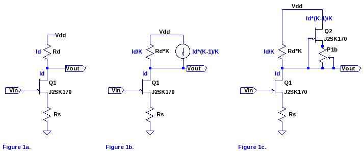

This note describes a technique for increasing the open-loop gain of the F5, F5-turbo, or any other amplifier with a similiar first stage with voltage gain. The open-loop gain of the F5 family is the product of the voltage-gain of the JFET input stage with the voltage-gain of the MOSFET output stage. The voltage gain of a stage is the product of the effective transconductance with the load resistance of the stage. Thus we can increase the voltage gain of a stage by increasing its effective transconductance or its load resistance.
Figure 1a shows a simplified F5 input stage. In the quiescent state (when Vin = 0), Vout(0) must be set to the voltage needed to bias the MOSFET stage for the desired bias current. If the F5 family, trimmer resistors P1 and P2 are adjusted to achieve MOSFET bias current and zero output voltage.
Figure 1b shows how to increase Rd (and the voltage gain) by a factor of K while maintaining the output bias voltage Vout(0). To maintain a constant voltage drop across the Rd*K drain resistor, its current must be divided by a factor of K. The remaining current Id*(K-1)/K is supplied by a constant current source.
Figure 1c shows the implementation of the constant current source using a single JFET and trimmer resistor. The negative side of the F5 input stage is modified similarly.

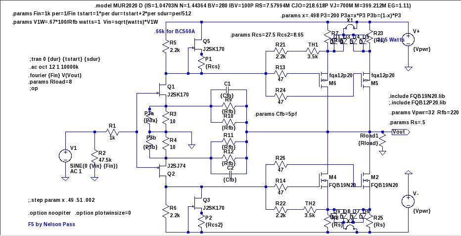

Figure 2 shows a modified F5-Turbo-V2 in which the first stage gains have been increased by factors of 2.75X on the positive side and 3.75X on the negative side. (I need to make adjustments to R6 and R6 to balance to open-loop gains of the two amplifier chains.) I have performed numerous SPICE simulations of this modified circuit and they indicate significant reductions in THD, consistent with the increase in open-loop gain. With the circuit shown, LtSpice reports a THD at 1kHz, 1 watt into 8 ohms of .00055%. Not bad.

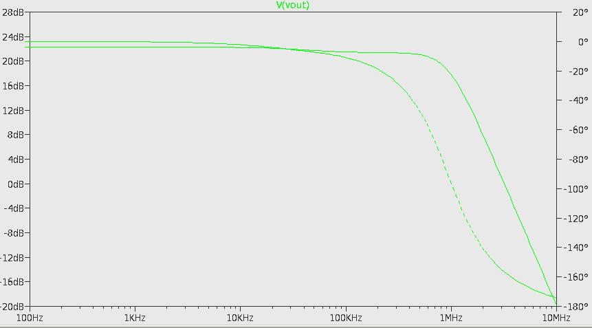

There are two possible issues regarding this modification: thermal stability and bandwidth. My guess is that R21/Th1 and R22/Th2 might need different values to maintain thermal stability. The amplifier bandwidth is reduced since the RC time constant related to Rd and the MOSFET gate capacitance has been multiplied by a factor of K. Figure 3 shows a bode Bode plot of the modified amplifier, in which the bandwidth is still very good and the phase margin is excellent.

why not v3 , this one is not above the current f5 c boards currently available ...
Yes, same question here
Plus this one operate the input jfets above their rating. No cascoding?
Another idea would be to have some clever set jumpers that allow to use the diode places for more power fets. I have no clue about pcb design. It's just an idea. Good for those that want to reduce the value of source resistors (I used 0,22 ohms in my F5X) instead of using diodes.
