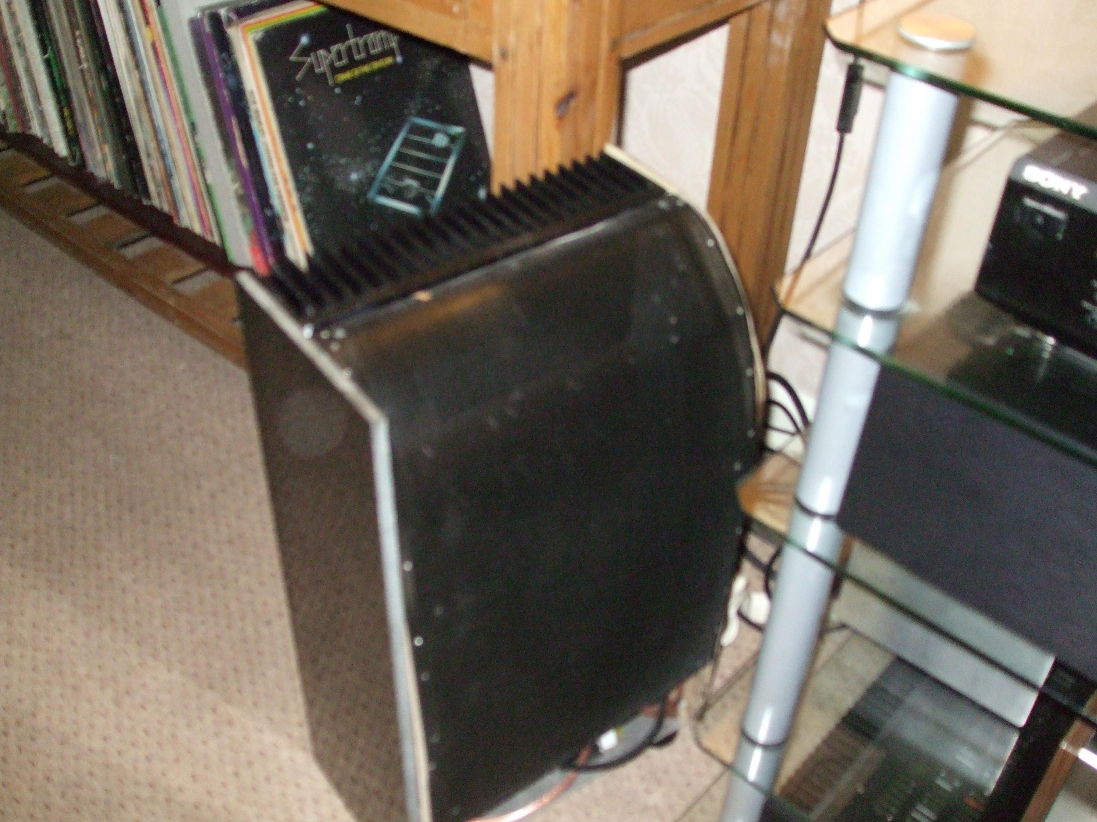

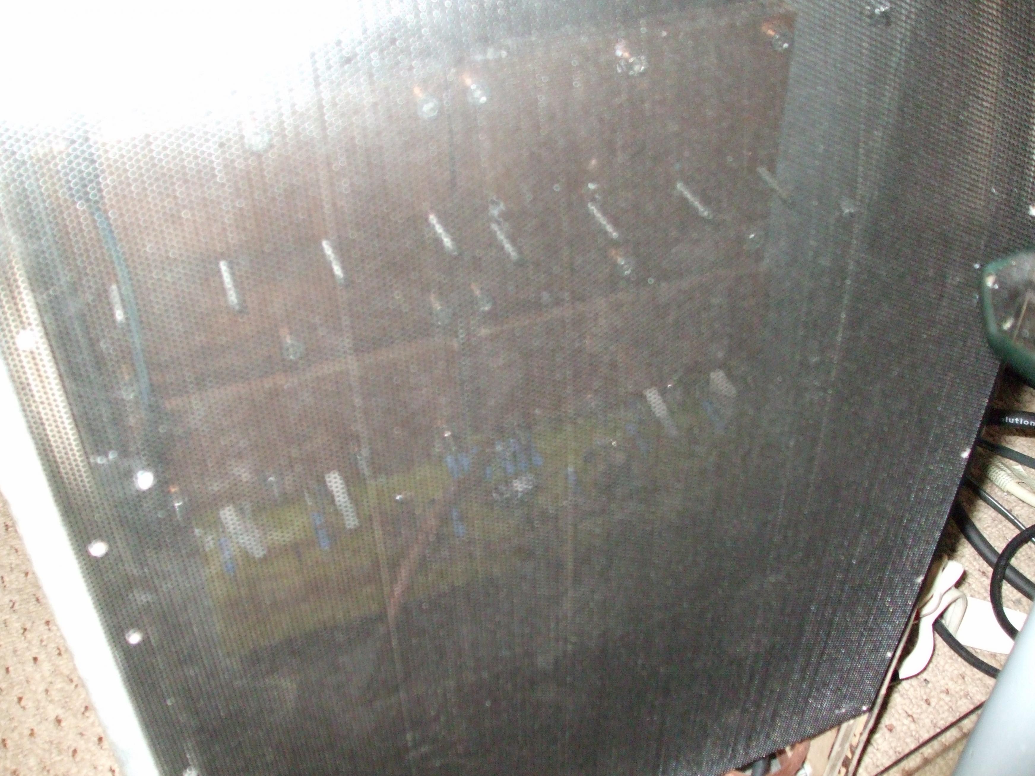

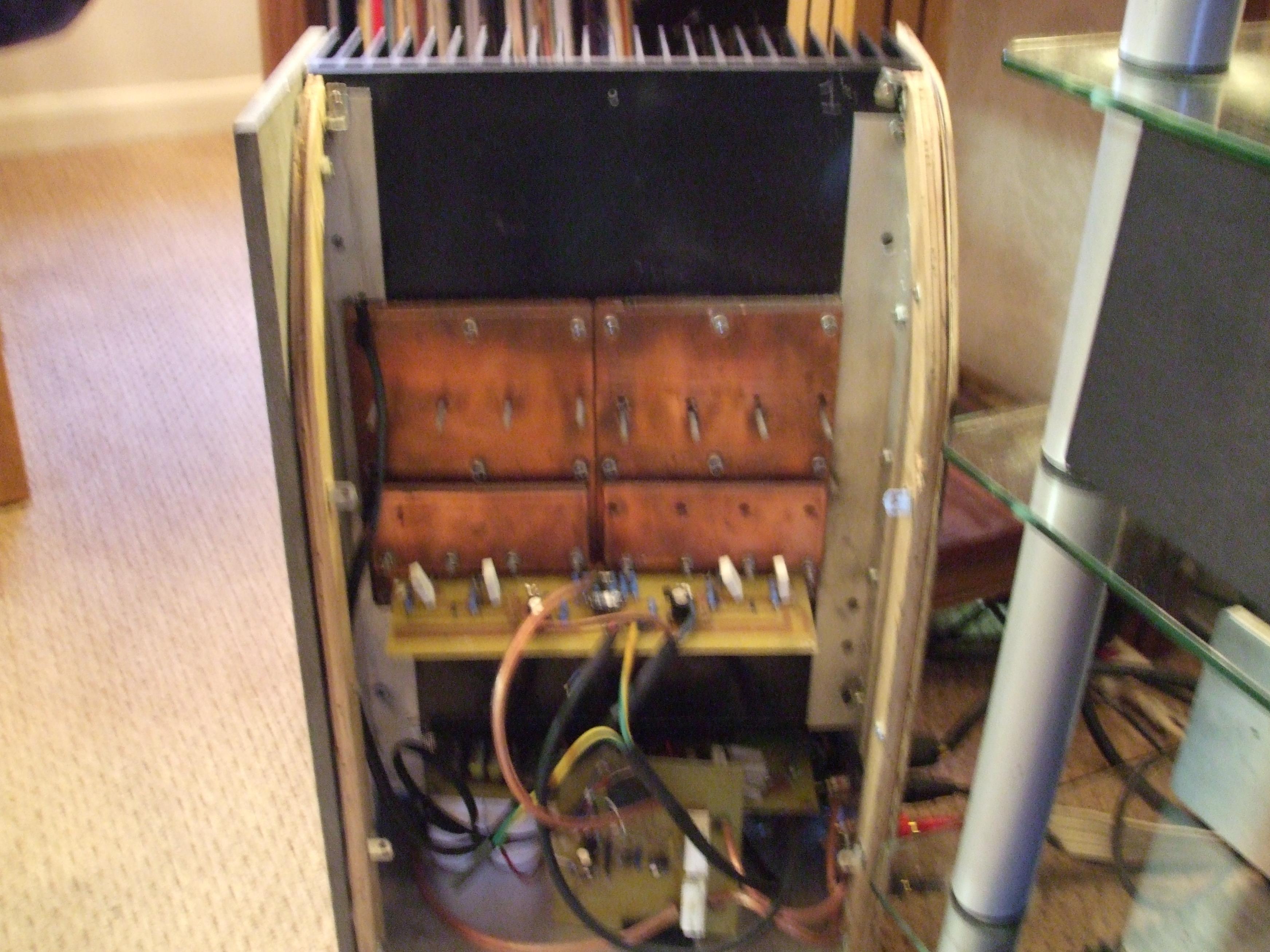

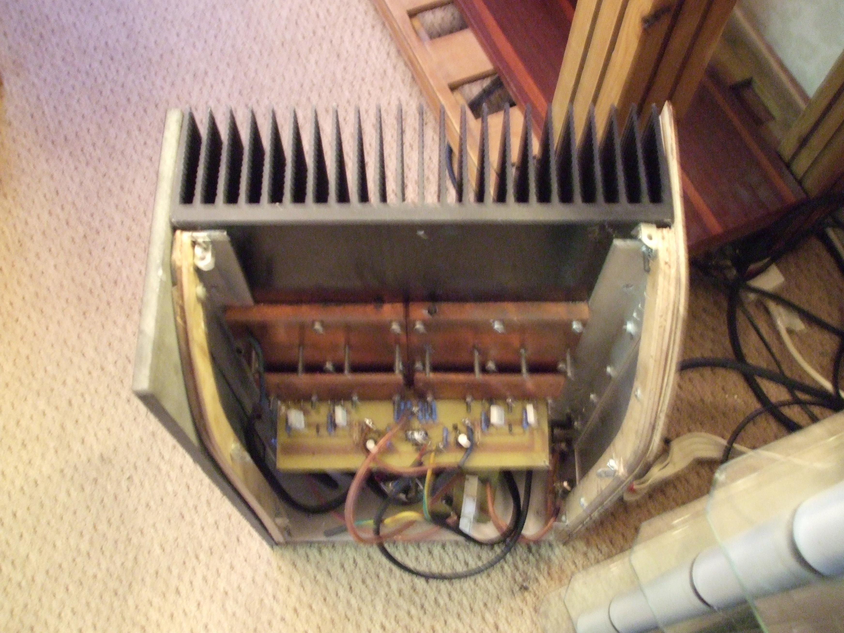

It is all in the build
twin+ cascode+duble jefets+34V rails+40X 10mU cap
But maybe this is one of the post that do qualify to be banished.
Sill case is prety cold as it has no inside realy I got same mesh that I was going to fit but never got around to it
