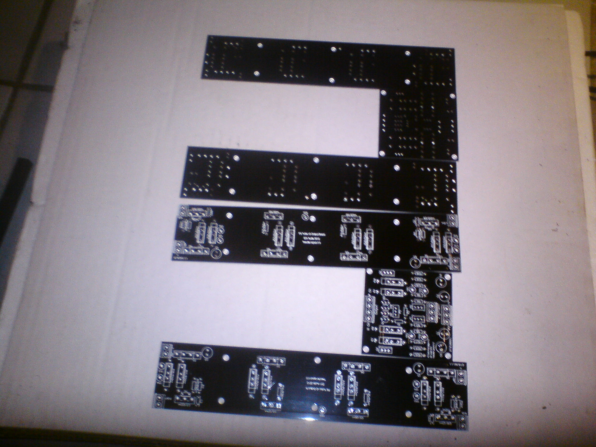

UKToecutter and I have discussed how great it would be to have optimum spacing for MOSFETS and also work with the "diyAudio Standard" or "UMS" as well as be as versatile as possible for the various F-5 Turbos. For a board design to be carried in the store, it must fit the Standard, but I'm willing to add another 4 holes to the Standard for big chassis only. After all, they are bigger!
I've come up with an approach I think will work, for Mr Toe and the rest of you to comment on, and it only requires a couple more holes in the "Standard" I'm drawing up a diagram and will post it tonight probably.
Bear, I created the 80mm spacing layout some time ago to try and match the UMS. It doesn't match the UMS actually anyway but I had it on my PC already so I tweaked it a bit with your suggestions.

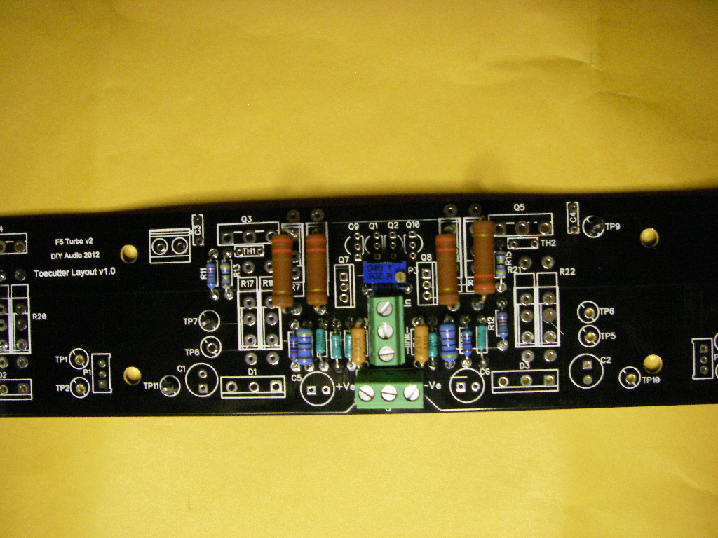

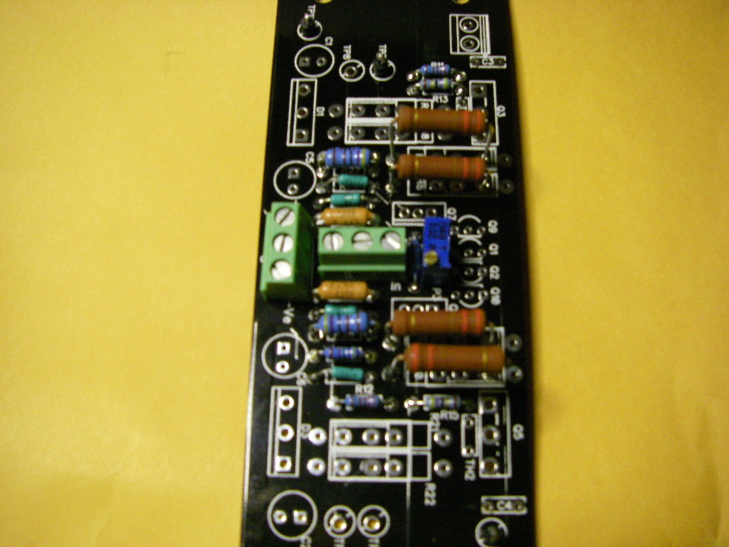

Stuffed resistors on one board
First off the board quality is good.
First and second photos are stuffed not soldered. Third and forth photos are soldered.
First thing, R3 and R4 we changed from 1/4 watt to 2 watt and the larger leads don't fit in the holes, 1/4 watters do. I drilled them and all is good.
Second thing the middle input terminal block can't be used, the resistors are in the way of the openings for the wires. Have to solder directly instead of the block.
As Bear had pointed out it is very congested in the middle of the board, but certainly workable except for the terminal block location.

just drop the block for input. you are better of soldering it anyway
I didn't solder that in, so yea.

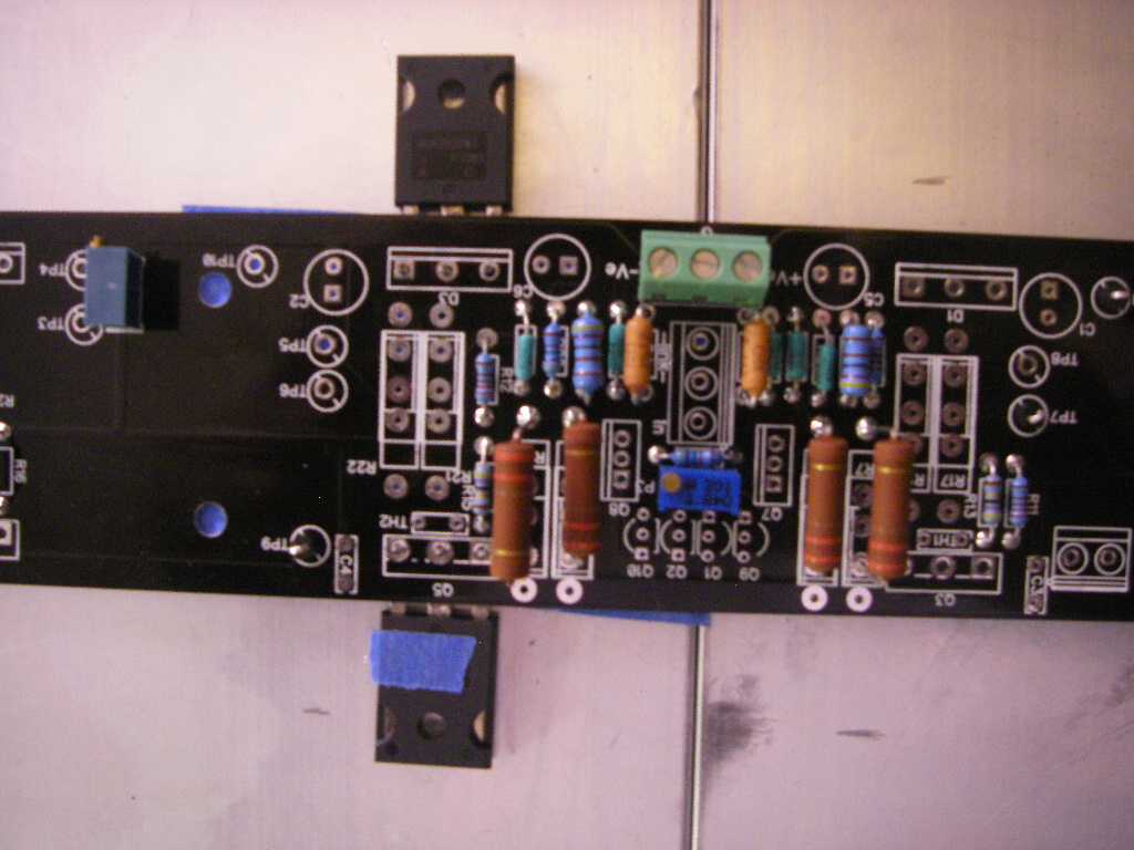

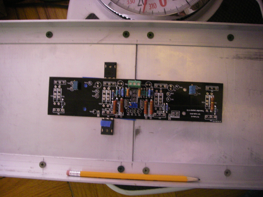

You have ignored the diode location for the Turbo, stilled drilled and tab a slew of holes that has to increase cost of the heatsink.
I am starting to think a couple of copper spreader bars with standard 1/4" mounting holes on the heatsink is going to be better (not cheaper) in the long run. It is relatively easy to drill and tap a 1/4" or 3/8" thick piece of metal, without any blind holes. Us Turbo guys still have to drill and tap the diode locations (same number of diode holes as mosfet holes.) If the chassis company could give a price for including spreader bars, it may be a good alternative.
Still need a standard for the spreader bars, but I am sure someone can figure that out.

I bent the legs of a diode and a Mosfet (marked with blue tape) and taped them in place to look at position on the heatsink. I am using 4 USAHeatsinks, 10.08" profile, 8" tall. I have bolted two 1" angles to the top and bottom to secure the heatsinks together (this was a pain). I only have 5 3/4" between the angles, so to keep the Mosfets at the 1/3 up from bottom I needed to turn the board so the diodes are up and place the screw hole for the mosfet at 2.625" above the bottom (see photos). Also means I need to solder P1 & P2 so that the screw is pointed up towards the diode side.

My experience has been that the cost of having a shop drill/tap blind holes into heatsinks is mostly driven by the setup costs. Adding a few more holes is not a very significant expense (at least at the shop I used).
