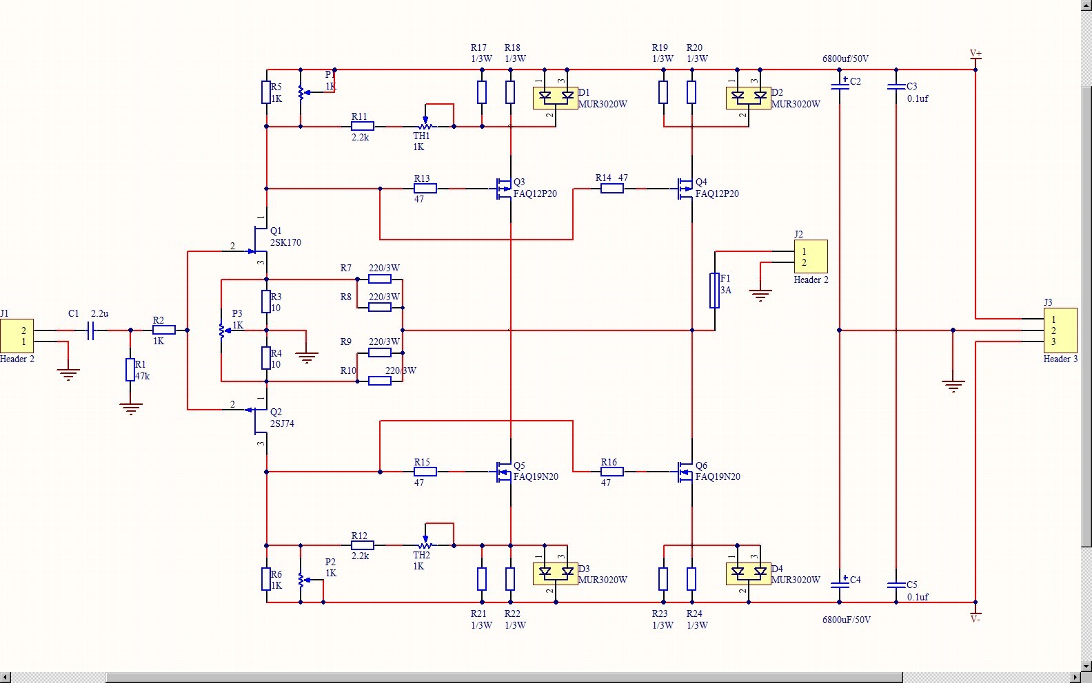

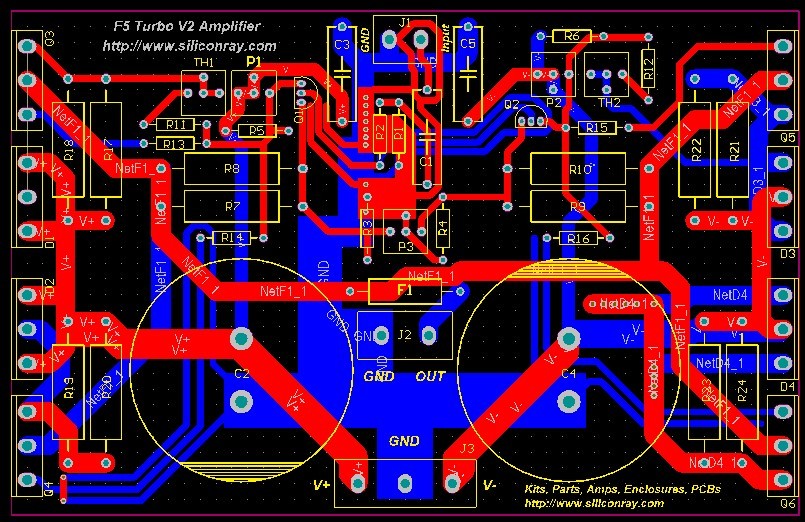

Finished the F5 Turbo V2 design, schematic and PCB posted. Could you help me to check whether there're mistakes? thanks
Planning to make in Black, 2oz gold pasted copper.

a single pair will give a maximum ClassA output power of P(ClA) = [2*0.8]^2 * 8ohms / 2 = 10W into 8r0.
If you fit a 2pr output stage the maximum ClassA output Power increases to 4times (P*2^2) the single pair. i.e. 40W
a 3pair stage will give 90W (*3^2)
This latter 3pr will require an output voltage of 0.8* 2 *3pr * 8ohms = 38.4Vpk
This will require operating supply rails of ~ +-42Vdc
Substitute 1pr or 2pr or 4pr into that formula to find Vpk for the alternative output arrangements.
sorry. i ment +/-42V it was a typo :)

Risking condemnation and being tarr'd and feathered, run out of town.
On the V3 type output boards, why are the power resistors "buried" inline with the mosfets? It seems to me that they should be slid out from that line, both for heat reasons and for heat reasons. Both of those reasons, and also by doing so larger resistors can be accommodated than the minimum size. Those resistors that use the flatpak plastic case (Vishay/Caddock) also require heatsinking, I'd have left ample space for that possibility, and used the maximum width of the board possible for larger format resistors.
On the V2 combo board, neat layout to the eye is nice, but as I was trying to convey early on, good looking and good performing are not always the same. Asymmetry is not something that needs to be avoided all the time. Here too, I have concerns about the resistor placement and layout for the larger ones. Also the pad size as I mentioned early on. Better to push the limits in size.
On both the V3 output board and the V2 board there is much dead space. PCB mfrs charge by the the area, not the layout... so I'd try to spread out the component layout, both from a heat point of view (these are GOING to run HOT) and the ease of service and construction point of view. On the V2 board I see some small resistors sandwiched tightly because the position of a header, C3 means that R11 is right there... sure, it will fit, but why so tight? (just one obvious easy to see example...)
The TPs position assumes that the final installation will provide easy access to the TPs from the "top" of the board. Not a good assumption. Probably they will not be accessible at all from the top, rather one will have to fish in from the top of the amp, which works out to be the side of the board. So, having them inline makes it easy to short them out with a meter probe. I'd have set them at what would be 45 degree angles looking down on the board, and added space from the Pots - the pots could be top or side adjust, which makes it easy enough for the screwdriver to slip off if side adjust again shorting the TPs (unless the TPs are socket type in which case you can't get to them from the side, so assume uninsulated pins) - the step spacing making it possible to get to the TPs from various angles.
Since these boards are going to be slapped on MAJOR LARGE heatsinks, usually standing vertically from the main chassis, there is not a whole lot of benefit from making the tightest layout using the smallest board possible. In fact there are deficits in terms of layout options and heat build up.
Making the boards have a larger long dimension, as long as it does not effect stability, is a BIG advantage because you need space to permit each mosfet to adequately flow heat to a region of the heatsink.
Folks who are using front to back heatsinks on a deep chassis, and using this sort of board are really only getting part of the heatsink value that they have paid for, because the heat is being generated only in the central portion. Yes the rest of the heatsink helps, especially once it has been cooking for a while, compared to a shorter extrusion, but it is none-the-less not as effective as wider spacing. So what's the loss in adding a few inches in length to this sort of layout if it buys better heat transfer and wider component spacing with fatter traces and bigger pads??
Looking cool and sexy by being compact and packed in, is a false design goal or aesthetic, imo.
One should de-rate ALL the components based on heat rise over 70F (whatever that is in C) ambient temperature. In summer conditions the environment around that board is going to get VERY HOT, reducing the effective wattage of all of the resistors. Me, I want max space and max air flow.
Count on designing from an ambient air temp of >100F (whatever that is in C?), add in the temp rise due to the circuit, and then you'll see why this is important.
Personally, I do not what to listen to a great amp and fans. Not if it is possible to NOT listen to fans. If it is a fan, the slower the fan, the higher the VOLUME and the lower the velocity of air, the better... but would rather not hear or have a fan full time.
If ur building right now - do NOT put ur small resistors flat to the board!! Make sure you put about 1-2mm or ~0.64" or so minimum clearance between the resistors and the board. More is better. Less clearance is worse.
I'd want more spacing resistor to resistor for the "small" wattage ones, again for heat purposes. If I had to build on these boards, I'd end up putting every other resistor high (a full extra resistor body diameter) off the board on it's leads to permit adequate air flow, not in-line at the same height. High - low - high - low - high - low ...etc.
My only other thought at the moment is "black"?? What sort of material is it? Black is usually a carbon based pigment which is not a particularly good insulator, albeit probably up in the MOhms, but still of some concern... also black will absorb heat from outside sources better... and there is heat to be absorbed being next to the heatsinks...
All of this may be nit picking, but maybe not given the heat that this amp will put out. Optimizing for heat may be important.
