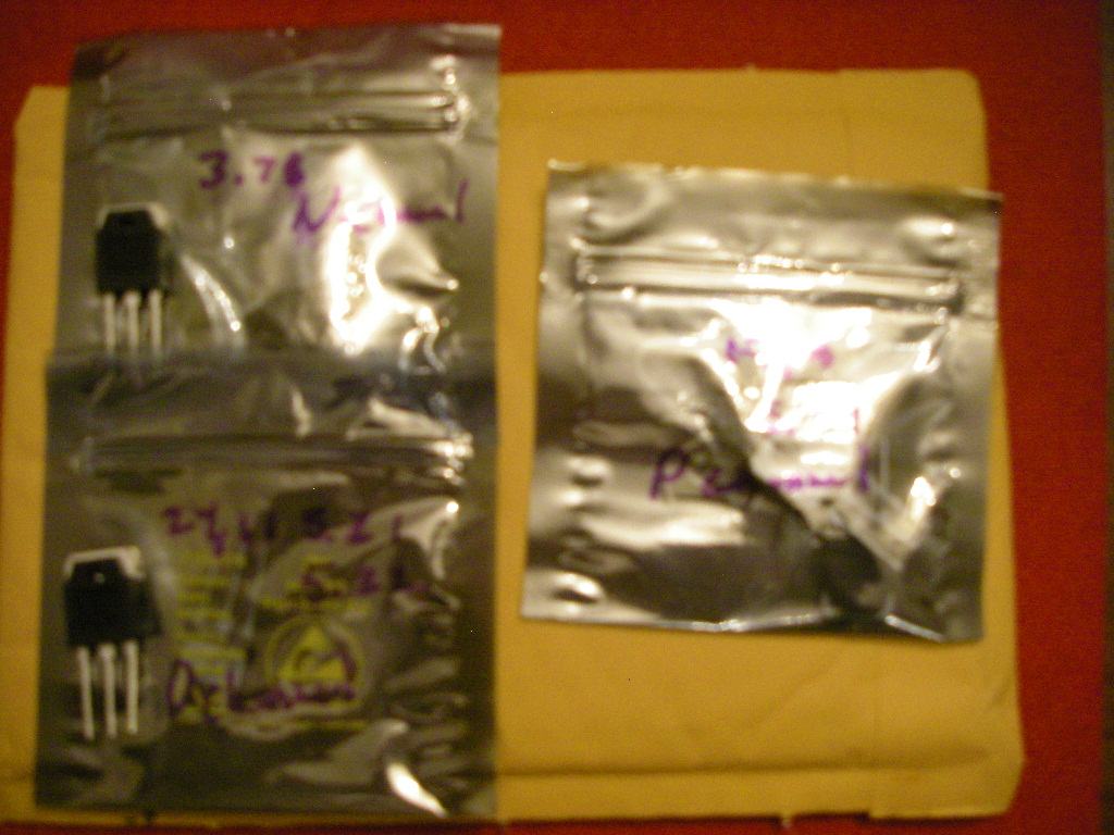

Fairchild 19N20 and 12P20
Teabag is true to his word!
When I got home today from a week of traveling, I have 4 pairs of Fairchild 19N20 (4 matched) and 12P20 (2 and 2 matched) outputs.
I will be glad to test the board.
UKToecutter, I will PM you to give you my address.
Can't wait!
Rush
Can't wait!
Rush
