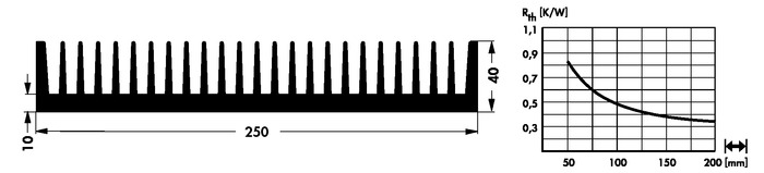

at 220W the 500mm just get up to about 15-17C above ambient.
The 5U-500 case is not a 5U-400.
17C divided by 220W is 0.077 C/W
4 times 0.40C/W for the heatsinks, 0.40C/W added for the rest of the chassis, makes 0.08C/W for the entire case.
The front panel of the case (450 wide x 210 high x 10mm thick) will handle quite a portion of the dissipation, so i'll buy the 17C number.
Fischer SK524 =>

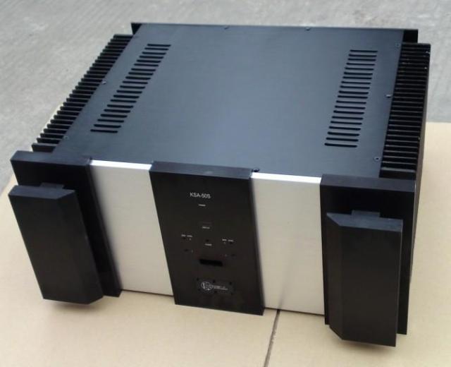

If want to make your amp looks like a monster cost $5000 you may need this enclosure. size 480x230x440
Personally I don't like it's apperence although it's extremely well built. But we just manufacture per the customer's design. This modle is also allowed to be supplied to DIYers now.
