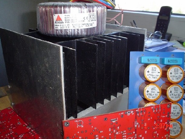

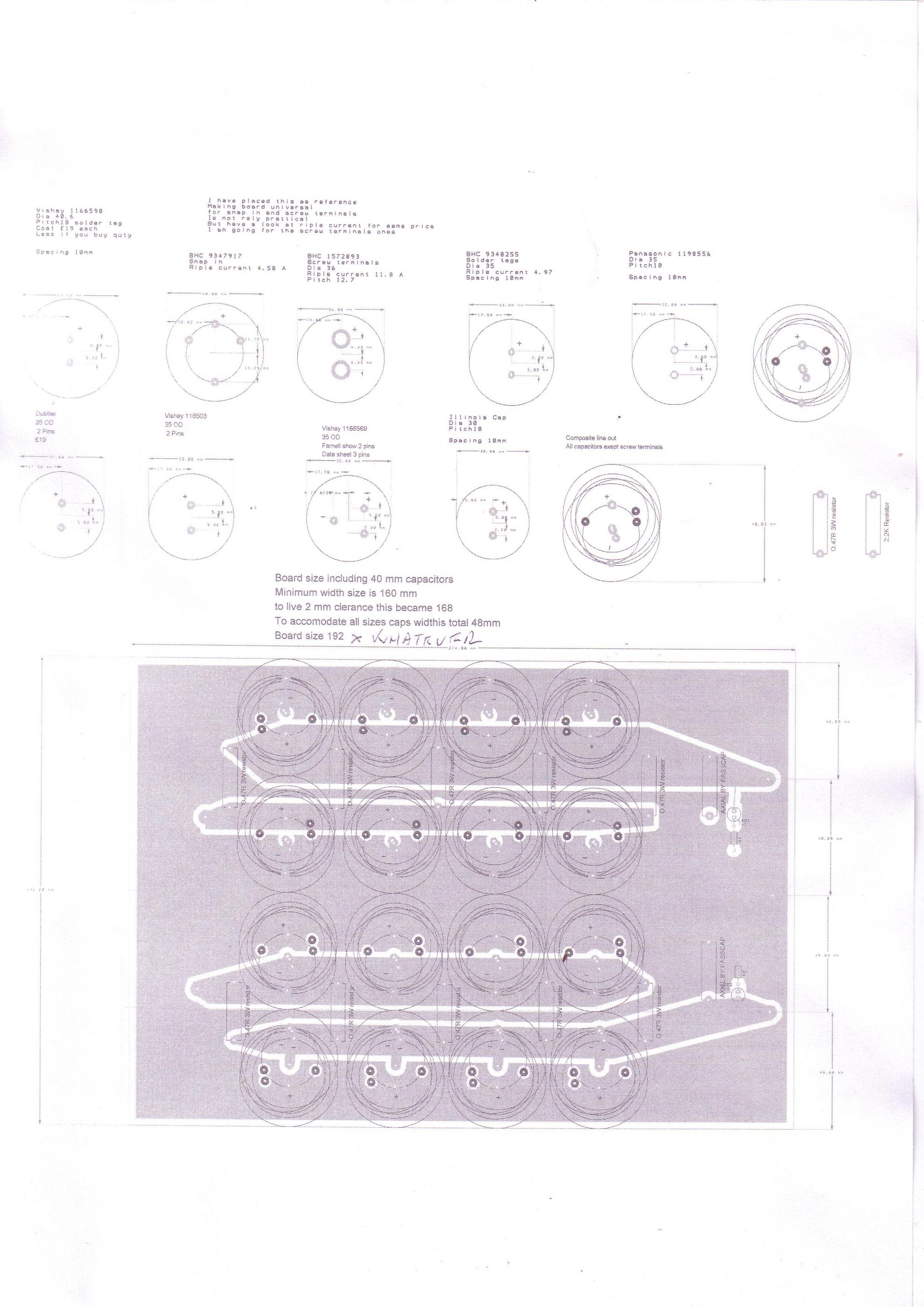

Universall snap in capacitor
fit all sizes from 40 to 30 and different pins that I know off
if one is missing give me lay out and I will put pad there (takes a couple of minutes so no prob
+ leds so if you can see troug case ...
Look at lay out for type and dimentions if you look at screw therminall they all came in 13.5 mm pitch so much beter different board
And at 2 times the rated riple current for same price of snap in cunterpart is no contest
I have made this as there is a common + pad for all sizes board is phisicaly larger this way but works much beter
What one spend on board size is saved with reduced holes numbers

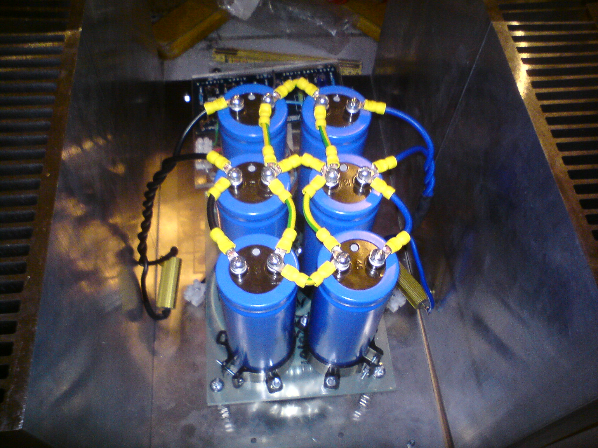

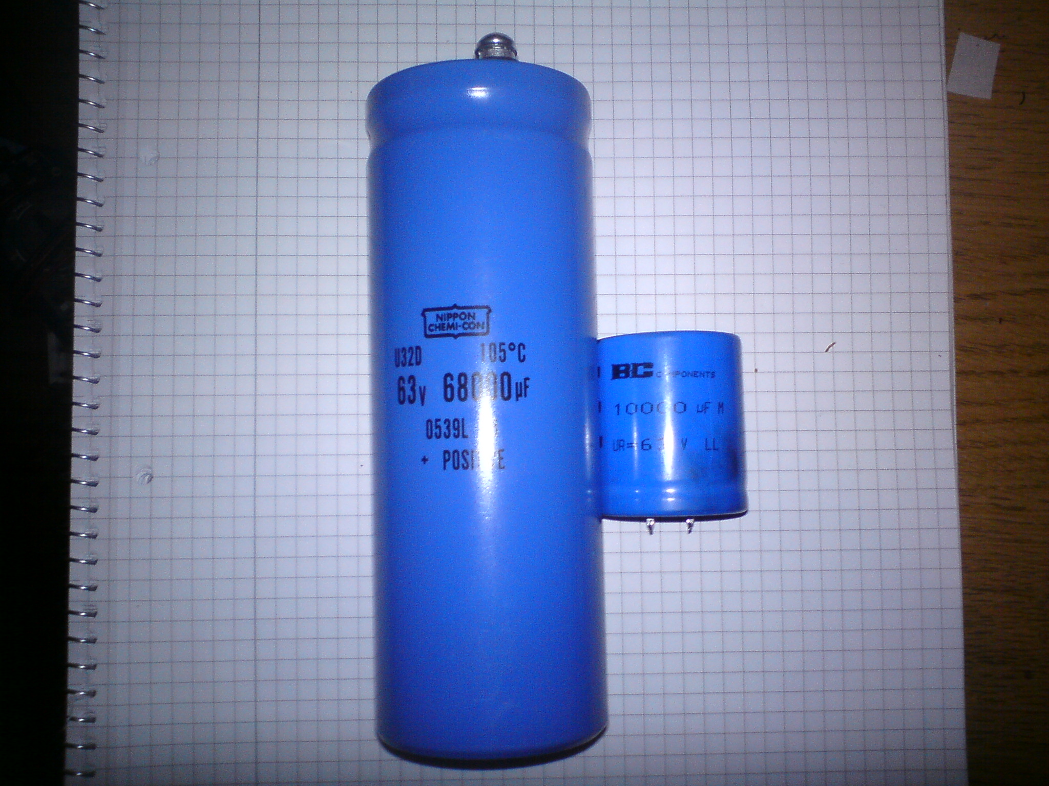

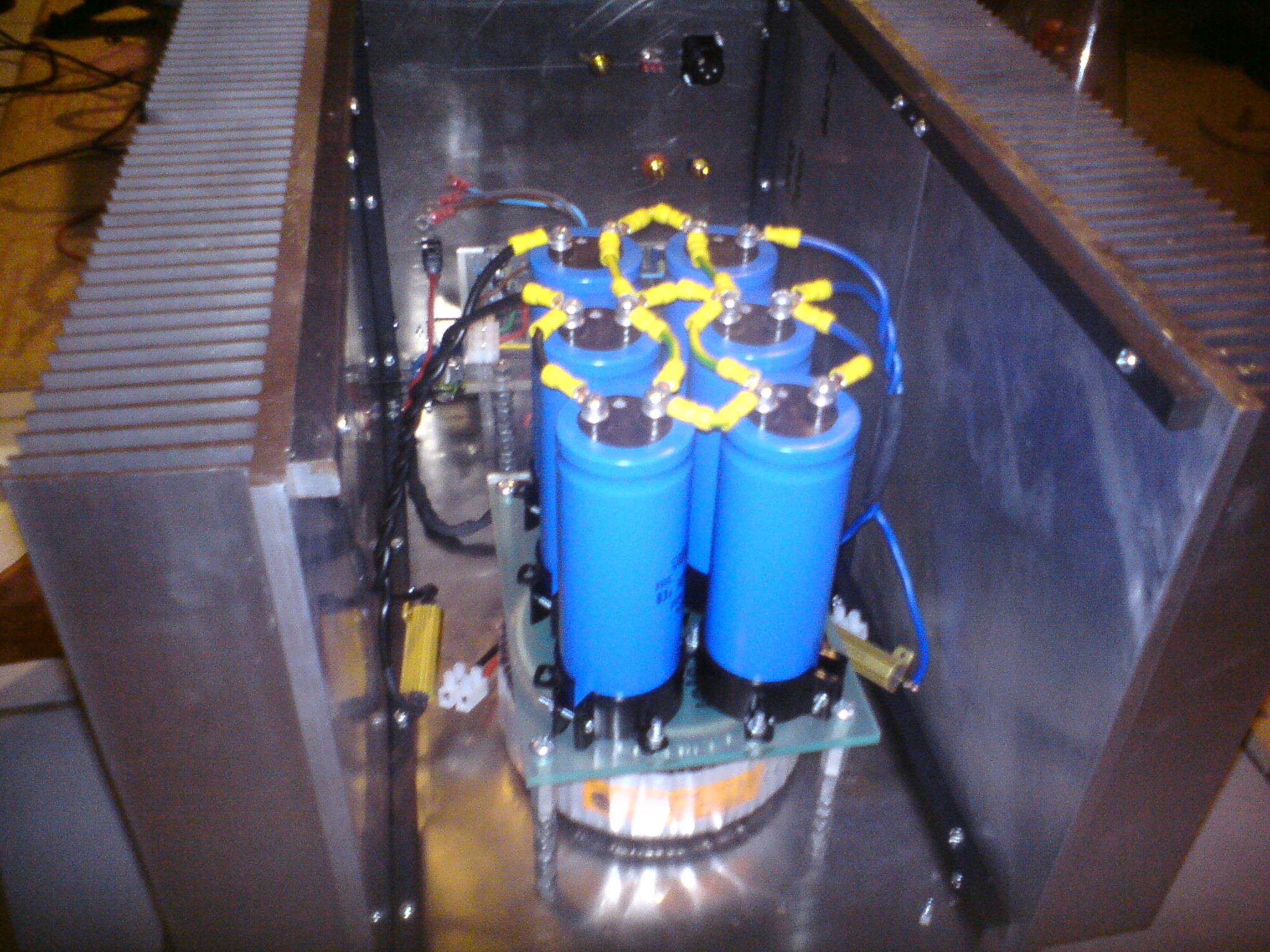

since we're talking caps, I 've been trying to understand the reason for going with screw in instead of snap in capacitors. The srew tipe are larger, more expensive, and seem to need extra mounting hardware. I can understand that these have in general better ripple current and esr ratings, but what measurable/audible differences can one expect from using them in a class A amp such as the F5T, if same capacitance is used. Screw in caps are at least double the price of similar snap in units from what I've gathered.

if you look at part numbers and search Farnells prices for snap in are similar to screw terminals
ESR and most of all riple current make a fair bit of difference listening
then came in play construction methodes but I do not realy want to get in to reccomending Slit foils at £20 a pop
