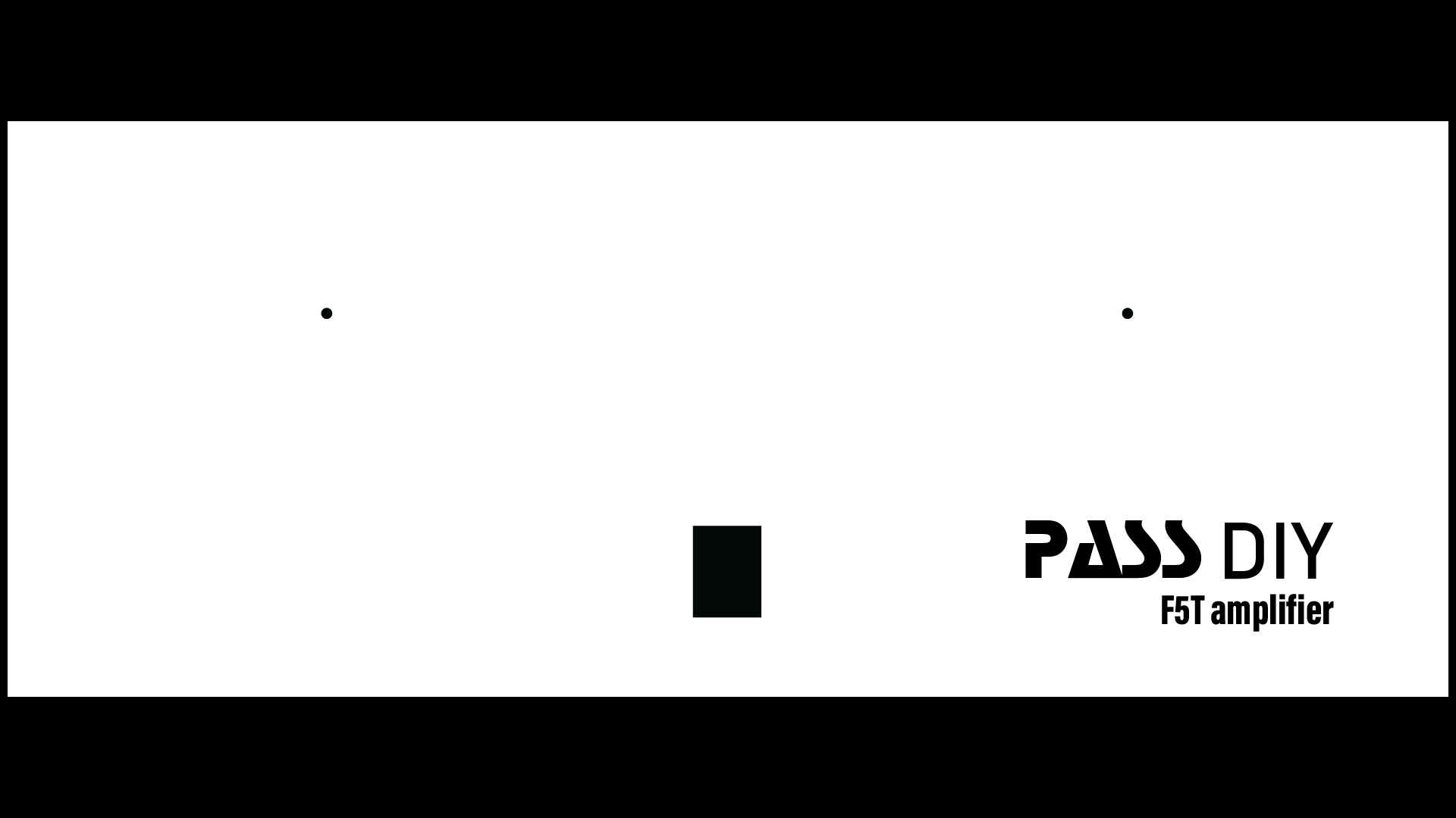

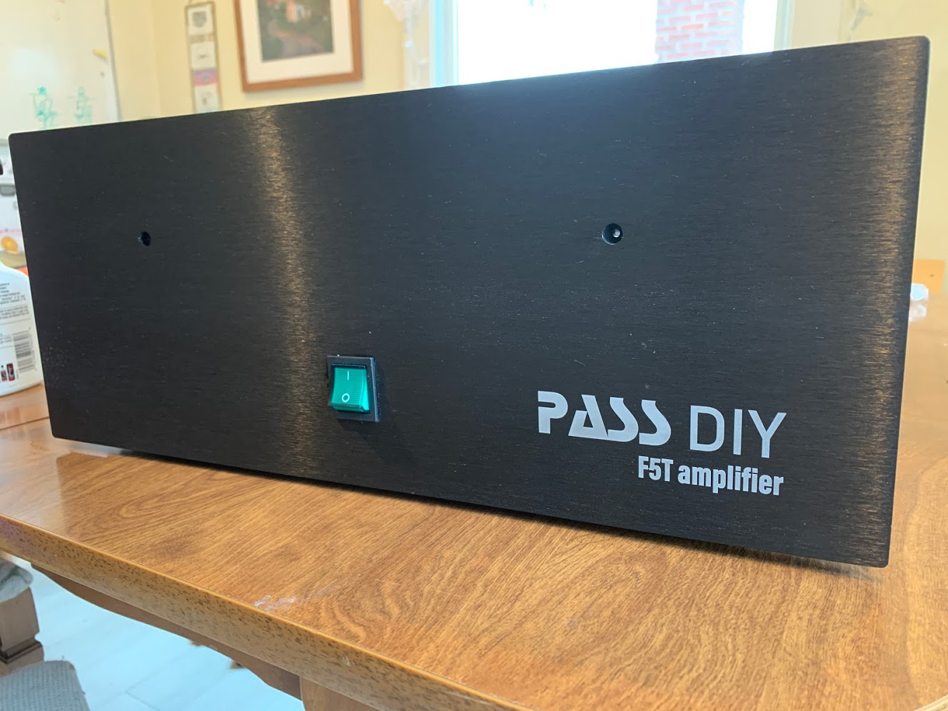

front panel "art"
barely art. But I slapped together a vector art thing that I used for the front panel. I'll see if I can attach files here.
The "stop font" STOP.tff is included here as well. Not sure if that's a copy right thing, I'm 100% sure I didn't pay for it, and I didn't get too crazy with acquiring it either, so I think it'll be okay.
It didn't take the tff files, but they're in the ZIP, so that should be fine. Adobe Illustrator is what I used.
Hope this makes shortcuts for someone!
Very nice, Drew! Lining up with a capital Y is so awkward, but this looks good. I'm not sure exactly how I'm going to finish my front panel yet. I got silver to have the options of the pretapped mounting holes, but I'm considering buying some self-etching primer and maybe a nice matte black to match the rest of the chassis. I might print some letters out on my wife's Cricut to make a positive stencil, not sure. I think the slightly raised silver letters on the black panel would look really nice if I did it right, but when it comes to me and painting that's a pretty big if haha.
If you are going to go to the trouble of painting the front panel I suggest you use an automotive rattle can spray paint rather than a Rustoleum or Krylon rattle can. I have found that the automotive paint will give you a much harder and more durable finish. It costs a bit more but is worth it IME.
Self etch primer is a good starting point and I have used it a lot on larger projects, but have been disappointed in the durability of non automotive finishes.
I’m not sure. Perhaps you could try a small test area on a scrap piece.
Totally, thanks! I don't have any scrap aluminum to test on, but I could test on the back side. To be honest I'll probably just send it.

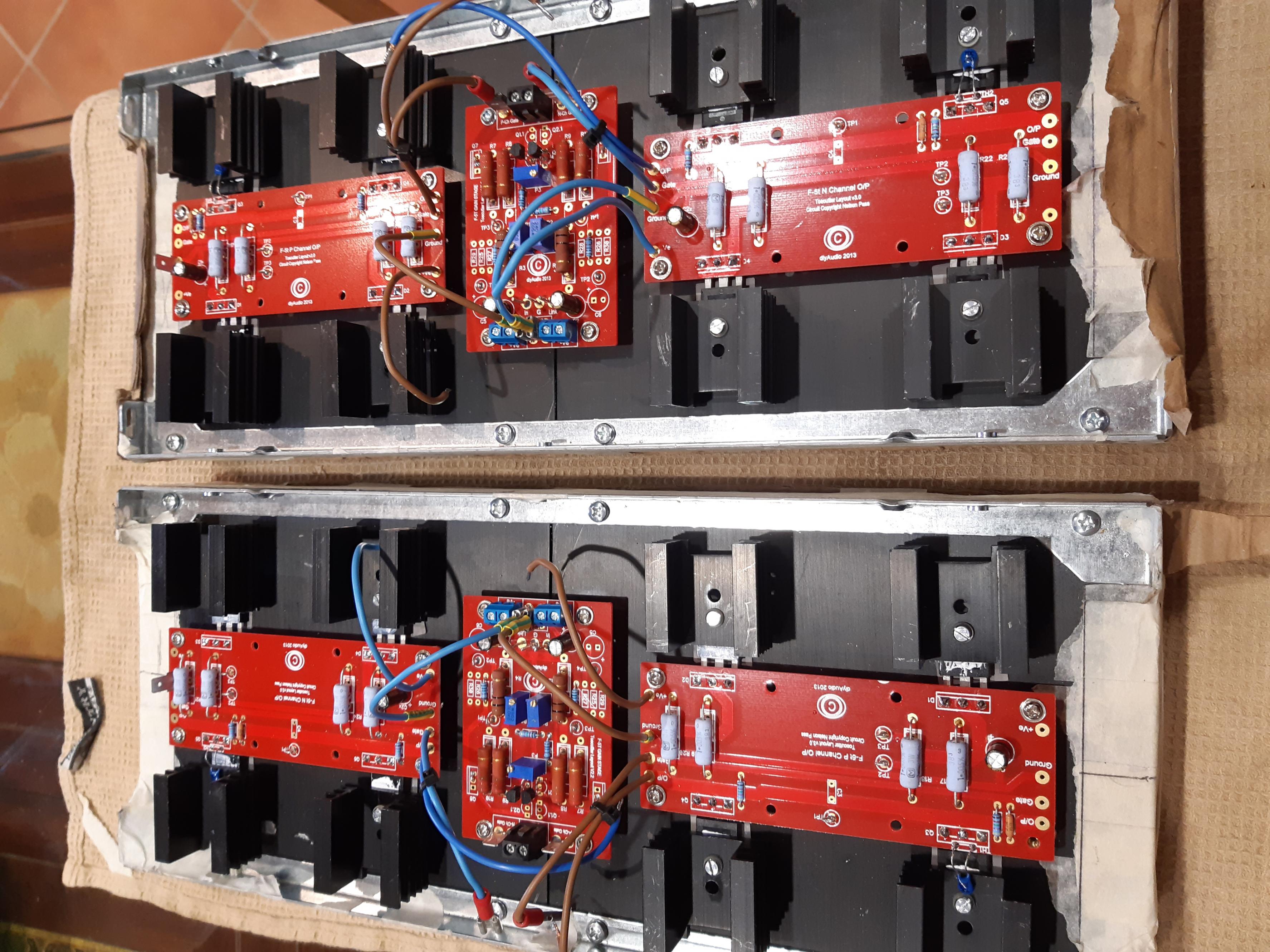

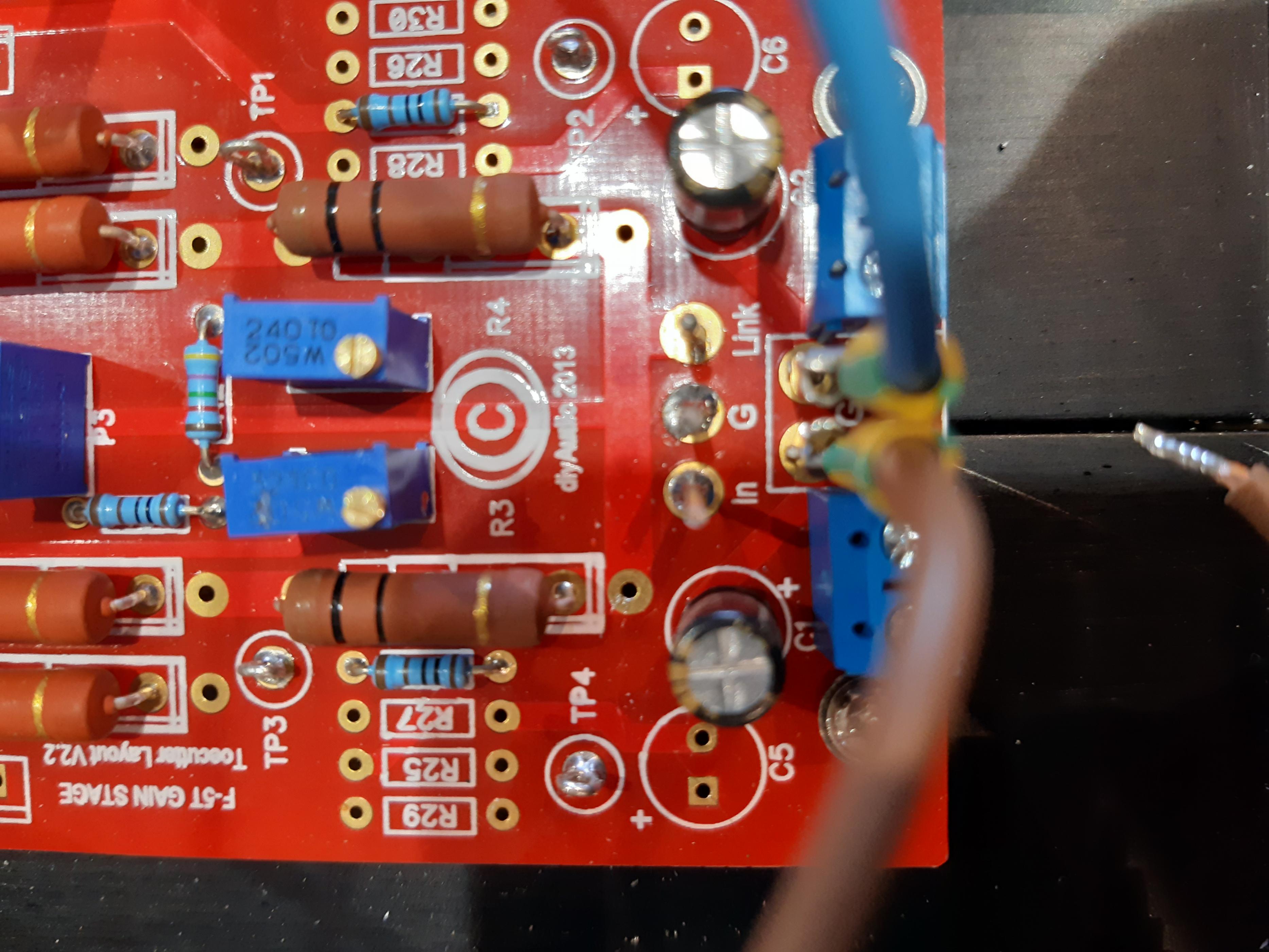

Good Morning.
I add front heatsink....Is it to much?
Which is the correct bias value? 350mV is it correct?
On contact "link" (FE pcb) , I must weld speaker out?
Thank You so much

Link should be jumpered to ground. Output is from OP, there are three pads, one for speaker, one for N & P channel.
Front heat sinks OK, move thermistor to the plastic of MOSFET to prevent short circuit.
Look for bias procedure in beginning of thread.

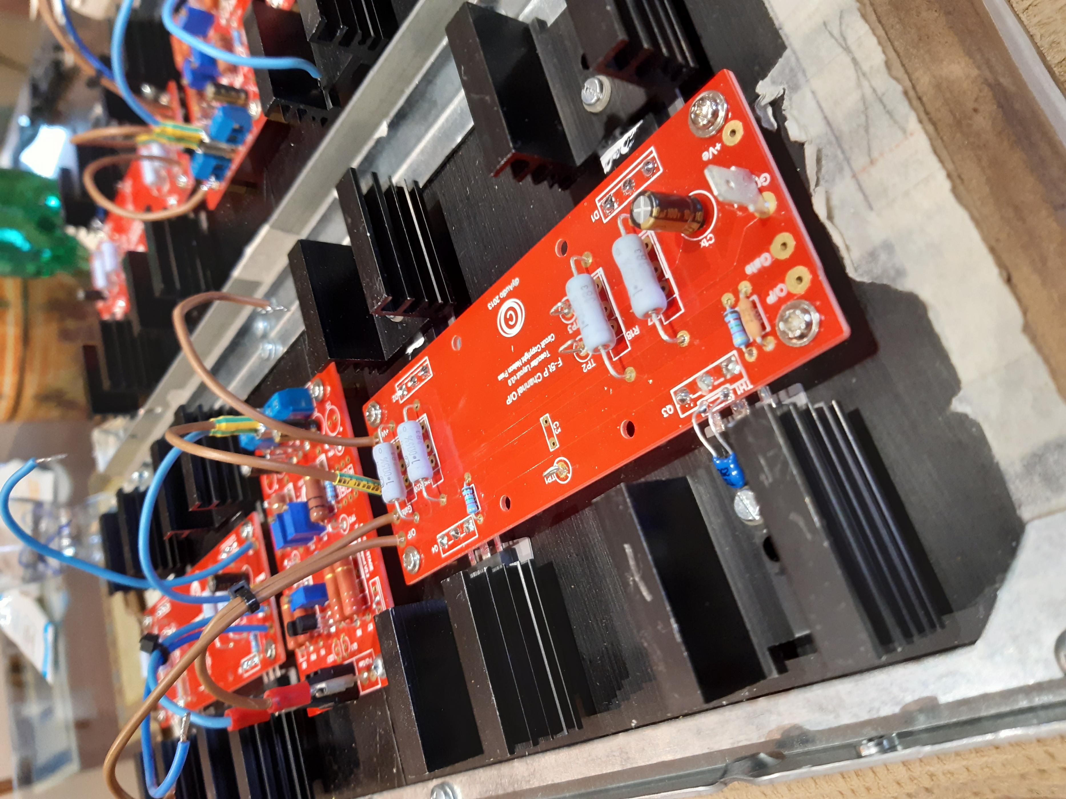

ready for first power up
Just wondering if anyone can look my build over, and give me recommendations, also if you see anything incorrect.
I am looking for recommendations on mounting the LEDs so they shine nicely through the physical hole drilled out in the 10mm aluminum front bezel.
I pulled all the washers off the FETs, pretty sure they're not really needed, and in some cases, get in the way of the thermistors.

recommendations on mounting the LEDs so they shine nicely through the physical hole (...)
This depends a bit on what you mean with „shine nicely“.
- if you want them to gently glow and be visible from more or less every view angle, you should use a kind of a lens of sorts (think light-conductive rod of plexiglass), and use it to adjust the lights jut (position) on the front plate +- 0.5 mm ...
- use something like that, tweak for positioning: https://www.mouser.ch/Optoelectronics/LED-Indication/LED-Lenses/_/N-b1d1r?P=1z0wugs

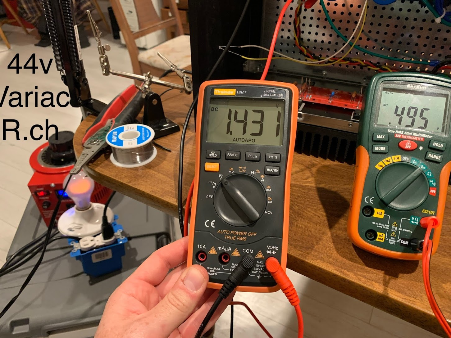

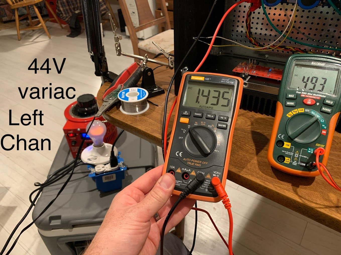

first power up: voltage across speaker outs, bulb on
Just wanted to check if this was normal. I think I'm supposed to be getting about nothing (in the mV range) over the speaker outputs +/- ??
As I dialed up the variac, to 44V, one channel at a time. On both channels (seperatley) I was getting a half volt on the output,
R-channel
44V variac, 1.431VDC on PSU out, 0.495V across speaker out +/-, bulb glowing
L-channel
44V variac, 1.435VDC on PSU out, 0.493V across speaker out +/-, bulb glowing
Input RCAs are not shorted. Nothing is hooked up to speaker terminals, except the multi-meter. I dialed P1 and P2 as close to zero as they'd go, which was around 1.1ohm (across TP1-2 and TP3-4 on FE board).
Do I have a short? Am I measuring something incorrectly? I'm glad the boards had the same numbers - I wired them the same, even if incorrect somewhere.
In 6L6 procedure, he mentions "Place voltmeters across TP of output board, one on N-channel, one on P channel." What exactly is the TP of output put board? There's a TP1, 2, and 3.

I have no specific part numbers to give you. You really just need to verify the same pin out and that the part substituted has at least the same voltage and current ratings.
If you are having trouble getting the required discrete diodes then you can go to a simple off board 35 amp bridge rectifier, which should be obtainable just about anywhere. I used those in my F5V3 monoblocks and they work just fine.
