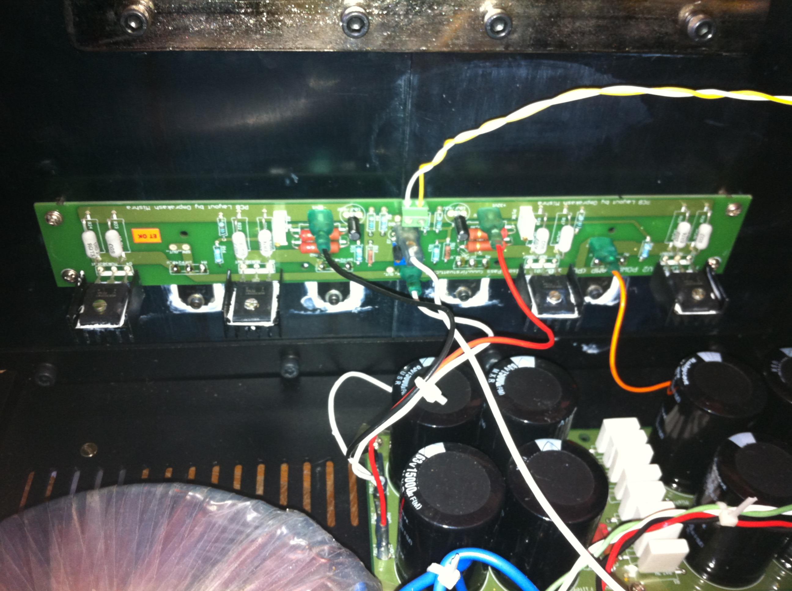

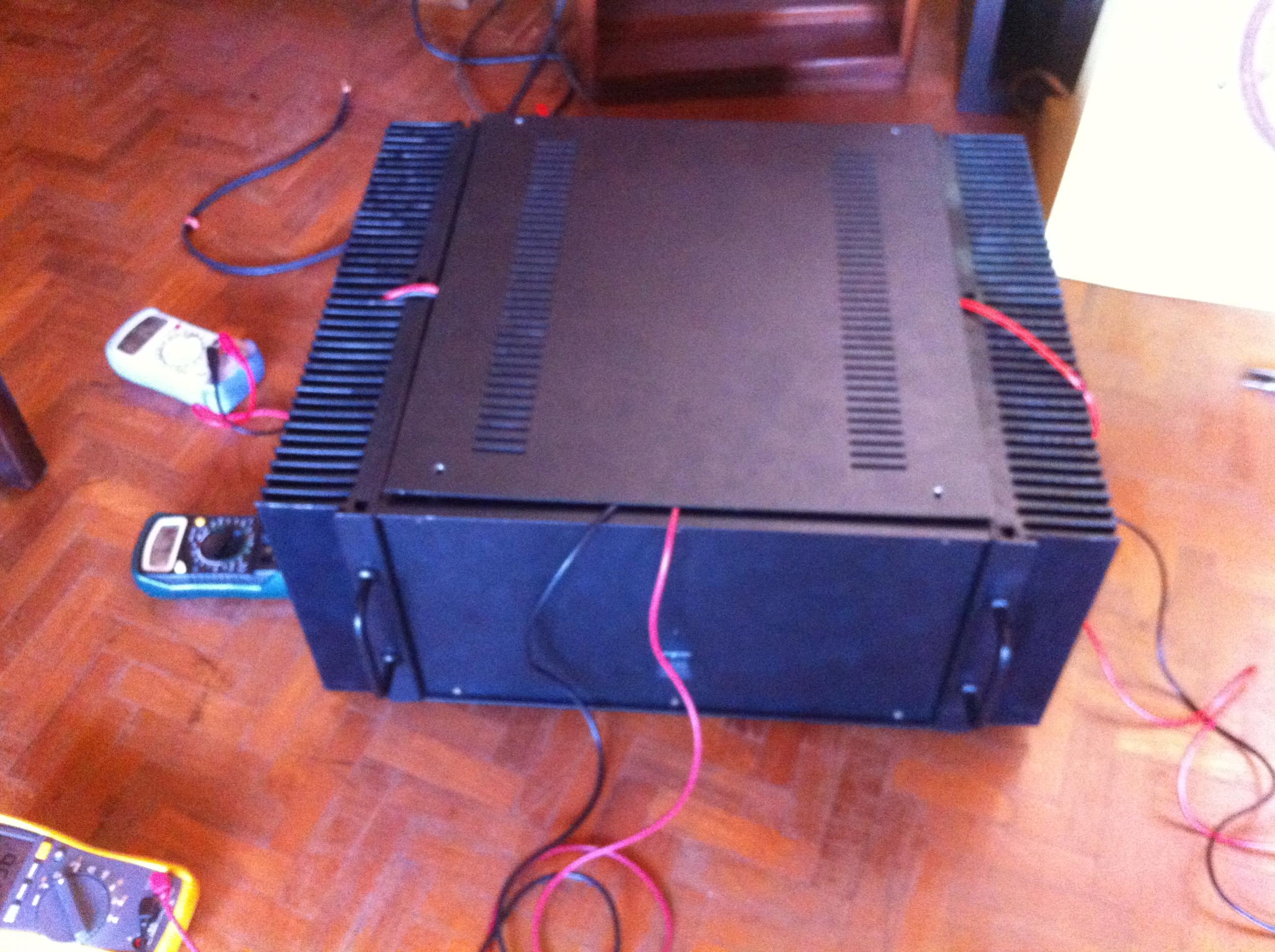

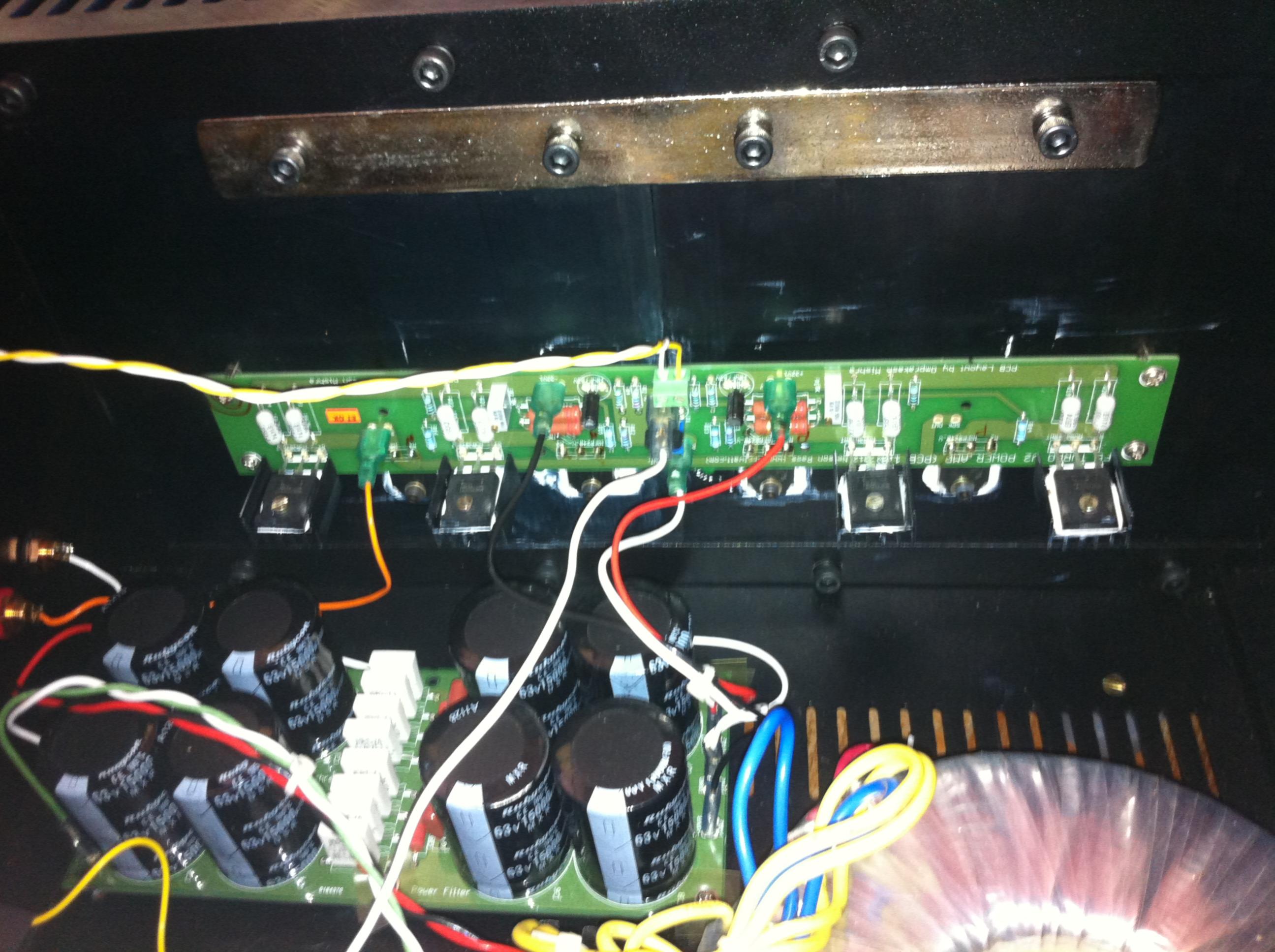

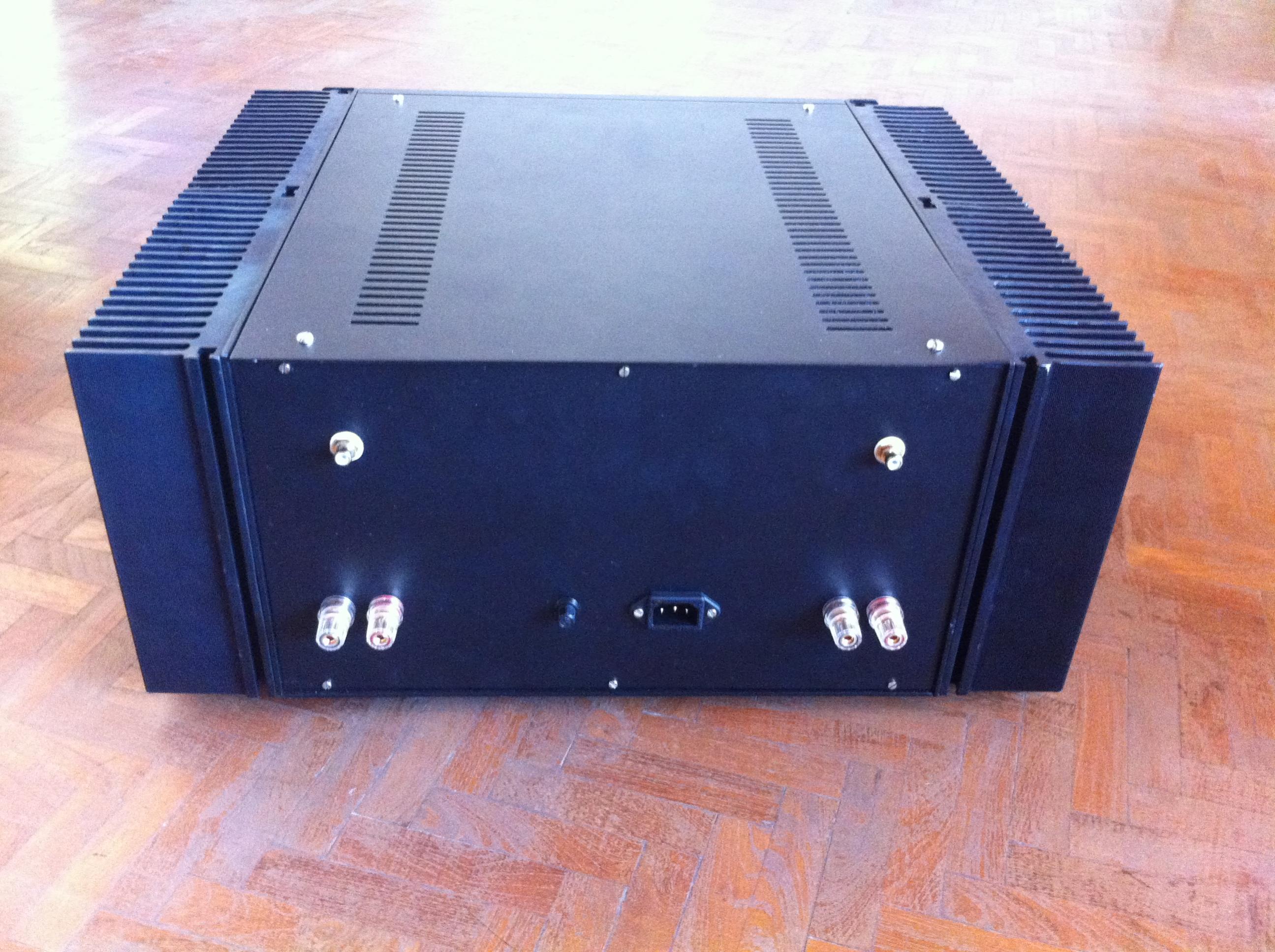

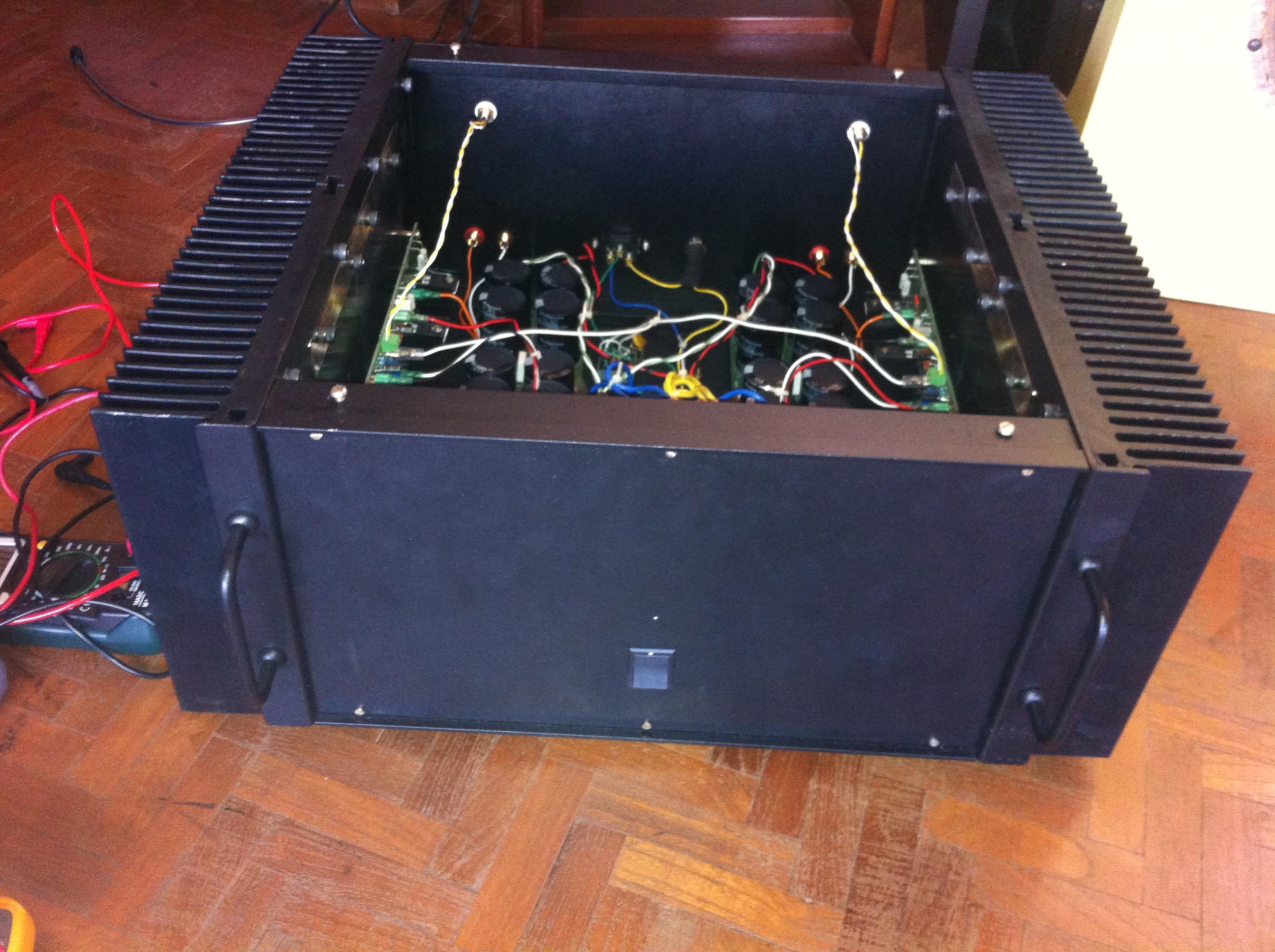

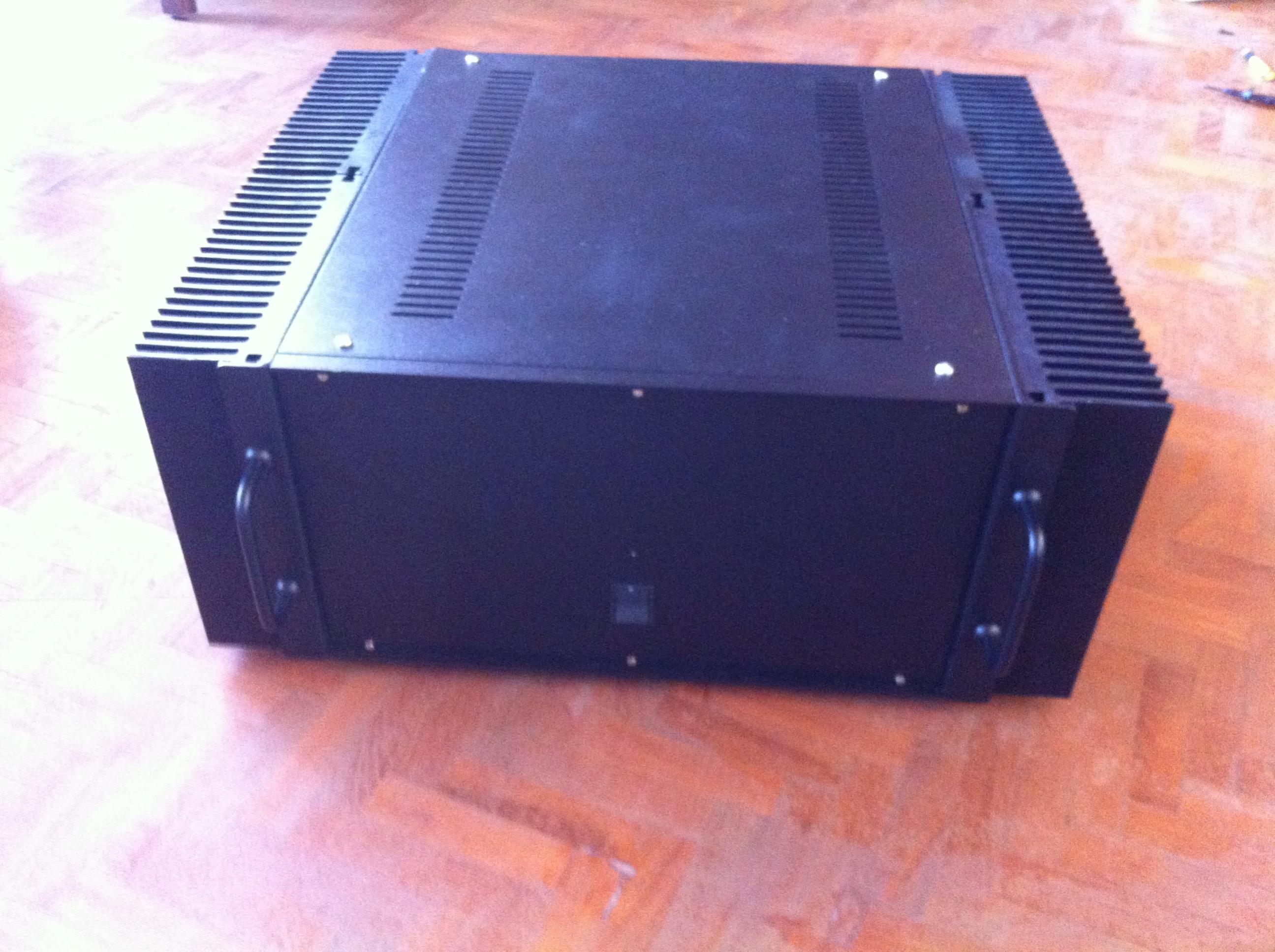

Pictures of completed F5 Turbo V2
As mentioned in an earlier post, completed the build including setting up the biases, monitoring heat and stability etc.
Also did few hours of sound testing with my Fostex back loaded horns, which are currently used with a standard F5.
As far as impressions of the sound are concerned, the amp is simply outstanding. It has F5 like detail and clarity and has very strong dynamics and a solid bass support. Each and every instrument can be felt and heard. The amp does not attract attention and one instantly starts enjoying the music rather than hearing the amp. There is no fatigue. The difference between a regular F5 and F5 Turbo V2 as far as my build comparison is concerned, is that the Turbo is bit more warmer and more in control. It has stronger dynamics and support for stronger bass. These needs to be taken as a relative comparison and in no way a comment on standard F5's sound. While the sound signatures are almost similar, I should be able to tell a Turbo in a blind test due to stronger dynamics and bass.
Definitely a keep in my collection. Have a minor non-instrusive hum problem to be resolved in terms of double ground from my preamp. Also have a suspicion that 8 x 10000 uF per power supply rail is not sufficient enough. It probably needs to be 8 x 22000 uF. With higher bias, the capacitors are adding leakage current.
The heatsinks are warm and not hot enough. The Toroid is a 1KVA model. Both these are a overkill for a V2. Will use the trafo for V3 soon and swap it with a 600VA model.
Here are the pictures:
