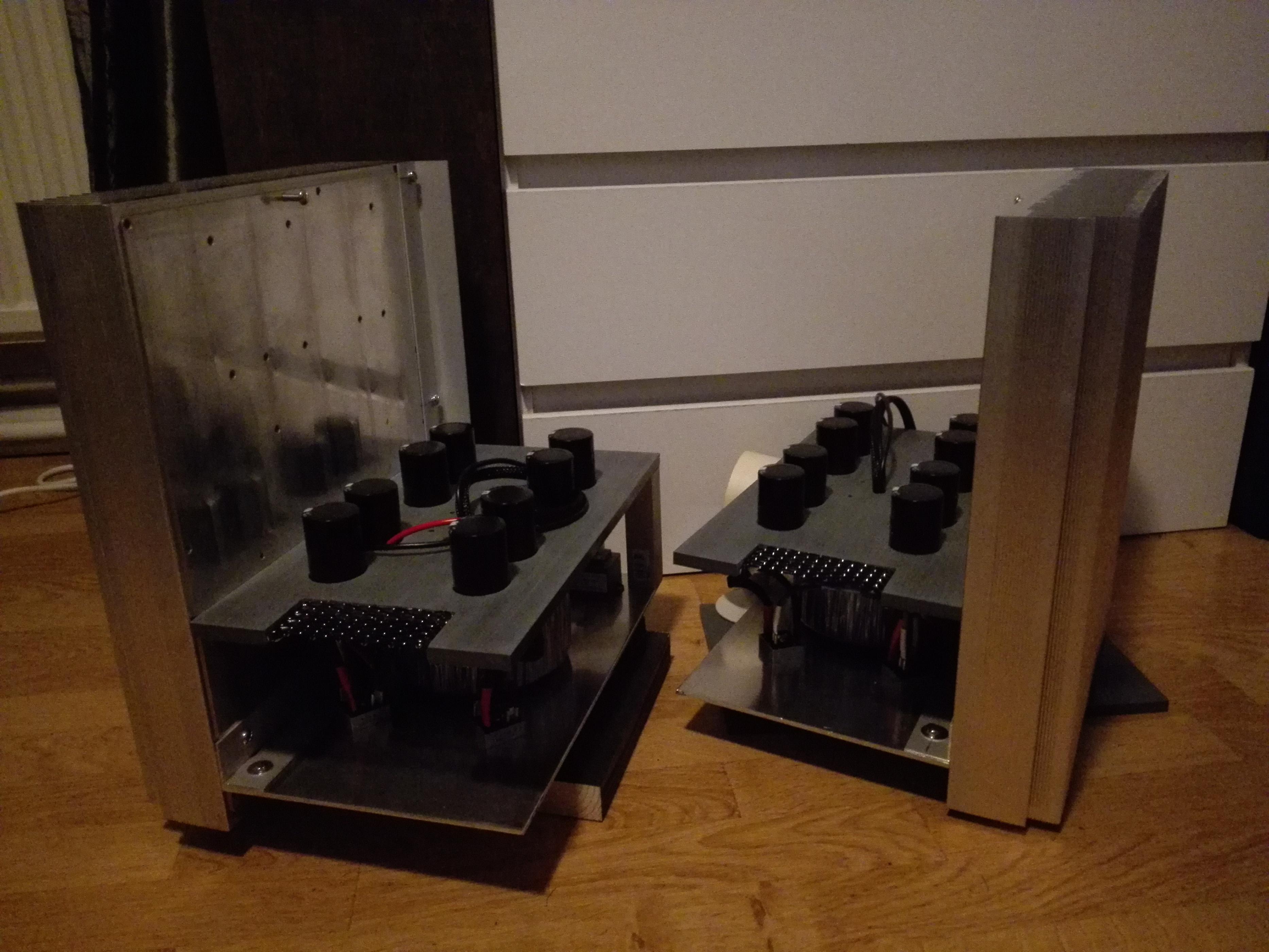

Hi everyone. I am slowly progressing my first amp. This was supposed to be an Aleph 5 clone but I´m thinking to change it as a F5-T (diyaudiostore PCB's). I guess that it would be a better allrounder and I rather not build any boards that have been cloned without permission or so.
I have PSU's ready and measured now (thanks AndrewT). Rails are +/-42.4vdc without load, +/-38vdc under load, 545va per transformer. I don't need very high power amp, I guess that 50w@8ohm is enough, and ability to drive lower impedances also. Don't wanna struggle with temperature and fan will be included. This is going to be monoblock build.
Heatsinks are something like 16" x 14" x 3" (400mm x 350mm x 70mm)
I guess my question is; Is F5-T suitable allrounder for driving loads from 4-8ohm and is my power supply and heatsinks suitable for the job?
Still got some time to think, next up is some cad work and laser cutting parts to chassis, takes some time to get that part ready.
Thanks!

Krell use 2pair of 250W BJT devices for a 50W ClassA amp and 4pair of 250W devices for a 100W ClassA amp.
Those indicate a factor of 20 to be applied. Total Pmax/ClassA power = 20
Take the standard F5 where one pair of 150W FET devices give 25W of ClassA.The factor turns out at 2*150/25 = 12
If we use the factor of 12, then a 75W ClassA amplifier would need 12*75 for Total Pmax
900W 3pair of 150W FET devices meets that requirement. But you could use 4pair if you prefer (this would allow youto run the stage hotter but still maintain an adequate FoS after de-rating for the increased temperature. this in turn allows you to use a slightly lower impedance speaker and stay in ClassA longer.
+-35Vdc in ClassAB hits 50W with the sag at full power.
If you had +-35Vdc after biasing into ClassA you don't have the voltage sag and so you get more ClassA power than does the ClassAB (see my tests of the Krell Klone from ~10years ago).
If you have +-38Vdc when biased into ClassA you will get a lot more. That extra 3V on the supply makes a big difference.
Your transformer is going to give a lot more than 50W into 8ohms so you have to design your build to match the likely output.

Thanks again Andrew! Power won't hurt, but more than that I need ability to drive 4ohm loads. I guess my concern is about heat produced by these monsters, my heatsinks might barely handle F5-T V3 build with fans assisting airflow inside case?
4 ohms and ClassA won't work, unless you run exceptionally hot.
Your heatsink might manage 6ohms ClassA.
But I would suggest you aim for 8ohms ClassA and feel how hot it gets. Then decide if you can increase the bias to allow for 6ohms. Then after finding how that performs make the decision to adjust for 5ohms.

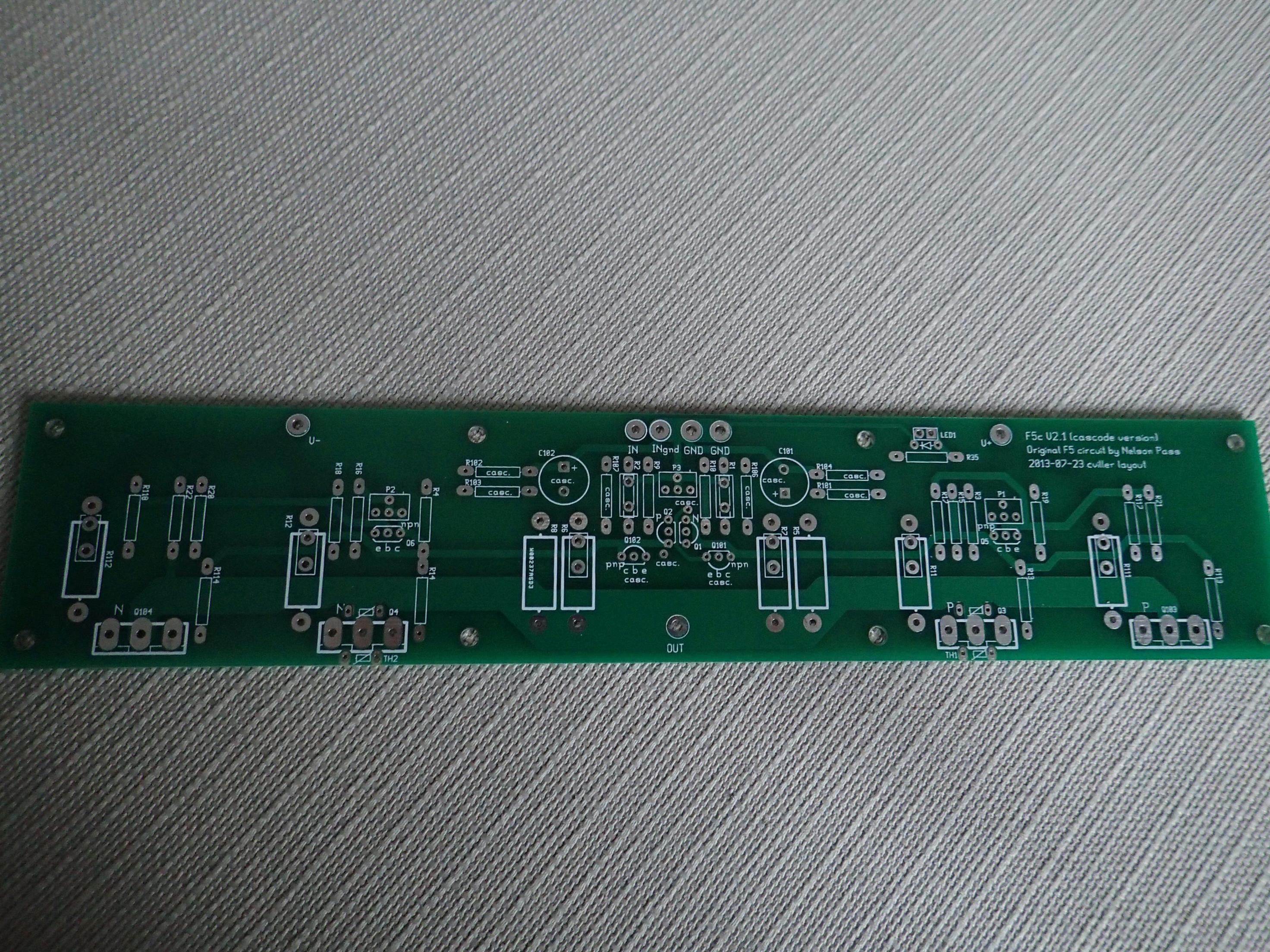

I first posted this on "F5 Turbo Illustrated Buil Guide", but I think this thread is a better place to share my problems.
I wrote this:
I have built more than twenty F5V2 steroset, but never run into a problem like this. PCB is cvillers(see photo).
Setting bias give this results on sourceresistors: Q4(NPN) 254 mV but on Q 104(second NPN) 11.4 mV. Q3(PNP) 240mV but on Q 103(second PNP) 28.5 mV. Offset is no promlem to adjust(1-2 mV).
I have other NPN and PNP taken from the same bat. so to find two of each to match will be easy(but not matching NPN and PNP). As long as I can adjust offset close to zero, I find this kind of matching fair.
