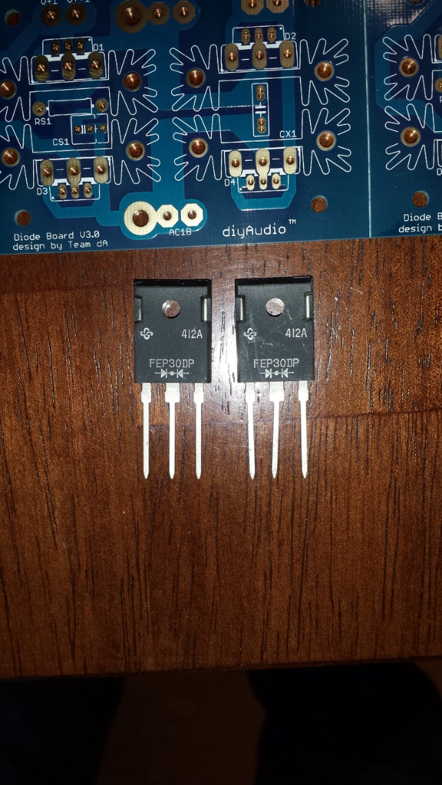

Hello. Please help me answering the dumb question below....
I'm using the diystore universal PSU board for my build, and I got the dual cathode rectifiers (TO-3P case) FEP30DP for that board that are shown in the image below.
Question: Do I need to cut one of the 2 anode legs on each of these dual rectifiers in order to have only 4 diodes per bridge (instead of 8)? If not, then why are both anode legs needed at the same time?
Thanks!
522597d1451777896-diyaudio-power-supply-circuit-board-v3-illustrated-build-guide-diodepic.jpg
EDIT: Never mind. Question already answered. Thanks.
