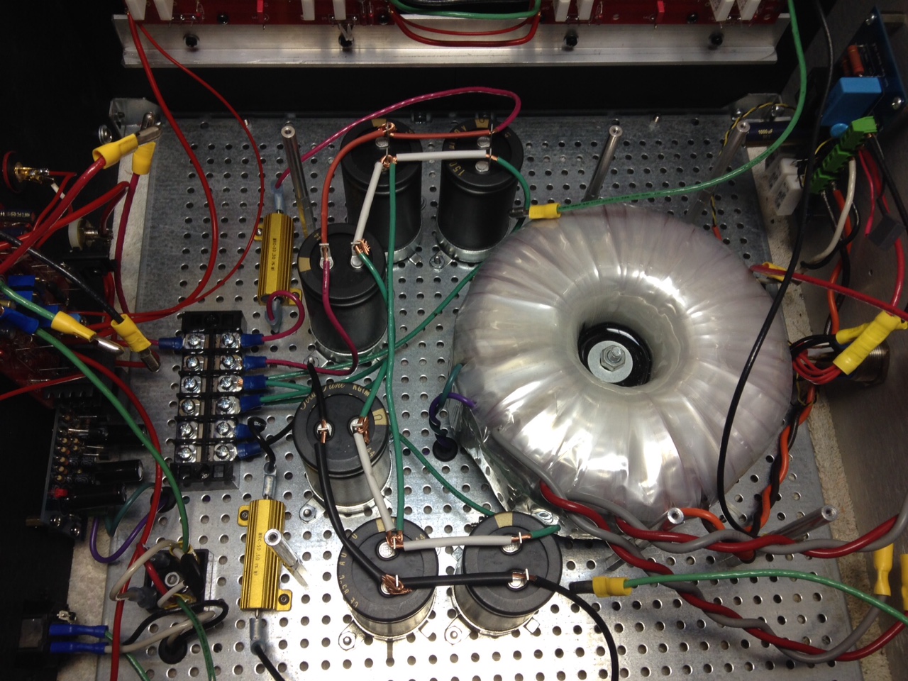

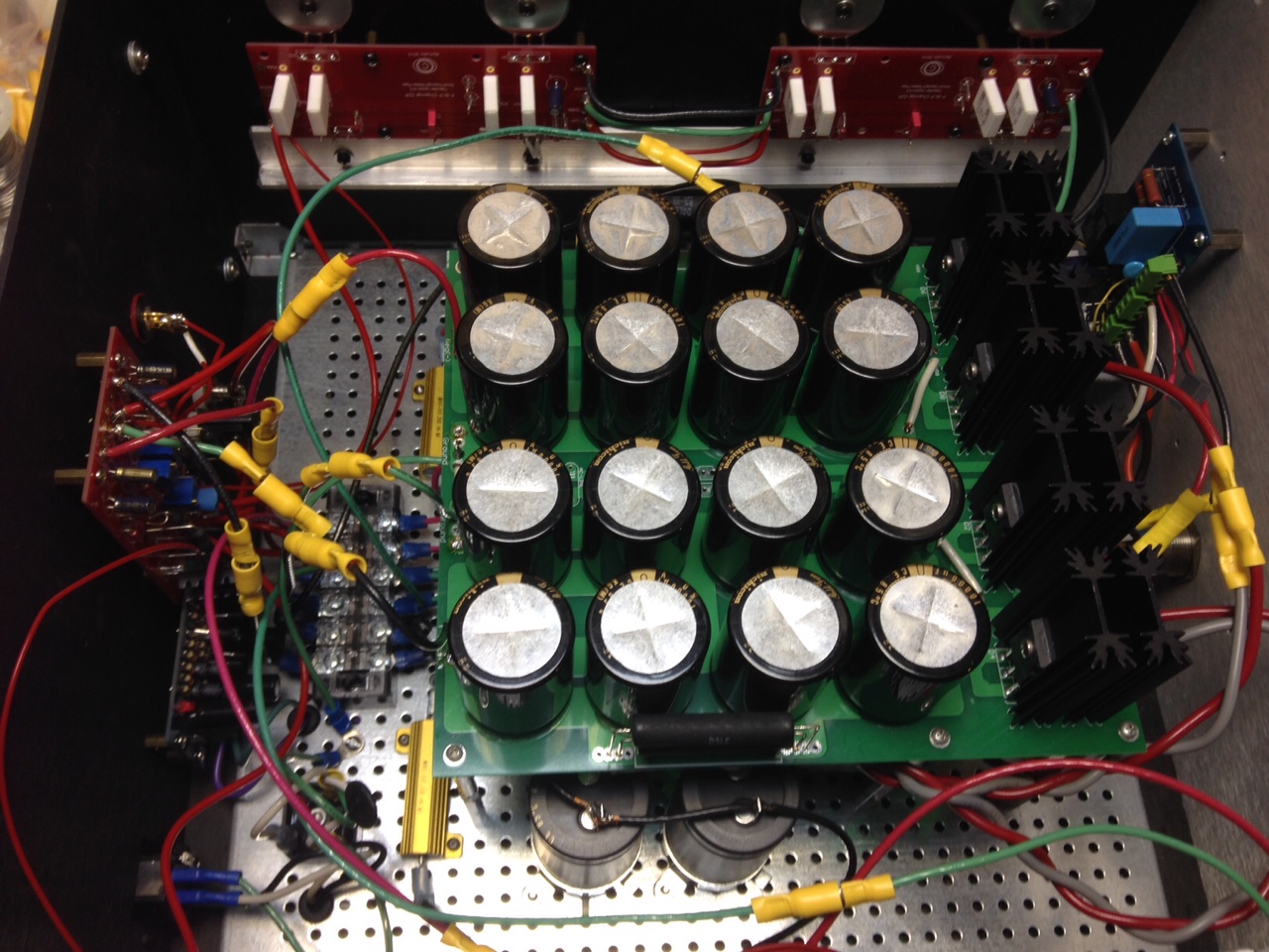

As much as I have enjoyed my F5T V3 monoblocks over the past 15 months or so, I was a little disappointed that they lacked some of the authority and weight that the Aleph 1.2 monoblocks they replaced had in spades. I had hoped that fiddling with P3 would work, but that effort proved ill-fated (see http://www.diyaudio.com/forums/pass-labs/267431-f5-turbo-3-failure.html). Instead of gambling against the odds a second time, I spent part of this past weekend adding another 90,000 uF (and a 0.5R / 50 watt resistor) to the stock-sized power supply in each amp, bringing the total to 250,000 uF per monoblock. The power supply capacitors (twenty-two per amp) are all Nichicon KG. This won't come as a surprise to most of you, but the results are terrific -- there is no bloat, the amps still sound neutral, fast and dynamic and my V3s are more commanding and engaging than before. Highly recommended!

Yep, more caps always help. a bigger transformer helps too
When I built the F5TV3 I went all the way with 564000uF and 1.5kVA trafo per mono. I don't think I've ever been able to clip it or have music compress yet with several systems its been on
