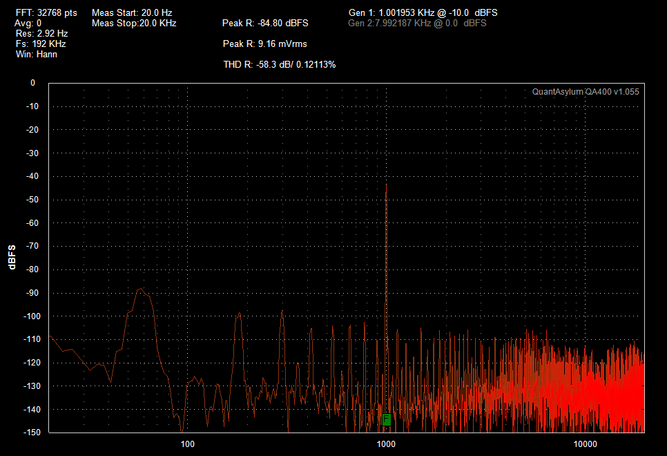

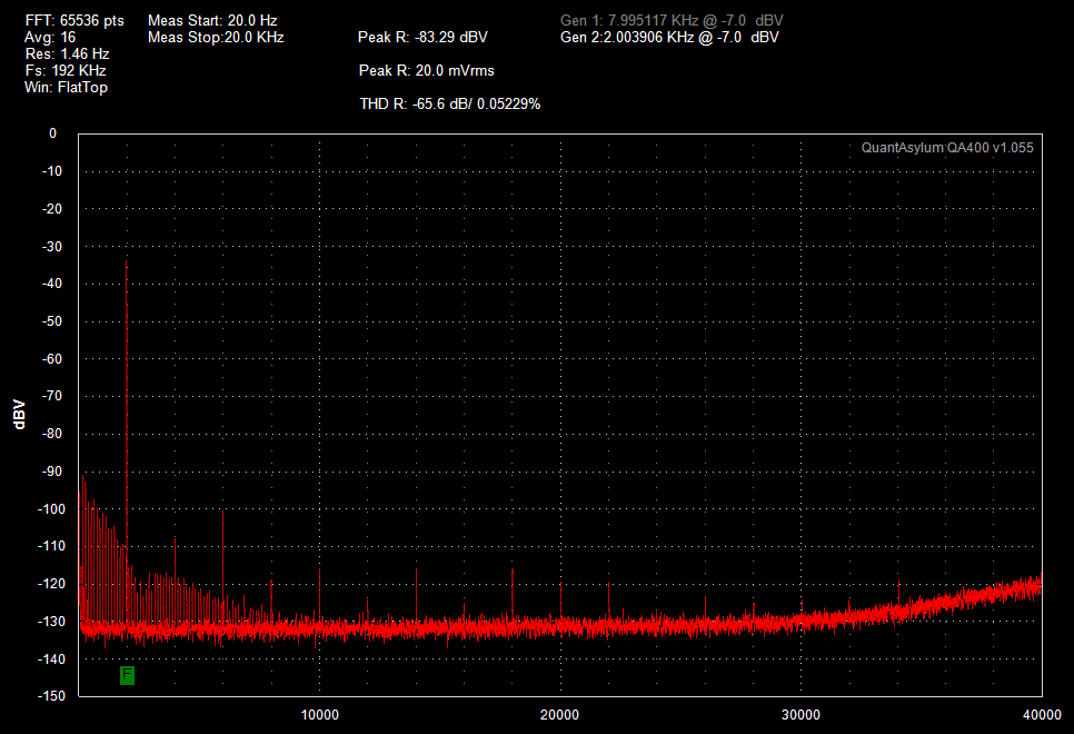

OK so here is the symptom. Measurements with the QA400 distortion analyzer and QA190 differential probe clamped via alligator clips on the speaker cables.
These are the distortion results at 48KHz sampling rate:
16K: 0%
8K : 0.019%
4K : 0.026%
2K : 0.014%
1K : 0.05% -- AND WHEN SIGNAL IS REMOVED THERE IS AN ECHO OF THE 1kHz SIGNAL!!!
What I mean by echo is that the QA400 applies a test tone to the unit in short bursts. The echo is that of the test tone burst starting and stopping, and eventually fading away.
The cap bank is 88,000uF per polarity per channel, arrange as CRC with R=0.1 Ohm.
I have installed 330uF caps on the output boards Cx positions, thinking PS bypass. Can this be causing the issue?
Another issue *may* be the large ground wire loop from PS to FE and back along the output board ground traces. B
Any help here would be most appreciated.

Just starting to learn how to use the QA400. I exported the F5Turbo data (but not the F5) The second harmonic is 14dB higher than the 3rd harmonic.

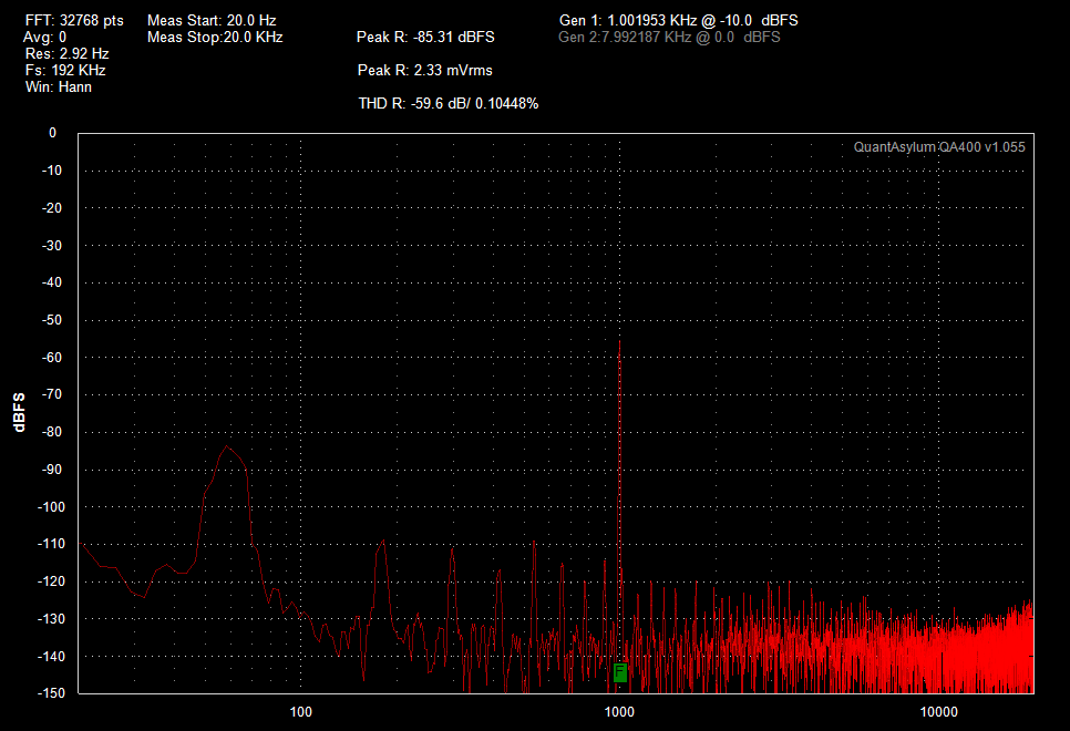

I did another try with a resistor ladder on the output instead of using the differential probe. Also changed was a BNC to RCA connection. Instead, I used a delco quadstar cable and modified a BNC terminator to fit one end and soldered an RCA on the other. It produced the attached graph.
A lot of the noise is the mains and it's harmonics. I can see a broad band around 60Hz.
I can count all the harmonics from 180Hz, 300Hz through passed 900Hz and continuing up past 3kHz.
You have to find the cause of these odd harmonics and attenuate them.
Where are the harmonics coming from?
From the two graphs that BigE showed, one of them is his F5 Turbo, which he has a smaller EI core transformer running the soft start and slow charge. I don't think it is the cause of the 60Hz harmonics.
The second graph is actually my F5, which also shows the similar harmonics! This build does not have soft start nor slow charge circuit. Power is fed via a toroid, and just CRC filtering.
Could it really be ringing from the diode bridge? I thought that noise was much higher frequencies?
Or would it be from Loop Area RF? although Looking at BigE's cleaned up build every wire seems to be heavily twisted, although still using PCB for caps etc.
The harmonics are coming from the switching of the mains waveform and from the distortion on the mains waveform.

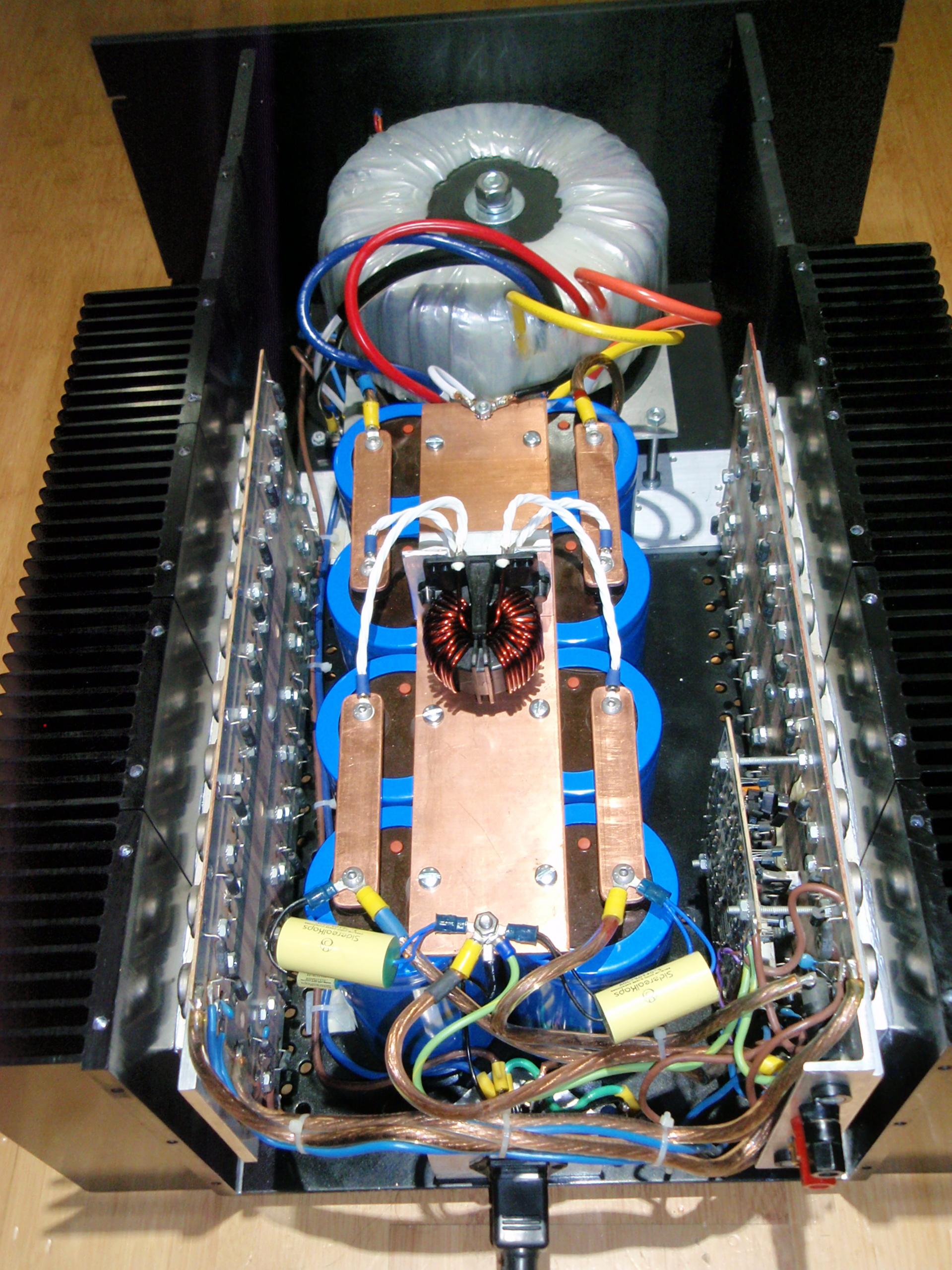

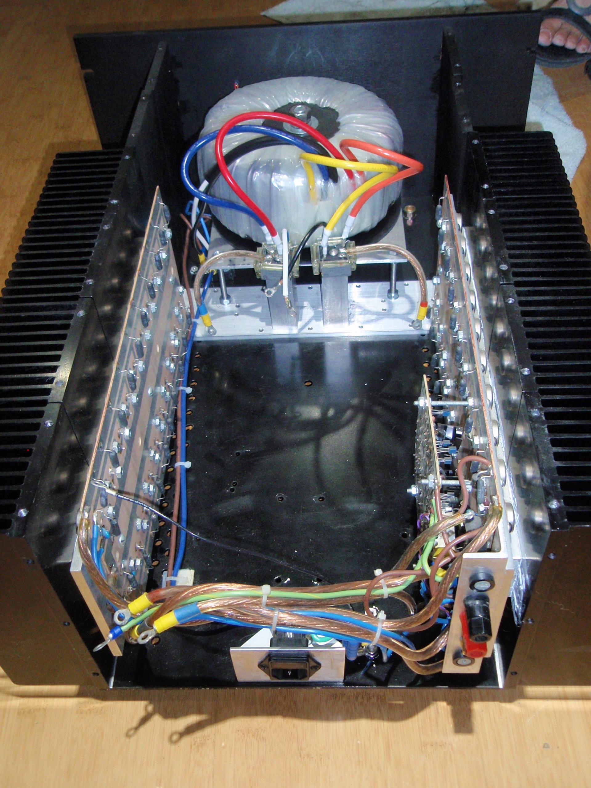

Redux on SA/1 Amps
Hi All,
Back in Mid-July I posted an update to my SA/1 clones with the intent of using the chassis components and Power supply part being removed to be used in a F5T build. After waiting months for the caps and getting larger heatsinks and having everything black anodized, I have the amps back together.
You can see the old pics on page 344 post #3425. The first new pic shows the relocated rectifiers. As Itsmee pointed out they were feeding heat into the caps, now they are on 1 inch square bar pedistals to raise them up so the leads to the caps can be short and as a heat sink attach to a heat spreader on the bottom of the chassis.With the increased bias current they now run around 36C.
AudioSan pointed out the heatsinks were too small. With the sinks at 50C and the transistor cases at 55C I could only run 4.6A of bias, should have been 5A, with the 48v supply voltage, or 220w. Just changing to the new larger sinks dropped the temp to 38C on the sinks. I was able to up the bias current to 6.8A or 312w with the sinks pushing 52C and the transistor cases at 54C.
The second pic shows the new CLC bank. Took out 118000uf and put in 568000uf with 3mh inductor in the middle of each rail. Loaded voltage is now 46v.
The third pic is just the top cover plate laid in place with all the holes I hand drilled and counter sunk before andonizing. The amp actually runs cooler with the top plate screwed in place, acting as another heat sink.

Thanks for all the comments that lead to the improvements.
Have a good one,
John

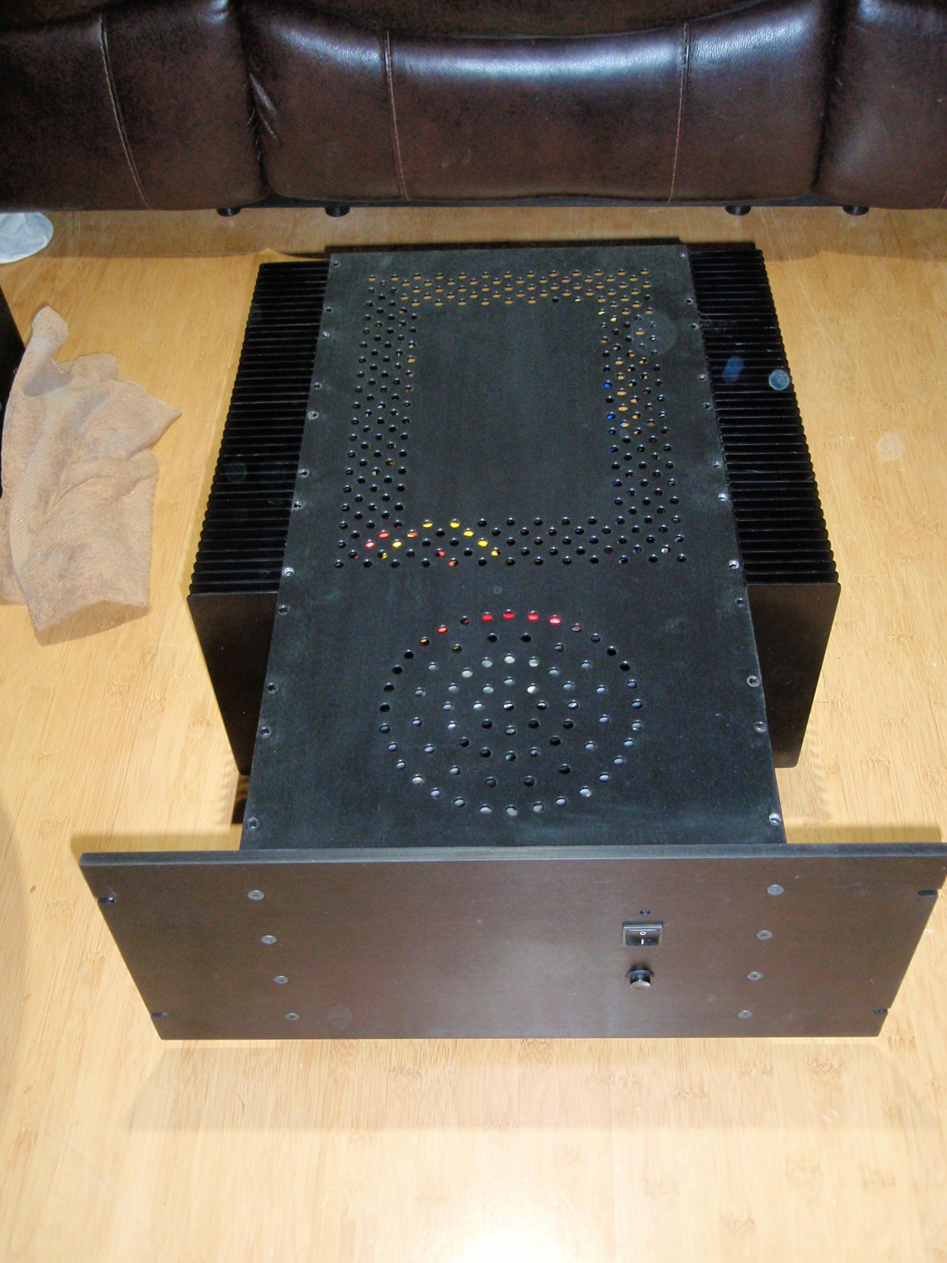

Hi All,
Have a good one,
John
Did you use a pattern to drill all those cooling holes in the cover?

Hi nashbap,
To drill a consistant pattern I taped graph paper to the top of the panel and used a spring loaded center punch to get the marks on one cover so the drill bit would not wander. I then drilled the corner holes on the two covers, one for each amp, and bolted the plates together. I then drilled all the holes with a small diameter bit that would not wander from the center punch mark. After drilling all the pilot holes I than drilled with the final hole size bit. After unbolting the two plates I then eased each hole with a counter sink bit, both sides, to bevel the holes, it deburrs the holes and looks good too. A lot of work but it flows a lot of air and the inside of the amp stays as cool as the outside.
