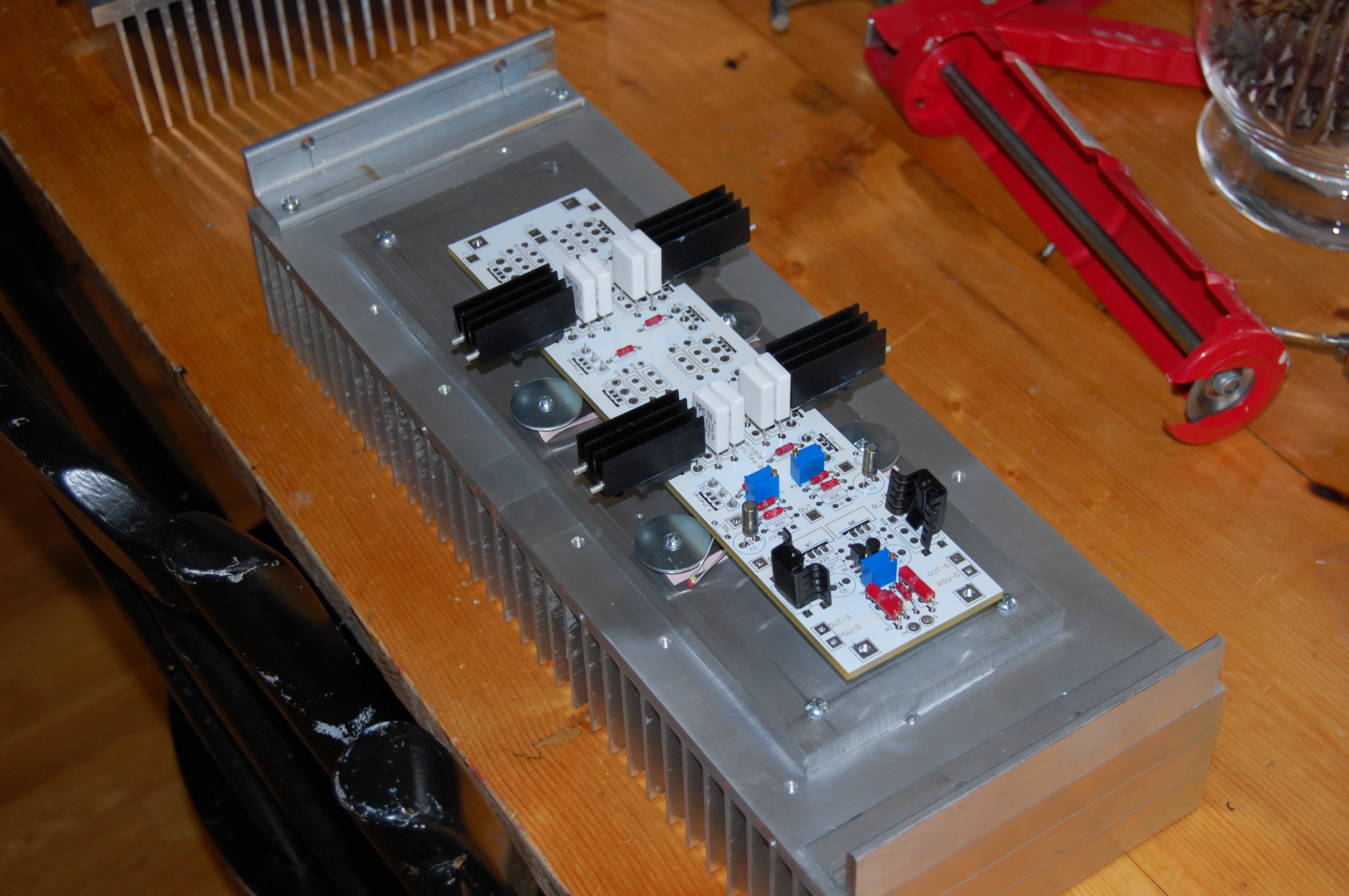

Little Progress with TeaBag's boards
Love the diode heatsinks...perfect for my solution.
Size of your main heatsink is ?
Looking forward to your findings driving that board really hard.
I dont know how much i can push them. Two 12" XXLS woofers wired in parallel, playing at uncomfortable levels wasnt pushing them. I'll give it my best attempt. I have considered adding the other 2 pairs of devices, making Rs 1 ohm, and cutting biad through each fet to 400mA. IT seems like the wrong direction, but i just read how the XA160.5 has each fet biased at only 7watts. I was quite shocked at this and perhaps read it wrong, but it has me considering the benefits/consequences of more pairs at lower bias, vs less pairs at higher bias.
It was definitely interesting to read how low the XA.5 amps were biased. I know they are SUSY and haev other mechanisms at work that I do not fully understand, but interesting none the less. I have the amp together and fighting whether to strip it and paint it. I know if i finish it and begin to listen, I will take forever to actually paint and finish.
Thanks for more complete info, but still a low per fet bias. Question? Does the transconductance of multiple pairs add causing a reduction in noise and distortion? Also, I think I remember Nelson saying that multiple pairs alos had a beneficial effect on Capacitance and drive/bandwidth issues.
