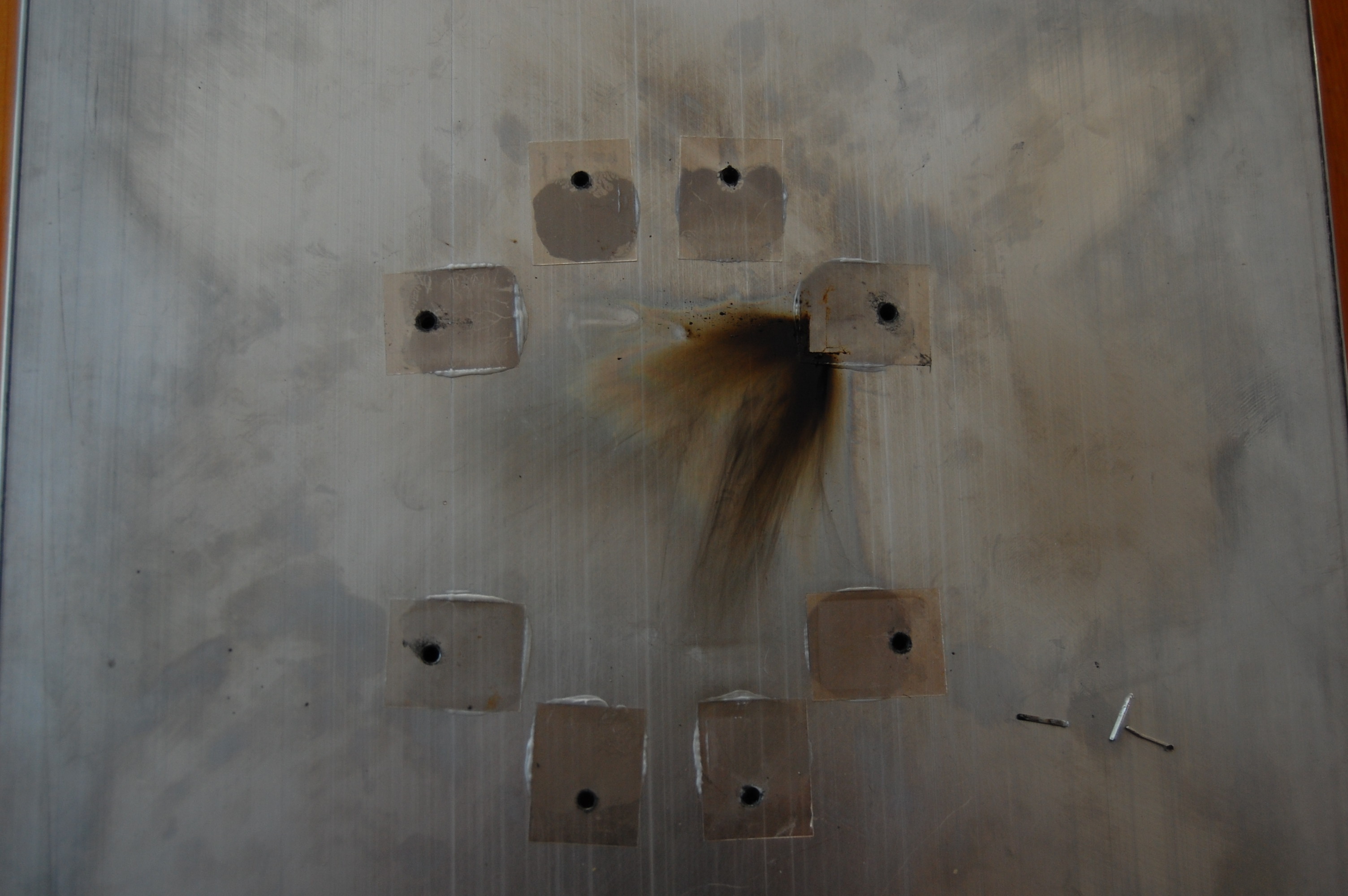

Here is my proof. I made the magic smoke. I have been running the F5T on smaller heatsinks for over 2 months, with diodes separated from main sink, Tonight i mounted them all on same sink and viola. Same bias as before of 400mV across Rs. Going to mount another and make sure the fet had good heatsink contact, but they had been resting safely at about 360mV before I raised them the final time. The burn happened in just a second or two, so it seems obvious it was thermally based runway. My suspicions are the diode temperature. By bringing the diodes to the sink temp, you leave yourself with less leeway in terms of temp variation. The likelihood of constant pushing into diode territory, except on extreme transients is not high. If they are adequately heatsinked of the main sinks, I don't see them having a problem. I will watch with temp probe this time.

I am not sure about the thermal runaway theory. The thermal mass of the heatsink would not permit thermal runaway within a second or two. I suspect something else. How are you attaching your thermistors? I burned up fets on my first build due to a thermistor shorting to the drain lead of a MOSFET.

THis is the current path. I had created tension that was lifting the fet slighlty at that lower end. All fets and diodes will be mounted first and then soldered. THe thermistors are underneath the board and free from contact with anything but the heatsink. They are bent out and when the board is placed, it creates a natural spring tension on them. It is still my beief that seperating the diodes from the heat of the sinks is a good idea.

Simplest explanation is thta they act sort of like a bypass cap you see in tube amps. Shorting the signal to the ground and increasing available gain. Difference is, that they also have an affect on DC bias, since they entire AC signal is not shorted. Sliding bias is a term that has been thrown around. Perhaps a more astute member could give a more thorough explanation.

He said he only officially built V1. Probably loosely asssmebled on test sinks or something. I am probably wrong, but even Jacco recommended them on seperate sinks, suggesting the exponential portion of the diode curve is more greatly affectd by the temp than anything else. Adequate heatsinking is hard thing for DIY member.

I can see thermal tracking of the fets if the result was bias containment, sort of like thermistors, but if tracking results in bias increase? ZM is absolutely right in one regard. Nelson would not release this unless it was thoroughly tested. I simply suggest very attentative heatsinking. In my V3 build, I will have 4 fets within a 160mm of each other. That is a lot of heat to get rid of.
