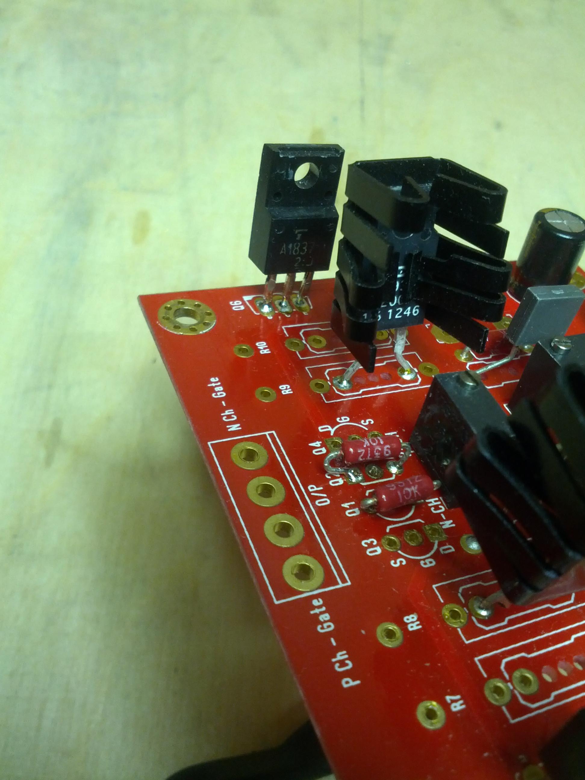

So I put in 10K resistors across the drain and source on the FE board where Q1 and Q2 are supposed to be.
Q1
Drain - Gate =12.41V
Drain - source = 12.46V
Gate - source = 10mV
Drain - ground = 12.46V
Gate - ground = 0
Source - ground = 10mV
Q2
Drain - Gate =12.26V
Drain - source = 12.37V
Gate - source = 10.6mV
Drain - ground = 12.33V
Gate - ground = 0
Source - ground = 10.7mV
Now what?

Well I just measured at the BJT and I get 0.57V across the Base and Emitter so I think I'm good there.

ok new bjt's in. These are the ones off the other channel that was never powered.
Nope, still 12.46 drain to gate on the 4793 side and 12.37V on the 1837 side.

Ok removed resistors, and put in the original jfets I had and left the new BJT's in.
I get the same results
Q1
tested on Q3 holes
drain - gate = 0.59V
drain - source = 0.58V
gate - source = 50mV
drain - ground = 0.62V
Q2
tested on Q4 holes
drain - gate = 0.51V
drain - source = 0.50V
drain - ground = 0.58V
I checked the caps they look like they are in the right polarity.
perhaps I should just leave this and add the secondary power board in?
Q1
tested on Q3 holes
Q2
tested on Q4 holes

It seems to me that there is a problem with the cascode. A drop of 4v with just a 10k load is highly unusual, and frankly the fact that it drops to zero when a forward biased jfet is connected, is expected.
I know you've replaced the BJTs, but I would go over that part of the circuit with a toothcomb. With a 10k resistor you should see pretty much the exact same voltage as open circuit. I have not seen the board layout unfortunately, so will be limited in helping out. I suspect either an elementary, symmetrical error or a busted component.
While testing, remember to short the input out completely - junction of jfet gates to be routed to ground. This will stop the jfets conducting and make troubleshooting marginally easier. You cannot set bias in this condition, for that you have to short the input pads of the board.
