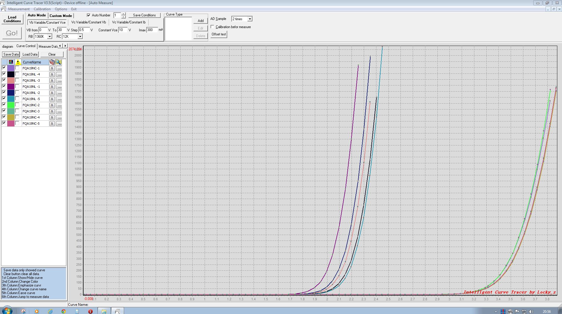

Mind that they offer only the FQA19N20 L
The L type has a much lower Vgs threshold and a very high transconductance value than the type without suffix or the C type.
Matching them with the P type could give a very high 2nd harmonic distortion.

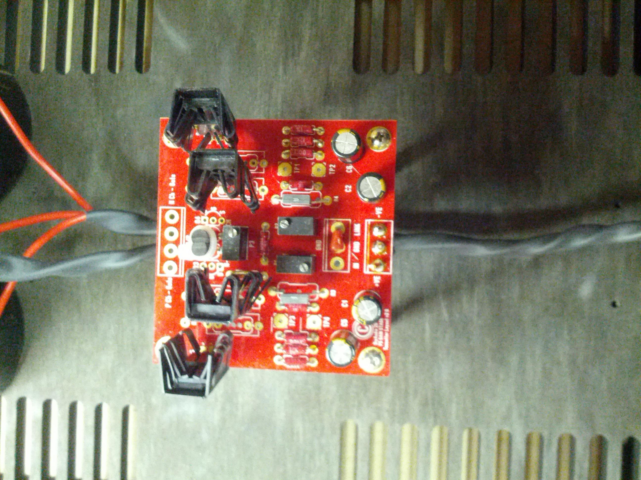

I blew a JFet on one of my channels because I put them in the wrong place. The JFETs where from Buzz's GB. I got a full new set from FET Audio in Singapore. Should I A) replace them all on both channels so they are from the same source/batch or B) just replace the bad channel? I figure I should replace them all to be sure the IDSS matches? Of course I have no idea what I am talking about...
Im finally up to assembling the F5TV3.
I'm testing each and every stage before I go on.
I just powered the FE board.
I'm getting 58V from TP1 to PS ground as well as TP3 (note my PSU is 58V unloaded)
I haven't turned up P1 and P2 yet and its running about 1.6V across TP1 /TP2 and TP3 /TP4 respectively.
However, I;m only getting 50mV from source to ground at both the Jfets
and 0.8V from Drain to ground on Q1 and 0.6V from drain to ground on Q2.
Is this correct? I was expecting about 15V.
Note R25 and R26 has been changed to 12K and R28 and R27 is still 4.75K.
Did I do something wrong? or do I have to connect the output boards before the jfets see higher V?

1837 should be on pos rail, so you should be fine. Dont have the boards, so it is hard to follow. Crummy thing is, if something is wrong with the bjt's, it probably cooked the Jfets as well. Measure the voltage across the 4.75k resistors to see what V drop you are getting.
Oh crap. I don't think 1837 is on +ve rail.
The +ve rail is the bottom side in my pic. it has the 4793 in it. as well as the k170 (Q1 as marked on the board)
the -ve rail is on the top and that has the 1837 and J74(Q2 as marked on the board)
