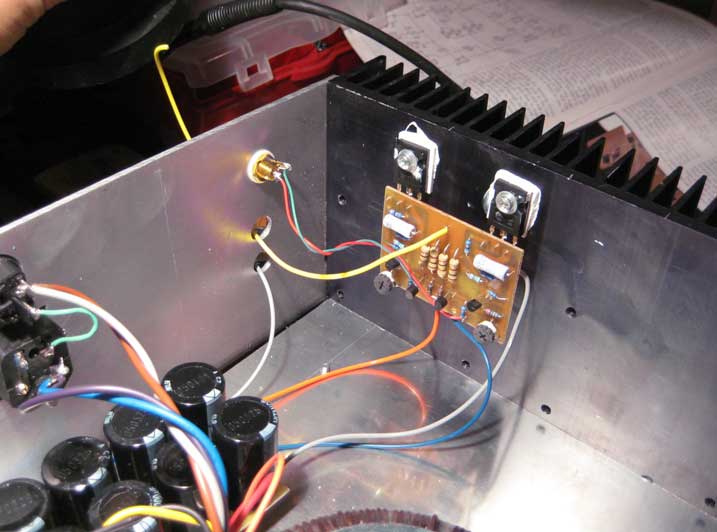

I was gonna say the same thing -- and this just from the simulation. I set the pots to 1% per click and just a small change can really affect the bias. NP makes this point quite clearly in the AX article (it arrived yesterday afternoon) so everyone is recommended to start at 0.
I had a couple of prototype boards burned (don't have the time right now to make my own.) If I were to do it again I would put the output MOSFETs further apart since this thing really cooks. A 0.6 C/W heat sink is recommended.
Notice article suggest fairly good size of heatsinking to satisfy the c/w details. I used borderline as myself running without the therm comp thus probably not good idea, for my situation, to run it like an aleph (sizzlin).

Here's a conceptual PCB design which will probably do a better job of diffusing the heat -- the MOSFET's are on the wings (and are mounted with pins coming from underneath the PCB). The PCB is 3.7" * 1.8".
jackinnj said:Here's a conceptual PCB design which will probably do a better job of diffusing the heat -- the MOSFET's are on the wings (and are mounted with pins coming from underneath the PCB). The PCB is 3.7" * 1.8".
Conceptually looks great really, you got my humble blessing.
I would put those power resistos flat over the board though, even if that means a bigger PCB
IMHO :
1) I would use a foil resistor at the MOSFET source (R11), like e.g. MPC74 0R47, which has a similar footprint as wire wound ceramic resistors.
2) I would place TH1 directly on the MOSFETs for thermal compensation.
3) I would place R13 as close to the MOSFET gate as possible.
4) I would place R3, P1, R15 as close to R13 & R11 as possible.
5) R19, R17, R21 and the BJT can be placed further away, as they are only for protection.
In addition, the feedback path also want to be as short as possible, without saying.
Patrick

The thought I had was to do with trying to get the heatsink disapating the energy quickly and evenly as soon as possible. So rather than having one central hot spot space them out to use more of the heatsink surface. I am not sure if it is an issue or not, I guess that would depend on the heatsink.
SCD said:
... I guess that would depend on the heatsink.
In the end thats the point.
If space allow I would spread the power transistors... but hen again my Aleph4 runs them at 1 1/8" pitch, there are 12 FET's per channel on this one and no problems.
BTW, EUVL points are to be considered on the detail design, no doubt about that
To be more precise, it is about your thermal management strategy.
Apart from wanting a short electrical path with low resistance and inductance between power FETs (i.e. assuming you get that one solved one way or another), you DO want to have all FETs thermally well coupled so that they have the same temperature at all times as much as possible, so that they drift together in the same manner.
On the other hand, you might NOT want all 200W or whatever that you are going to burn to be all concentrated at a 50x50mm patch if your heatsink is say 400x200mm, because you are then likely to get uneven temperature distribution on the heatsink and therefore not making the most effective use of that.
How you balance one against the other is art. And everyone has his own preferences.
Patrick
