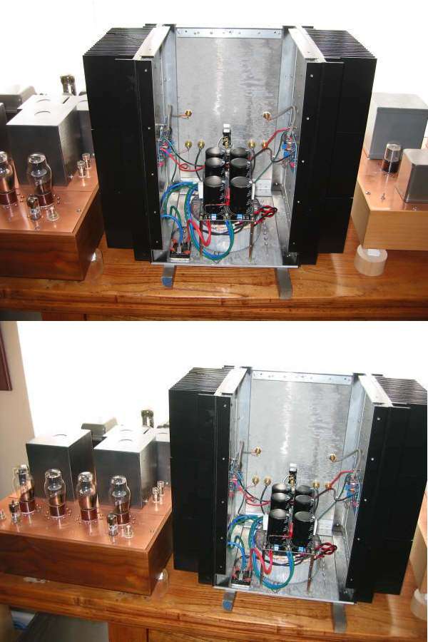

If anyone is looking for F5 heatsinks, the Conrad heat sink group buy is closing soon. These black heat sinks will come milled and drilled for top and bottom covers, and with black bolts, cost about 62. USD each, delivered in the US. Further up in the thread, someone had indicated these would be a good choice for the F5.
See final info on the group buy here -
