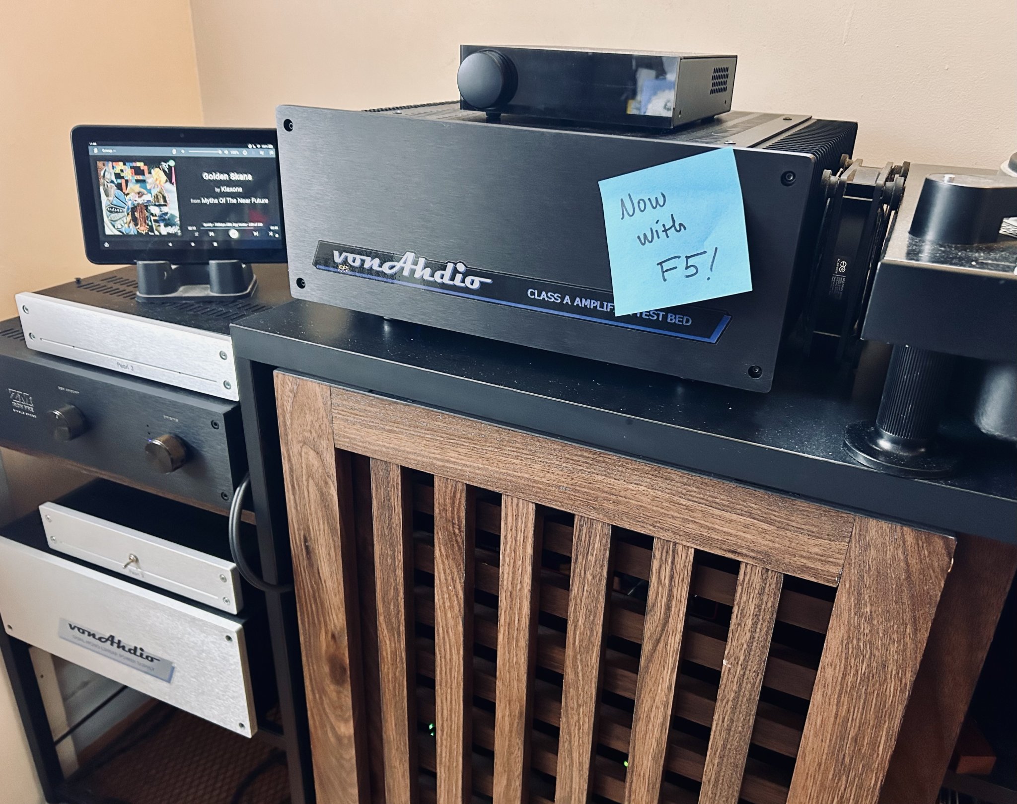

All the recent F5m talk got me to put my 2SK1530 / 2SJ201 F5 back in the main system. :yes:
