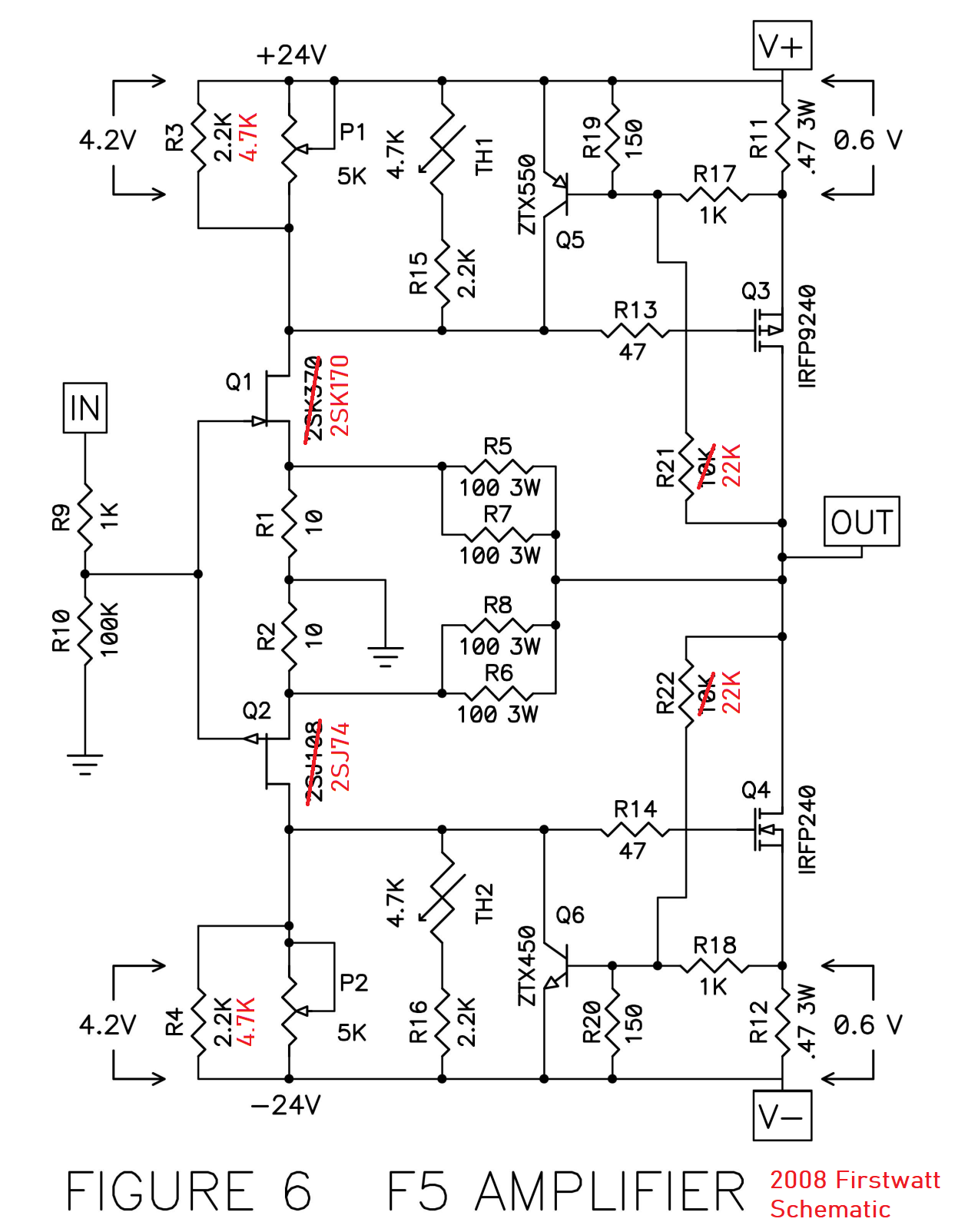

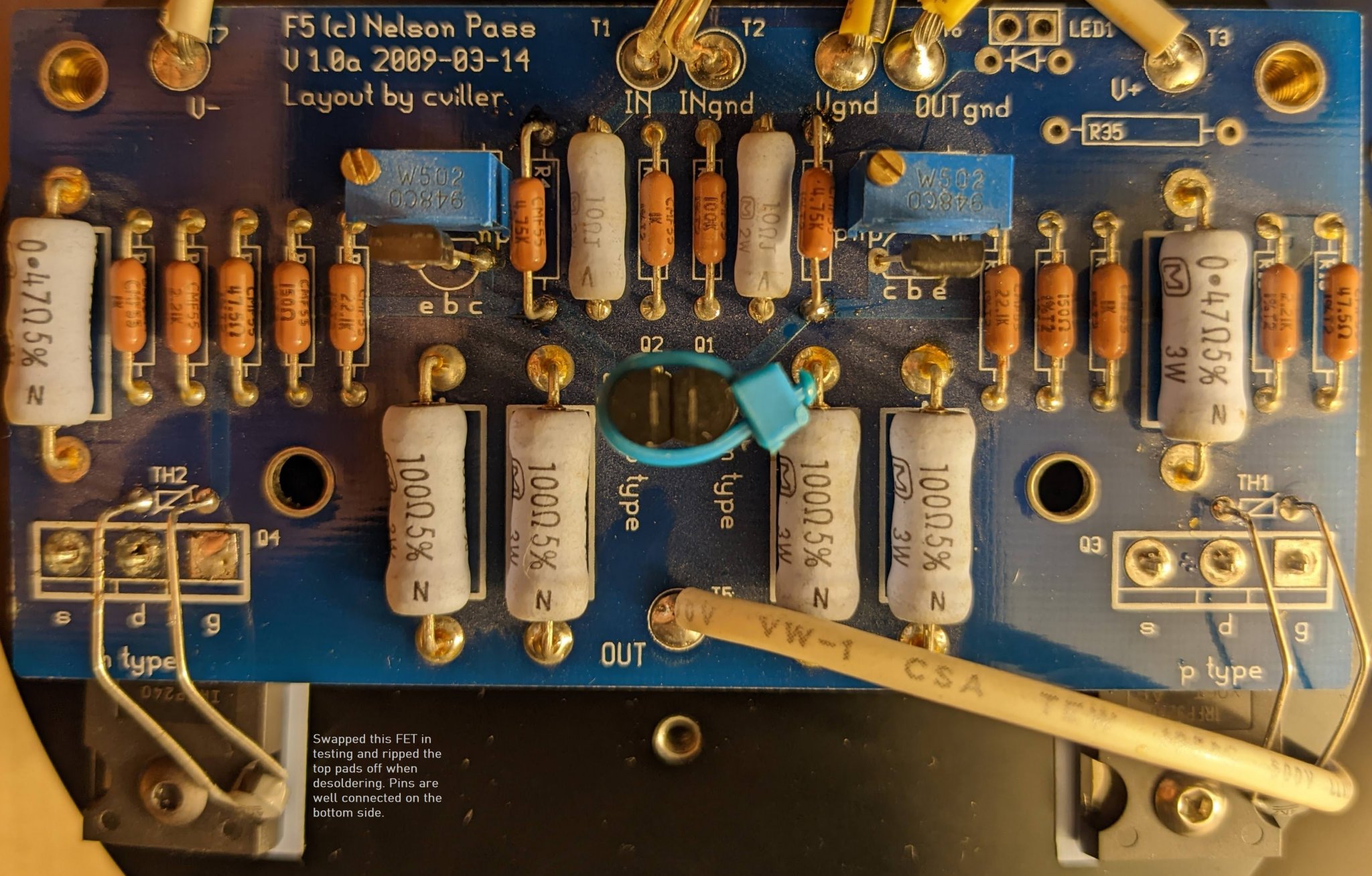

I'm playing around with a fan cooled F5 at the moment but running into bias problems. I'm using cviller's V1 board (2009-03-14) that I found in one of my drawers that I assembled using a TechDIY parts kit about 10 years ago but never built into a complete amp.
On first turn on I was only able to bias to about 0.22V across R11 / R12 with zero output offset with P2 at maximum. I swapped the resistors across the trimmers (R3/R4) to 4.75k. That helped a bit, now I can reach about 0.32V across the bias resistors, but again I am out of adjustment on the P2 trimmer.
Is it safe to increase the value of R3 and R4 further? Is there something else funky going on?
I'm testing with a pair of unfiltered SMPS as my power supply for now, they hold steady at 23.9V while I adjust bias.

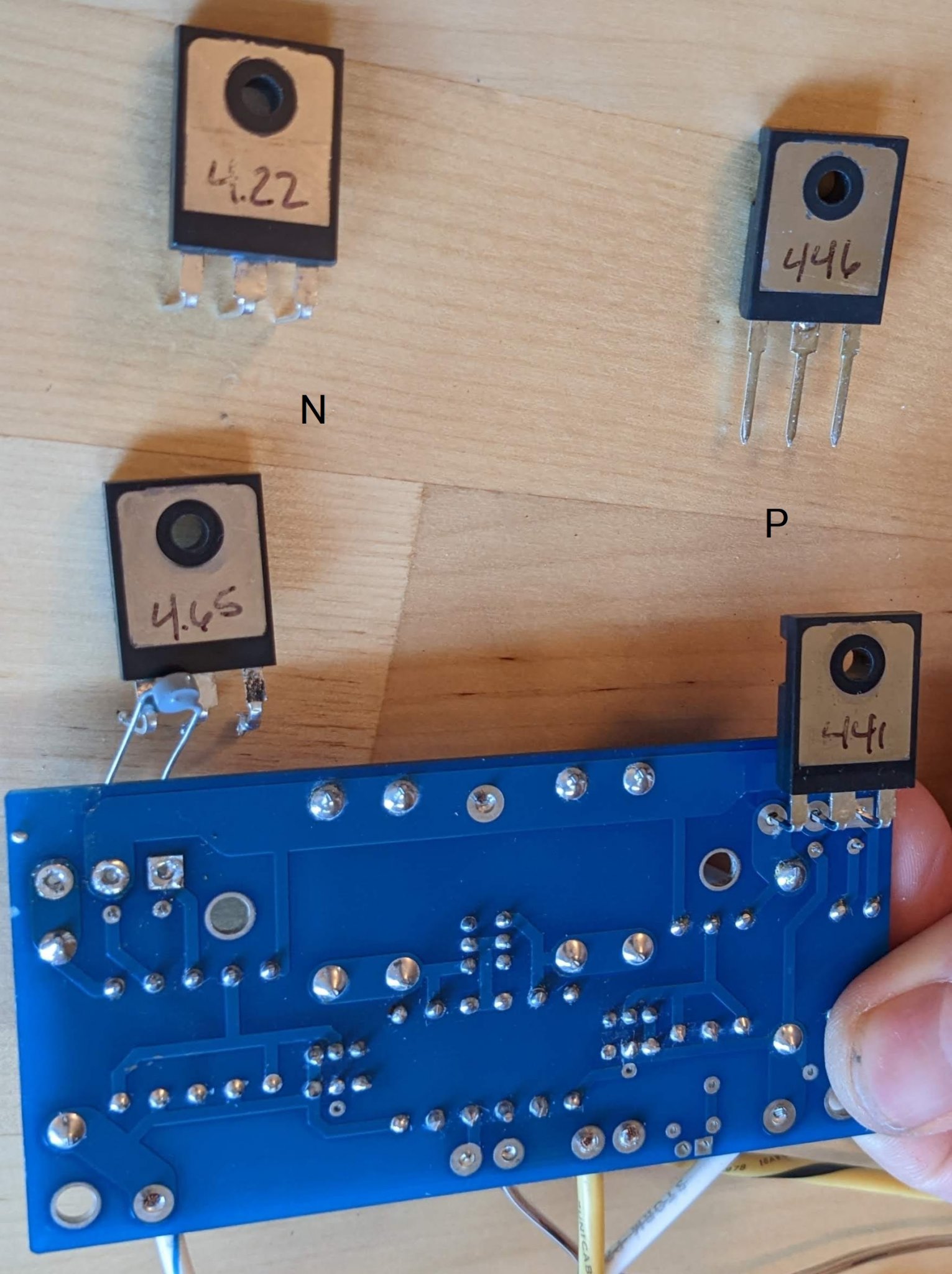

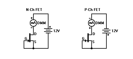

I'm not sure what grade / Idss my JFETs are. My power transistors have some numbers on the back (for matching?) see pics below. I took a shot in the dark and swapped out my N-channel, no difference in behavior.
Please note that the resistor labels have changed on the latest schematic / board. I've attached the schematic these boards used.

you can measure voltage across 10R JFet source resistors, to know what their Iq is
if everything is behaving, but you're short with mos Iq, feel free to increase JFet drain resistances (R3,R4 according to sch you posted)
I just started to measure, saw 46mV on R1 and 24mV on R2, implies N-JFET Iq is 4.6mA and P-JFET Iq is 2.4mA. Thought to myself, hmm those should be more equal, then watched as N-mos bias went to zero, offset voltage went to 7V. Got scared and turned it off.
I turned both trimmers back down to zero. Powered back up. Now I measure 288mV on R1 and 27mV on R2. No smoke came out, but I'm guessing the N JFET is , maybe the P too?
Tried biasing from the start again. N side bias resistor doesn't go up, P side up to around 100mV and I see DC offset around 7V. Too scared to crank it further since I'm not seeing any N bias.

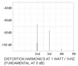

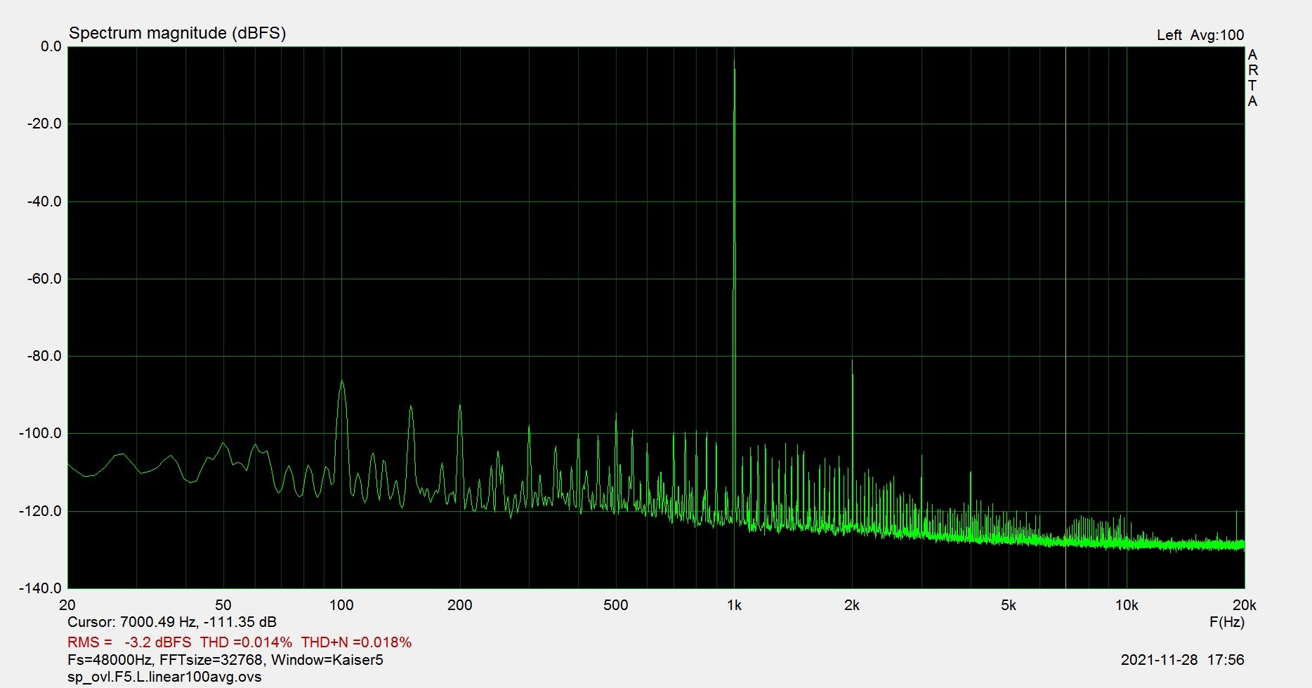

your F5 with P3 centred certainly looks different to mine, you've around 23dB difference between H2 & 3.. you've quite a bit of noise in your plot tooHas anybody tried to tweak F5 with P3 so its spectrum of distortion at 1 W is like this of F7
with 10 dB between 2nd and 3rd harmonic?

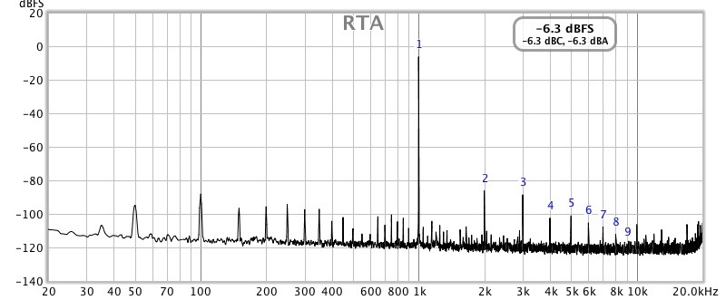

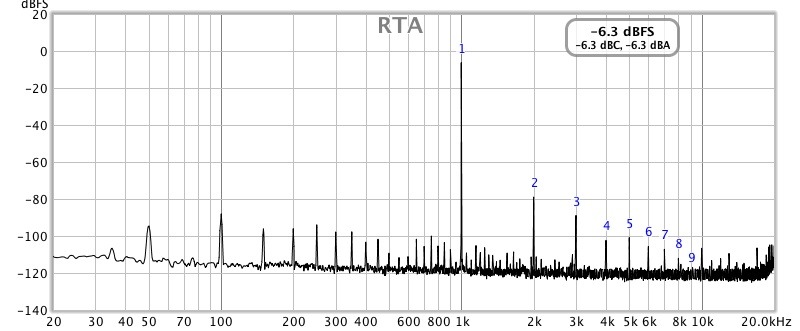

The distortion harmonics of my F5 with P3 at the middle position look like this: View attachment 1010171 View attachment 1010172
here's my F5 with P3 centred by turns and also 2 turns from centre

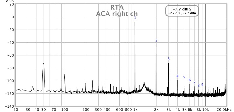

for interest I also attached my ACA plot
