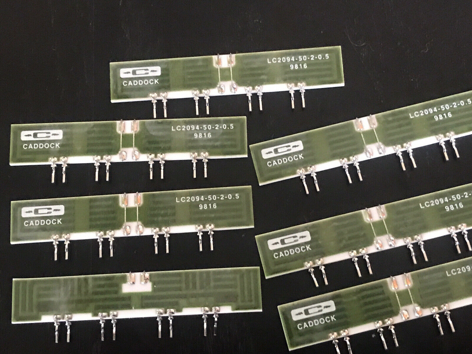

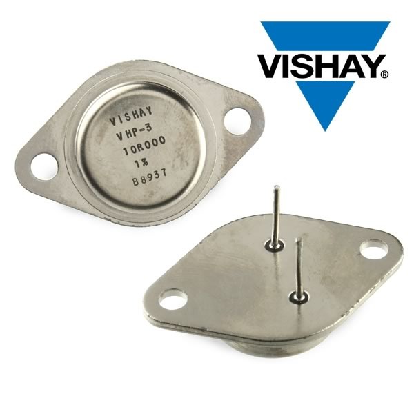

Actually I am using Vishay‘s VHP-3s that I bought in a surplus store. I paid 39 cents each and bought all they had 0.25 and 0.50 ohm 1%.
They were 50 bucks each custom parts new and they pop like fuses pretty easily. I cry when this happen. I got some of the Caddocks on eBay and think they would work very well as they appear to have a very tempco. I have used many Caddocks in feedback networks and they sound great. The TF020Rs are about s good as it gets. I bought my first Vishay bulk metal foils in the late 80s. The Vishay rep for Dallas wanted to know what I was using them for since has customers were NASA, Rockwell, and military weapons contractors. He got pissed off when I said they were going in my stereo. You are talking to one the early parts snobs in audio.
Probably less the bond wire in the Mosfets and meaning less in low MHz amplifier circuit. PS I have done signal integrity design in digital telecom besides analog design. I worked with guys that worried about inductance of a via on a 15 mil pcb layer. I love the smell of RF in the morning but admit being more of a educated RF spectator Than real RF designersVHP-3 inductance 80nH.
