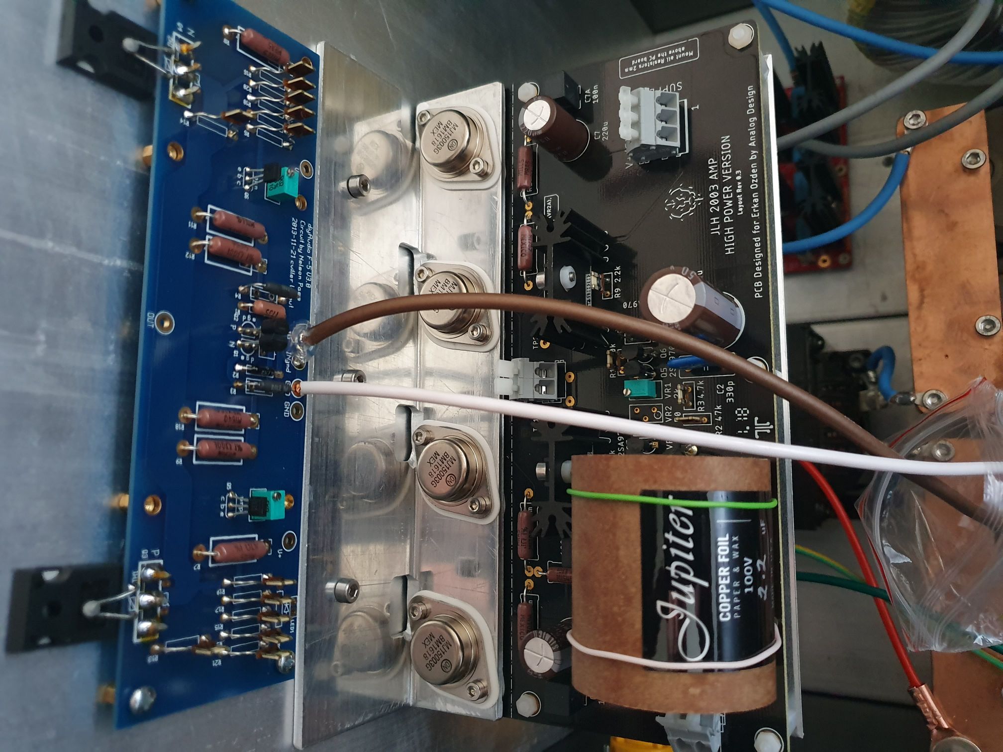

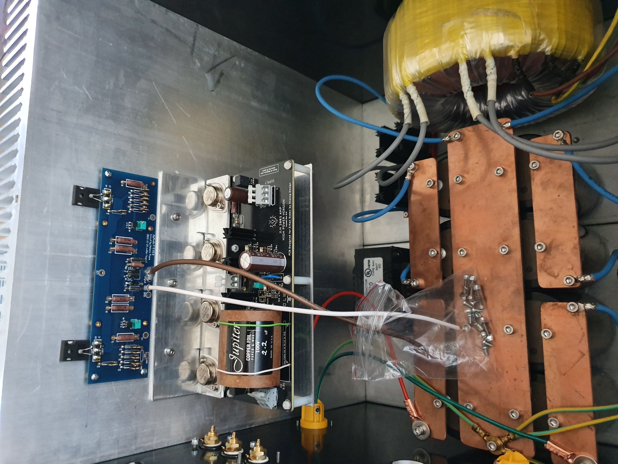

F5 power amplifier
Left channel progress pictures.

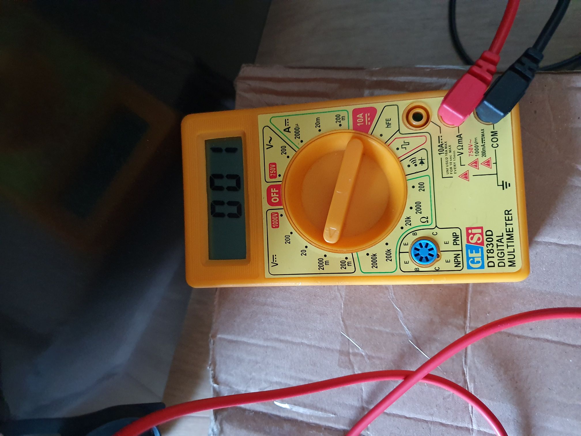

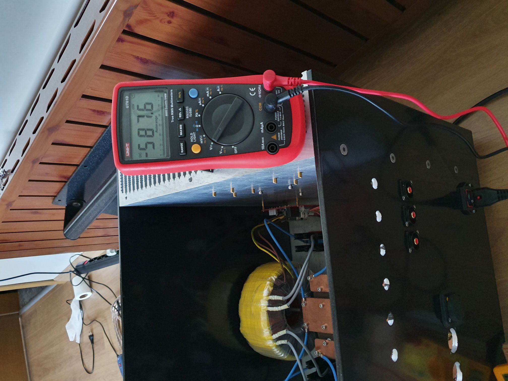

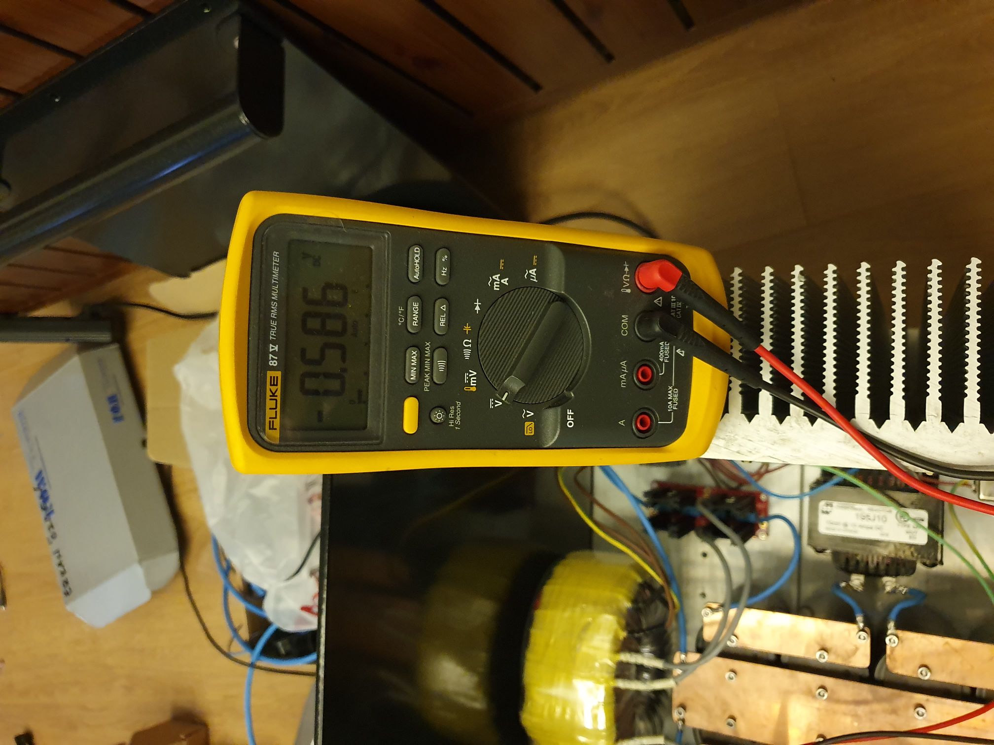

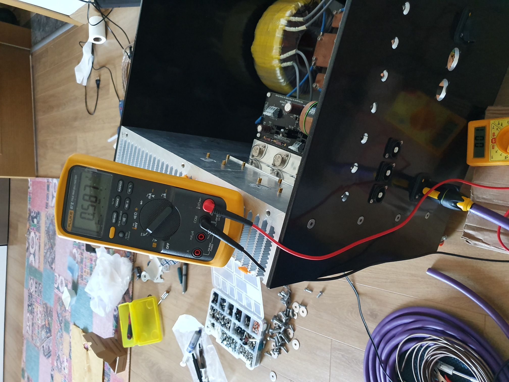

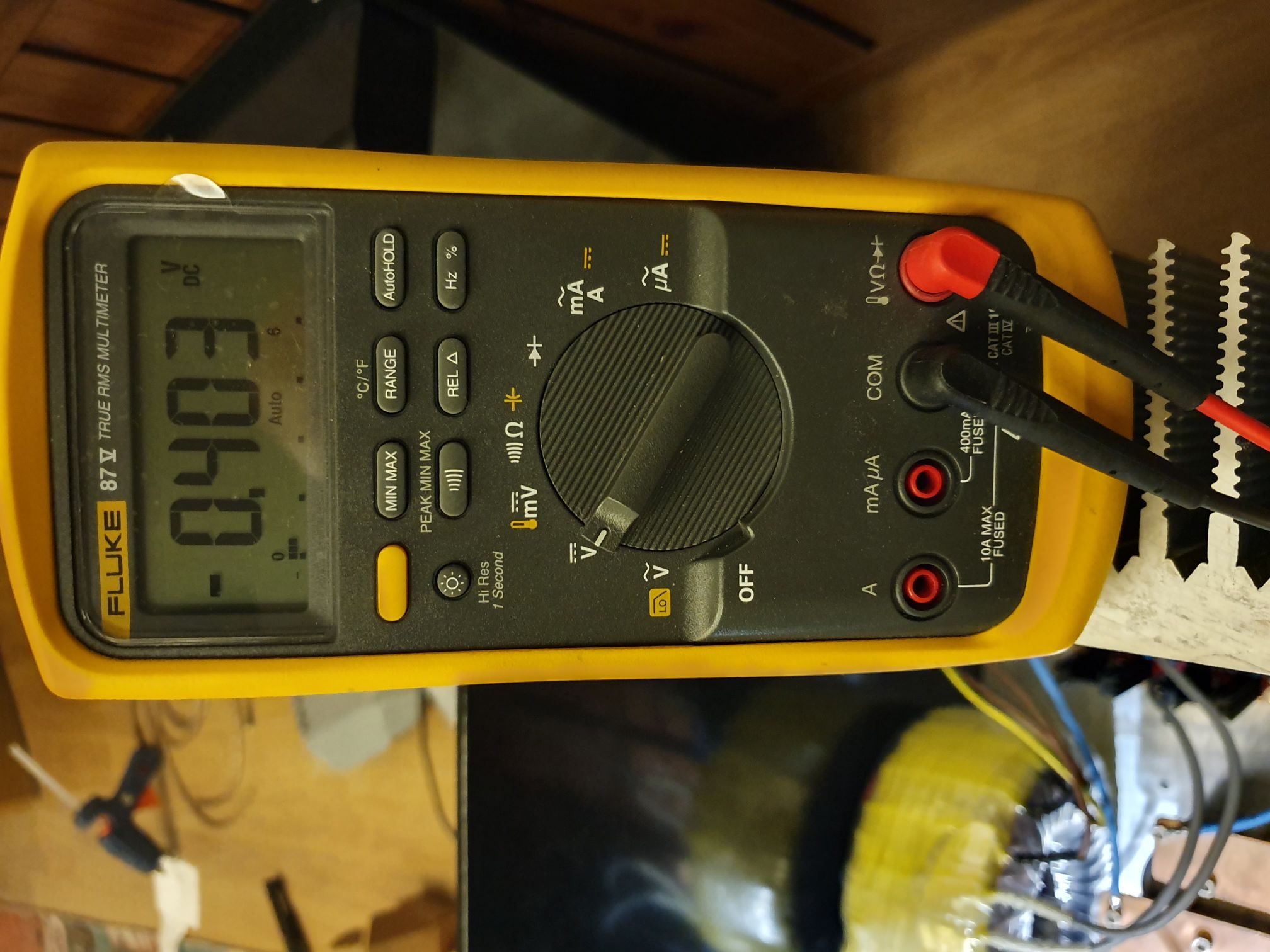

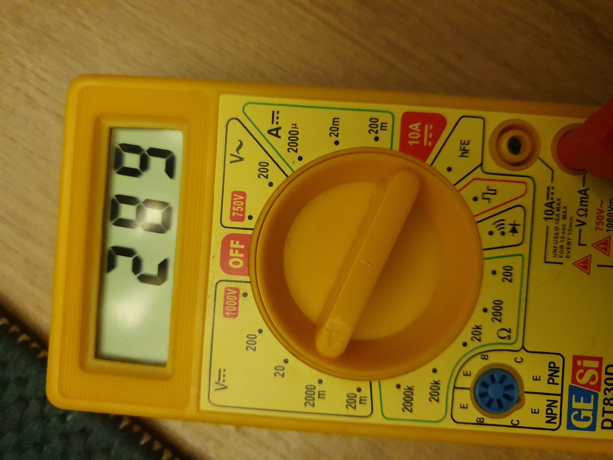

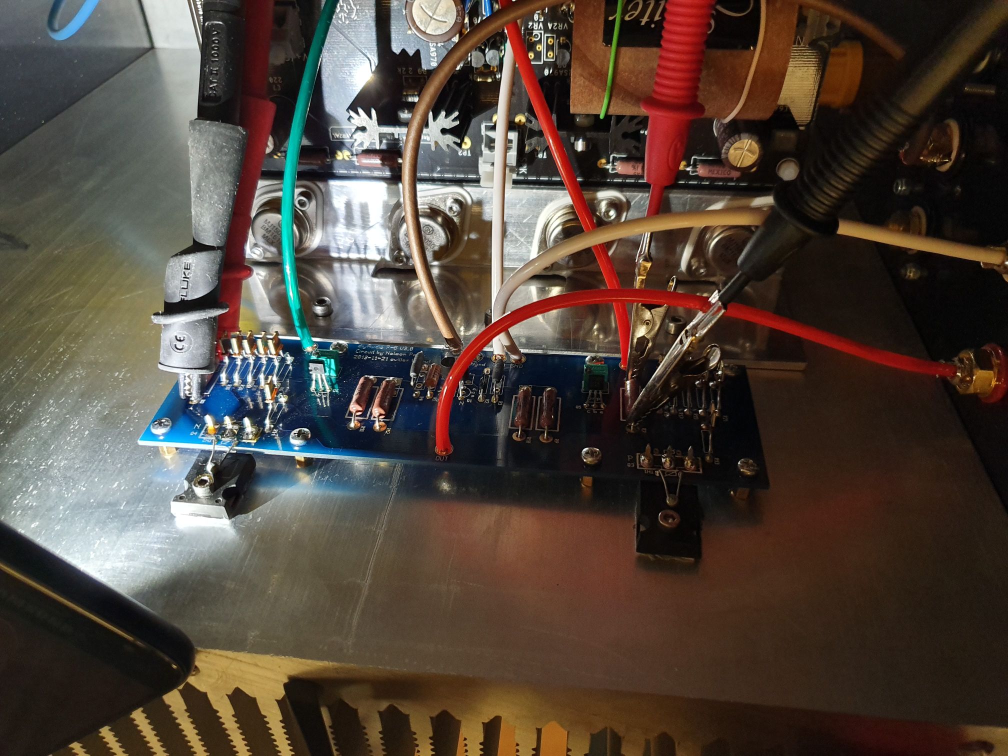

I started bias left channel.
I am in the midde of bias, The heatsink is not heat up maybe because of it is huge.
And second speaker bindings go high as 0.3v instead of 0.1v as written in the guide here.
What could be wrong any idea?

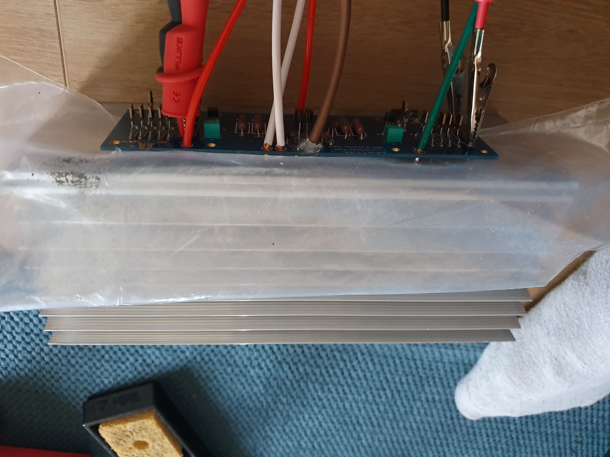

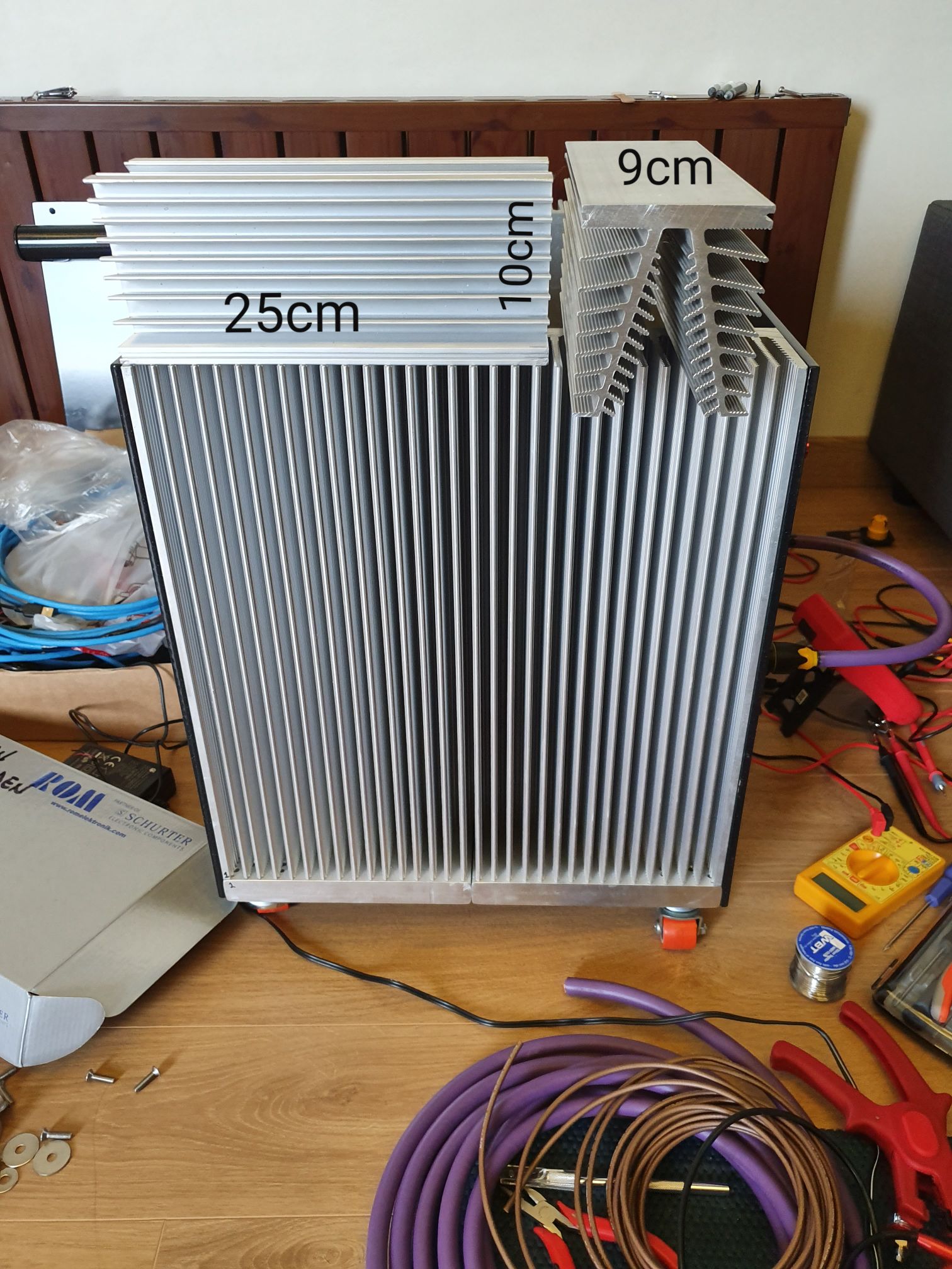

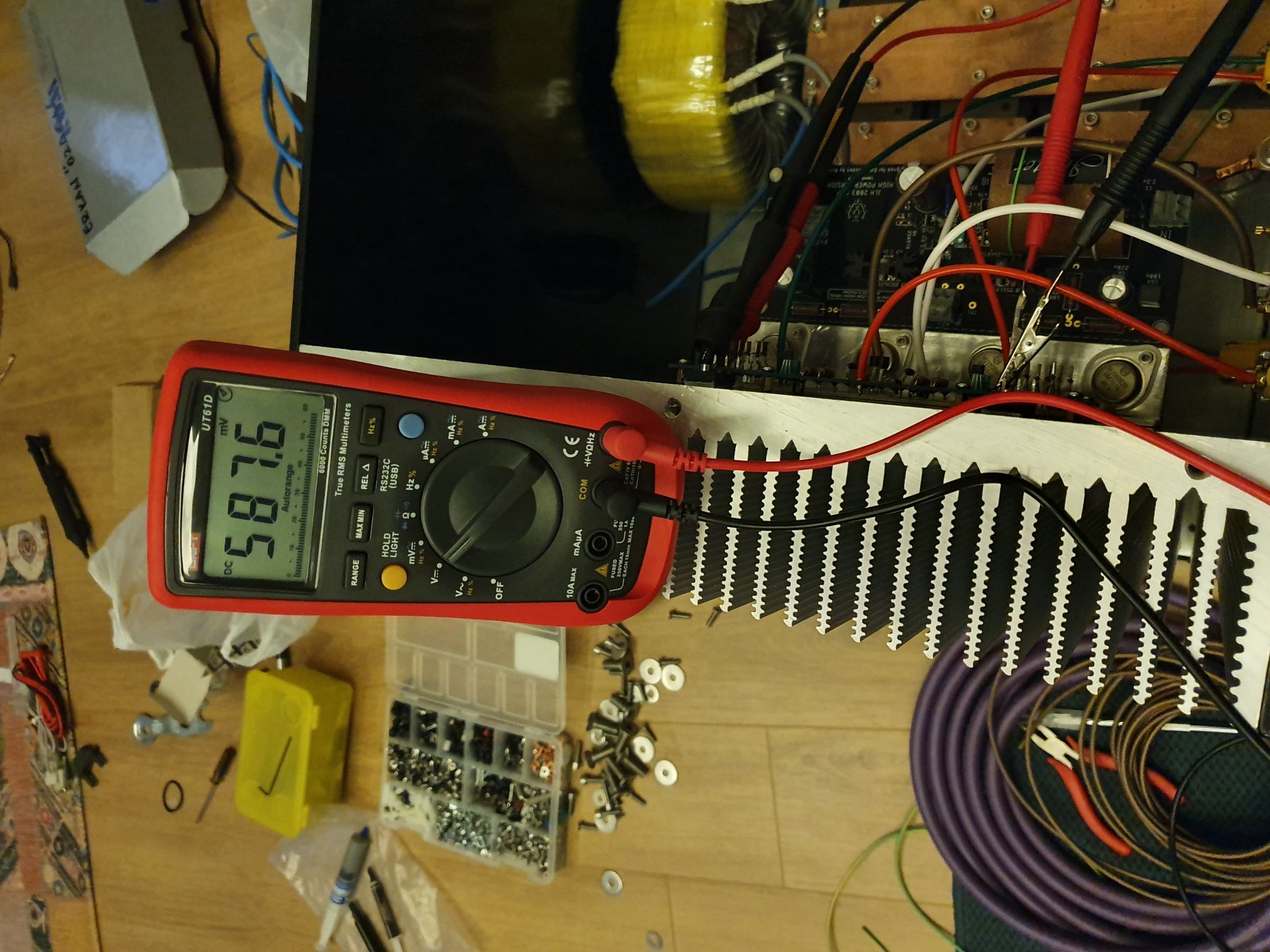

After couple of hours waiting it only warm a little bit.
I guess i néed much smaller heatsink.

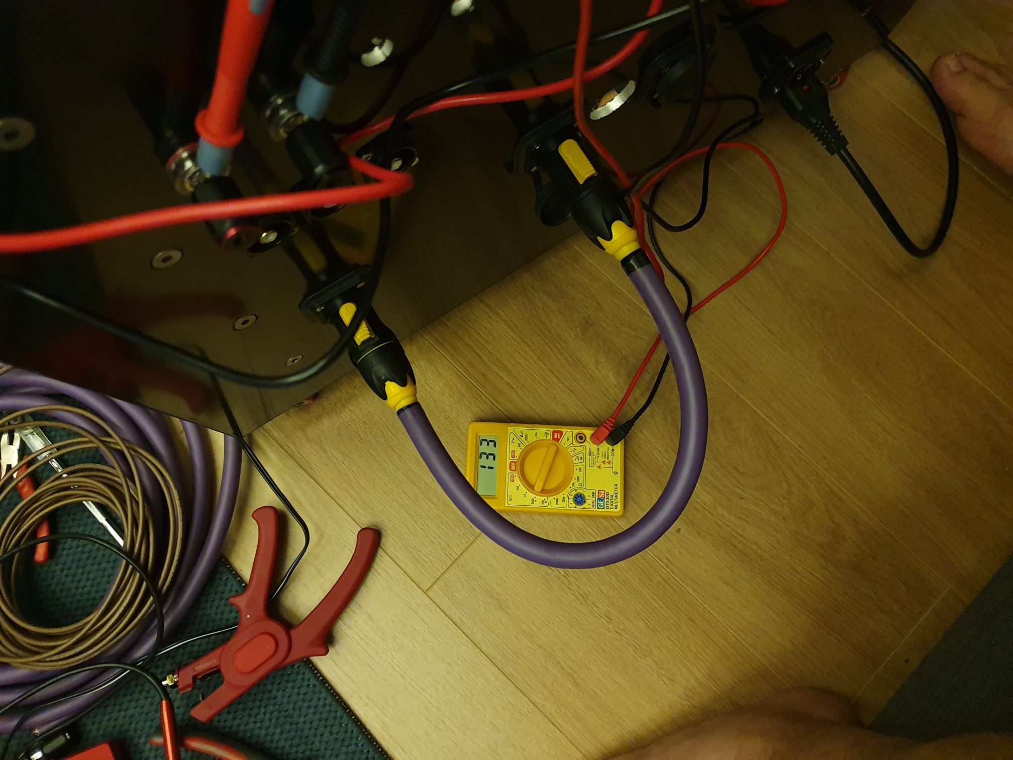

Btw voltage drop 21.6 from 23v under load in clc setup

The limit for bias is 65C on pin 1. You seem to have large heatsinks, which is good. Going a bit above 0.6v is not going to cause any problems.
As others suggest, adjust bias as required to get DC offset as close to zero as possible. This may result in the two mosfet having slightly different bias voltages, which is normal as Vgs varies greatly from the P channel to the N channel

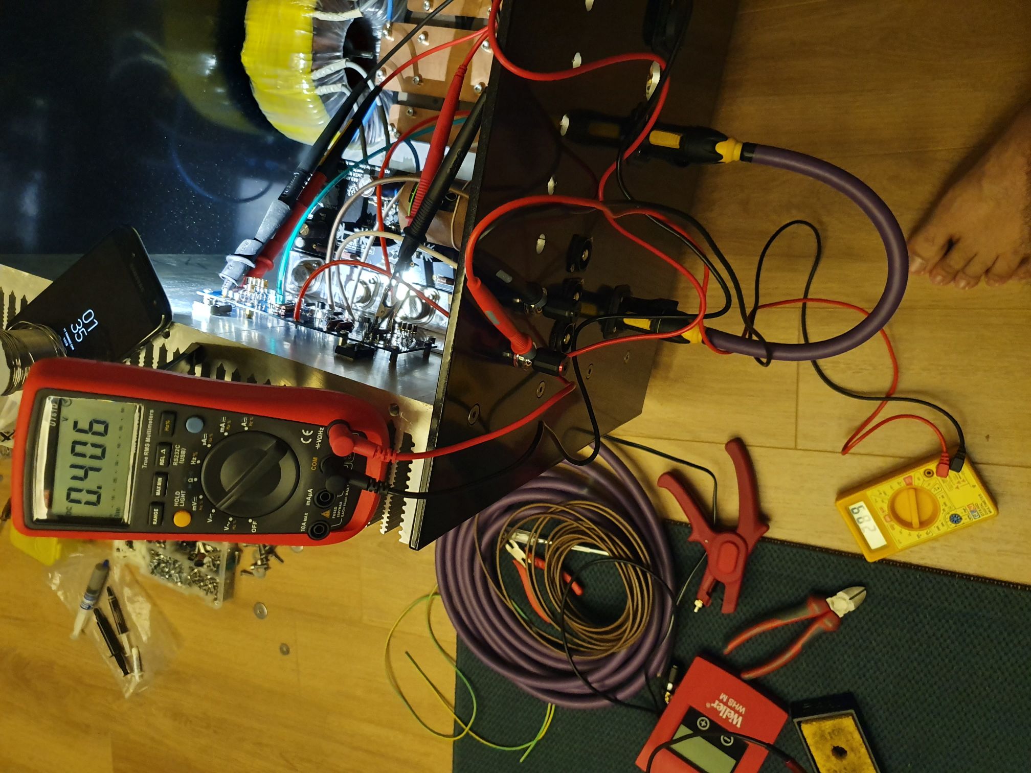

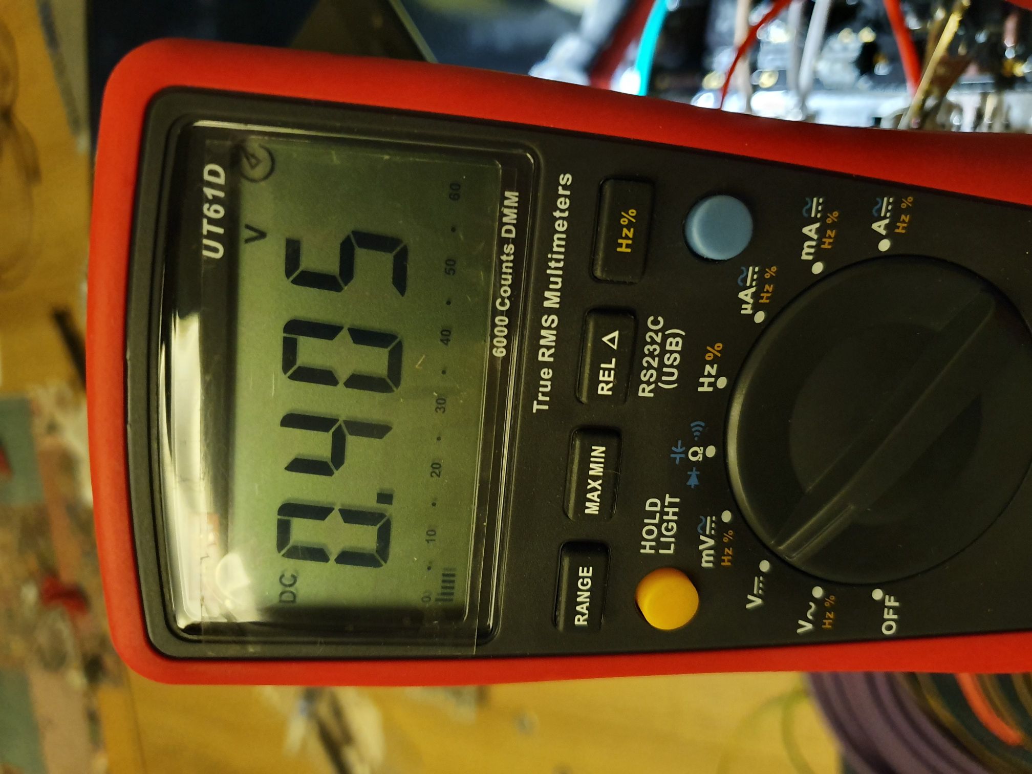

Well i tried with small heatsink. I guess i did it. I realized also and want to write here for the newbies like me.
P2 and p1 doesnt have to have same turn. Only this way i can achive the expexted results. I thought lets say if i half turned p1 also i need tho half turn p2. But it is completely wrong.
The only issue is i can not touch heatsink wih bare hand more than 1-2 second. But afer assembly whole case with the rest of case parts which will be aluminum also i guess i will be not a big issue.
Thank you all for help folks.

Congrats! Do you have an infrared thermometer? It's very useful to know the temp of the heatsink and the mosfet bodies.
