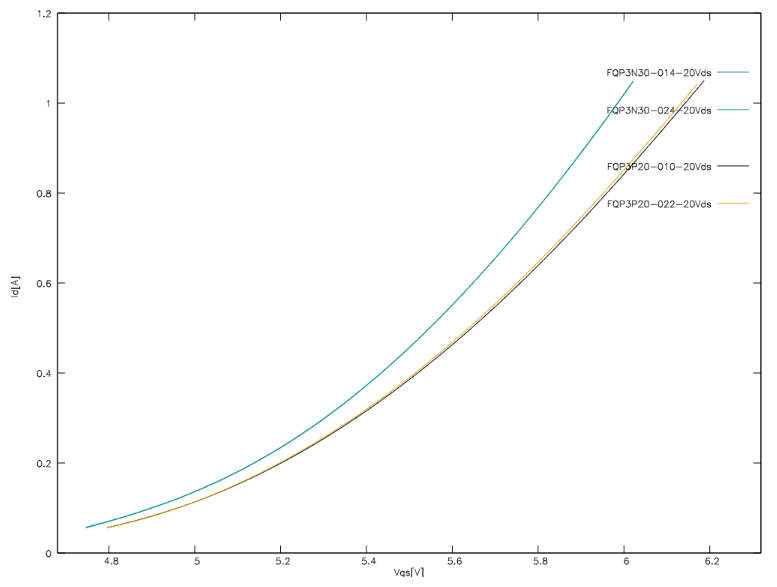

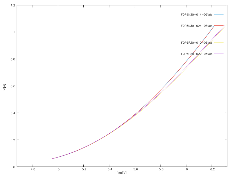

A simple circuit like the F5 using complementary devices depends on the complementary characteritics of the active devices for even harmonic cancellation to achieve low distortion. This is particularly the case if you are not using a fully differential circuit like the F5X.
As I have published over a number of threads, the only truely complementary power MOSFET pair in TO3 package is the 2SK1530/2J201. There is another pair in TO220 from a different Japanese manufacturer which is now totally obsolete. The next best pairs in TO220 are 2SK2013/2SJ313 (if you have lots to match from), and FQP3N30/FQP3P20. But the Fairchilds are much more Vds dependent. This is where the Toshibas truely excel. A bonus of this is of course much improved PSRR.

This has not been published before.
It shows a quad set of FQP3N30 and FQP3P20 measured at different Vds.
The N- and P-devices have significantly different dependencies.
Patrick

> the Fairchilds gm matched up better
If you were referring to the original FQA19N20C / FQA12P20 then I cannot disagree more.
This has been published before in 2008 although I cannot find the link off hand.
Patrick

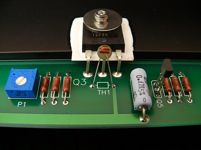

Hi Patrick,
original f5 have more gain on negative half wave, because j74 have more Yfs
then k170, same with output devices. (N is with more gain).
But is not enough, look at that pictures in attachment, P output is more
degenerated then N output.
Makes sense only if k170 is with much higher Idss then j74,
or asimetry is wanted/intended.
