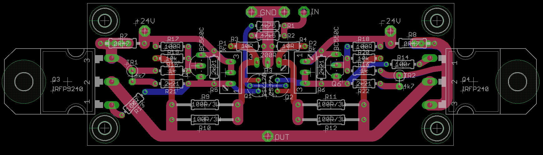

This is the revised layout, this time I have used the newer Schematics (V3 :rolleyes: ) , and put the gate stoppers as close as possible to the FETs gates.
I even doubled the lines where possible, they are now on both sides of the pcb.
Would it be of some use to have large ground planes on both sides of the pcb?
On digital layouts I always use them, on analog I'm not sure, kind of different thing that I have to learn and understand.
Any more hints / comments / ideas?
Thank you again for your great support ! :spin:
(And yes, I will rotate R13 to 0°)
Hi micha,
The PCB looks nice, tracks are reasonably short: if you are still looking for tweaks, move R3 R4 & 200R preset to the bottom of the PCB, why have current running around the board where you don't need to; it probably won't make any difference being where they are now as the tracks are at right angles to the adjacent tracks.
Is the PCB going to be PTH (plate through hole)? If not, you won't be able to solder the tracks on both sides of the PCB for the 5K presets.
The mounting holes next to R7 & R8 look a little too close the tracks, the last thing you want to do is to short the tracks to the heatsink, nylon washers on both sides of the PCB could be very handy here.
I don't recommend large ground planes, they can introduce their own problems - eddie currents etc, I'm with Dennis Morecroft on this one (designer of DNM).
Moderator
Joined 2002
There's still something very funny about the way you have drawn in the ZTX, the tracks don't mirror yet the devices do, so you're going to have some issues if you install them like that.
The space you have kept for the source resistors of the output devices seems really small, though I do see pads for upright devices (which should be all right). If you are using TO-2xx style devices you might want them to mount on the same heatsink. In any case I would move what is potentially the hottest component on the board clear of standoffs and bolt heads.
I wouldn't know if a ground plane would help on a design with such low noise gain. Also there are only three ground nodes.
What I'm really uncomfortable about is the fact that the highest current node is right next to the lowest current node. This will cause issues with the output radiating into the input, low gain notwithstanding. Normally you want to keep all the high current stuff well away from the input and feedback sides.
I don't know why I didn't raise that point the last time around. You'd be better served by moving the input and the JFET source resistor side together and the output on the other edge.
Thank you both, that's why I love this forum, with your help even a noob like me can build something real good! :D

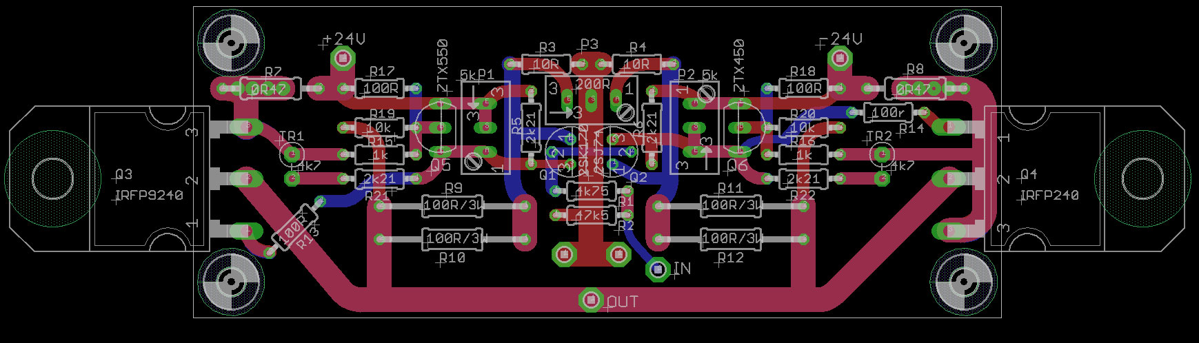

I've worked on the layout again, I put the Input to the upper side, and that made a few things much easier.
Beside the pure red and blue lines, every line is doubled onto both sides. And of course, the pcb is PTH.
And sangram, you were right, there was a miskate in the library of the BC550 / ZTX450, I just renamed it without checking the connections. Thank you ! I think, now it's better.
I think I can change the ZTX to the BC as I've seen them several times in other layouts of the F5. ZTX are hard to get in Germany...
Number 3:
Do you still have any tweaks?
Moderator
Joined 2002
I would build now. Last suggestion is to not double the low current traces, such as input and feedback. Just the output and power traces should be sufficient.
The library problem you faced is a pretty common one, now that I remember we always have an issue with the pnp part pinout. Just looking at the overlays is pretty easy to spot and simply rotating the part when installing fixes it.
Yup
Turn BC560 and move R19 down then U can get rid of ugly Blue track :D
Repeat for other side
