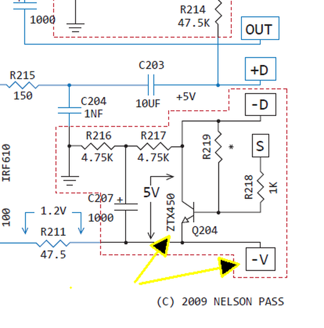

A shot in the dark....I'm not knowledgeable enough to translate between circuits, but those adjustment problems sound very similar to what was happening with a bias boards on my BA3. In that case a defective Q204 was the cause. Maybe one of you gurus can determine if the same thing might be happening here. :)
