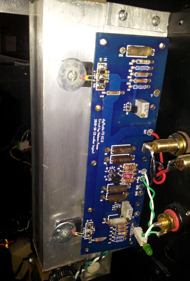

..... If you had instantaneous heat spread it wouldn't matter at all where to mount.
but you have not ...... at least when we are speaking about heatsinking systems working in 50-55C range , which is , by experience , most economic solution (in other words ,+25C above ambient temp)
of course that entire issue is nonexistent if you'r eusing Eiffel Tower to cool 2 x 100W of dissipation
though ..... in that case , output devices will certainly be cooler mounted on top
If you use a simple Right Angled bracket to support those pcbs, you can more easily adjust the trimpots from above after assembly, and can also shorten the wires from the power supply, etc, etc - otherwise not much heat distribution difference, as noted above.
Just go for it ...
Just go for it ...

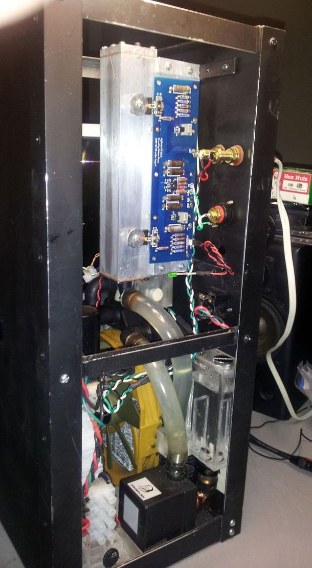

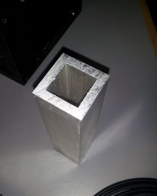

My screw-up might add a little perspective here. This liquid cooled build uses eight inches of square tube with 1/4" walls. By mistake it ran for hours with the cooling off. Don't know how hot it got but the amp was and still is stable and sounding great. In this case the heat spread was probably most significant - though there was obviously some convection with the vertical format.
Could not get away with that with more transistors like a BA, but the F5 really isn't a fire breather - correct?

Nice chimneyeight inches of square tube with 1/4" walls.
O right, but maybe it would actually work?Not actually a chimney as the tube is sealed on both ends.

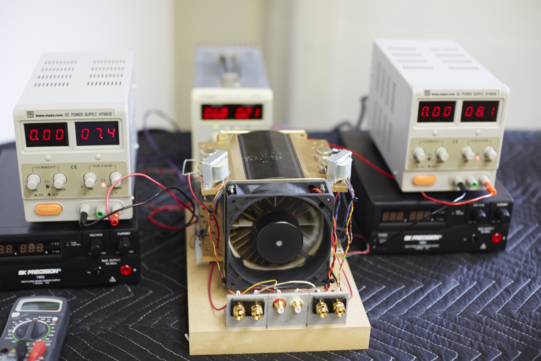

Here is one more example of my favorite tunnel heatsink arrangement which is shown without the use of fans. http://www.diyaudio.com/forums/pass-labs/216616-f6-amplifier-510.html#post3575862 The reason I like it is that the chassis is extremely simple to build and the PCBs are easily accessible for tweaking and modification.
I need to do some tests, but I suspect that the passive (convection cooled) fin-to-fin heatsink arrangement has a thermal efficiency as good as or better than the "ordinary" arrangement with the heatsink fins pointed outward from the sides of the chassis. This may not seem logical, but the tunnel just might improve the airflow. I dunno for sure, but some experiments are in order. I just need to turn the heatsinks around to face the fins outward.
