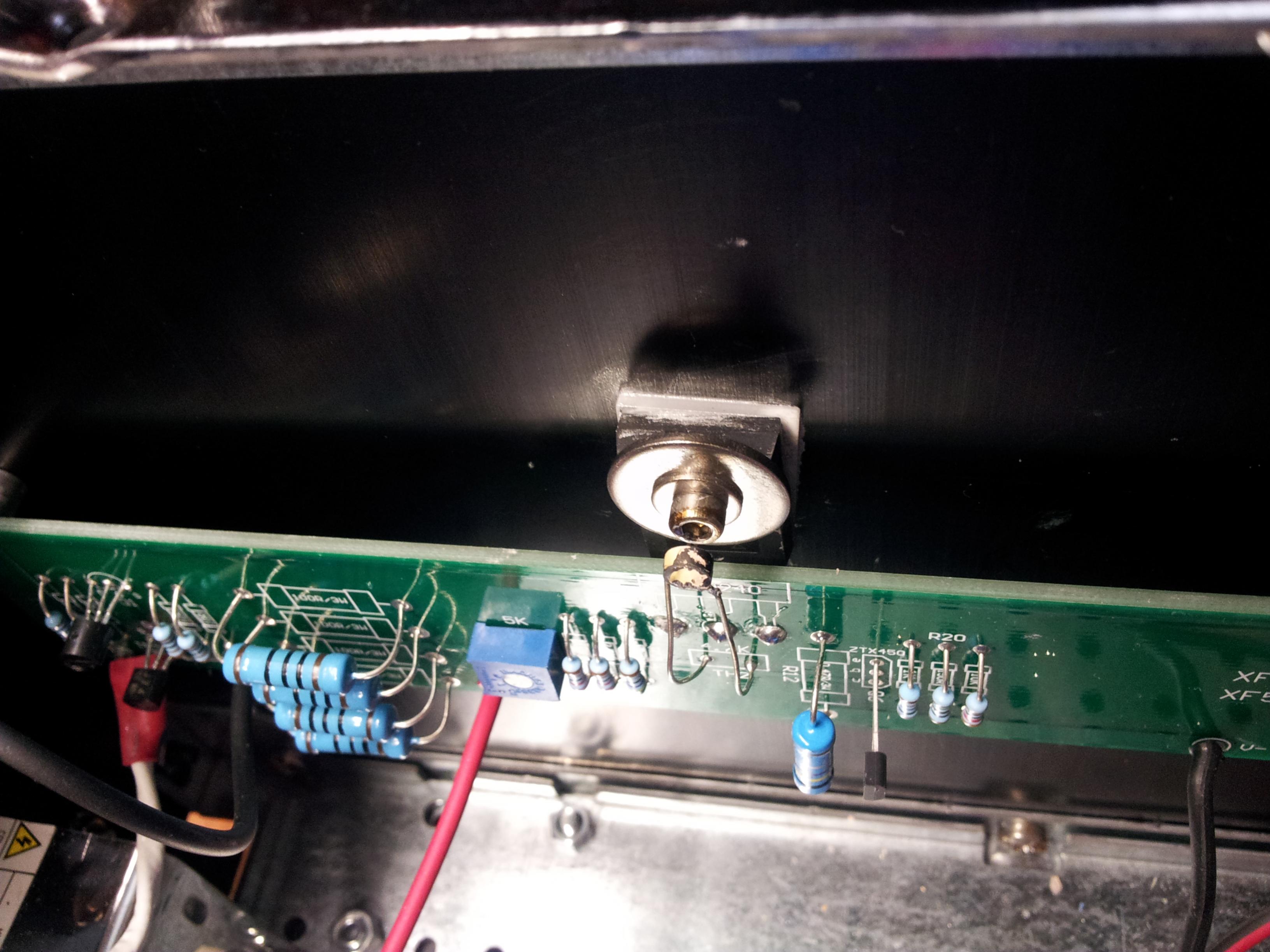

Just be careful that the thermistor insulation is not compromised so that an electrical is possible from one of the thermistor leads to to any of the MOSFET leads (such as the drain). My first F5 build taught me this lesson.
As mentioned in the thread earlier, Would quick set epoxy work for thermal bonding glue to connect thermistor to FETS, or ok to just have them touching?
I have also learned that lesson.
Burned a trail of pcb, one pot and R.
