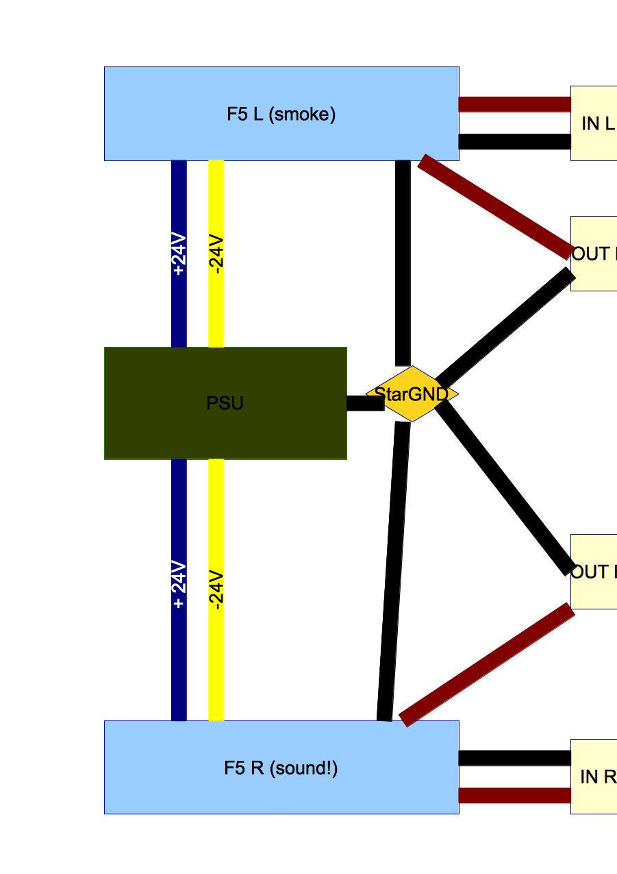

If the shepherd (AndrewT?) can guide me back to the right path, I will have to accept that... In my defense: I used the bulb whenever I could... tested it with bulb, tested it again with bulb, tested again with bulb, tested without bulb, tested again without bulb.... tested with load+source: Smoke.
another update... I only saw smoke on one side, but I am starting with the bulb tester now (omitting the softstart), and on both(!) channels I can't get the power supply higher than +/- 7.5V (bulb stays on).
Power supply unloaded is +/-23.5V
What steps should I follow to determine what's wrong?

I did...! One channel only, both the bad one and the 'good' one give this result: +\-7.5v!
Strange thing is that i did hear music! Not sure if that was on one ir two channels.
Edit: but hold on.... I now did another test, with a normal IEC cord (without bulb) and tested the 'good' channel:: I get normal input voltages again!! So the bulb tester influences the voltage to the channels (400VA transformer! 60W bulb). This also means that if I had the b*lls, I could test the 'bad' channel without the bulb and see what happens... I don't think I have them though
EDIT AGAIN... : I think my logic in the first edit was flawed... I have tested both channels before hooking up to speakers with the bulb tester, and the bulb went off like it should....

zen mod said:it's biased = drawing current , so bulb must lit and drop tooo much of mains
ditch bulb tester out and power up - without speakers,please
check bias and offset
'Bad' channel got the fuse blowing when I power up with a normal iec cord
Ok... strangest things happening here:
I put down both trimmers P1 and P2 of the bad channel back to 0Ohm --> tested again with my last fuse and normal IEC cord --> Tataa... nice 47V supply power to the channel, of course 0 bias, and a little DC offset...
Then.. I though.. what the heck.. and I started adjusting the P1 and P2 trimmers... and guess what: I could just trim them to 0VDC offset and 0.5xxV bias... like nothing happened...
All of course on the bench with no speakers or preamp attached.
