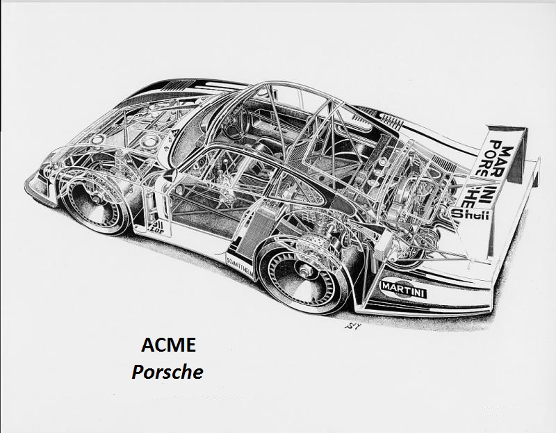

So one turbo and and one intercooler per bank... so this must be the whole blueprint here then-
