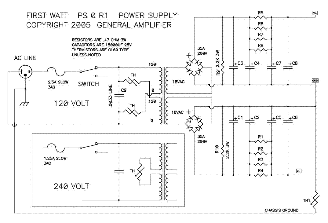

I wired my F-5 up and have not yet installed the thermistors in the primary leads. In the FirstWatt schematic of the power supply, it shows the transformer primaries as "120" "0" "120" "0". Are the center "0" and the center "120" crossing over each other? I thought that was how it was, but another builder has difficulty with that and says the place where they appear to cross should be joined, so the thermistors are together at that end, and his amp does work. Before I screw up my perfect working (except no thermistors) F-5 I want to get this straight. Usually when something appears to pass over but is connected, there is a "dot".....can someone straighten me out on this minor wiring issue?

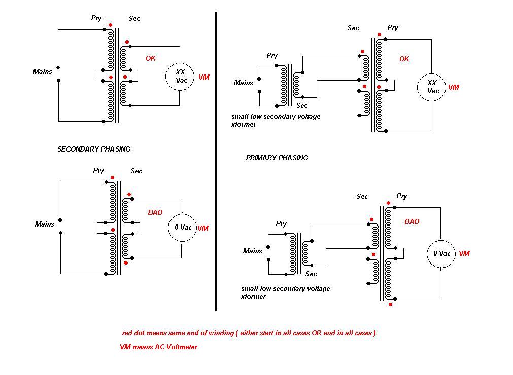

even if I don't understand your question completely , maybe this will help
Looks like it would, but the pic doesnt blow up big enough for details, maybe its just my crappy computer at work, I'll try again when I get home. Thank you very much for trying clear this up.
Ok, it blows up now, but I dont think it clears up my thick head.
On the FirstWatt schematic for F-5, it appears to have the center two primaries "crossing" over one another, then going to thermistor, or that's how I saw it. I'm dicussing with another who doesnt think they cross there, but are joined, which doesnt make sense to me, but there is a lot I dont understand. I am going to install my thermistors now and was a little confused.
Russellc
Perfect! This is what I thought ! Further conversations reveal I was missunderstanding my friend's comments. He said "nothing in schematic shows crossover" meaning this confuses some, I thought he meant they didnt crossover!
