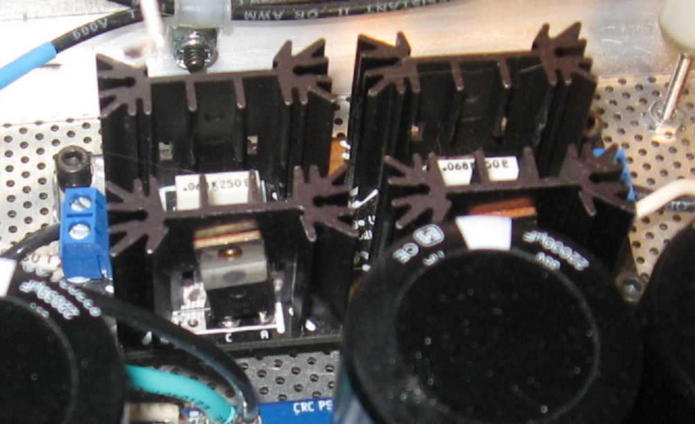

Heatsinks for rectifiers
As Christian (Cviller) suggested when I was building my F5. Use high quality heatsinks and CLIPS to secure Diodes to the HS. Very clean looking with snubbers too!
Ron
Ron
