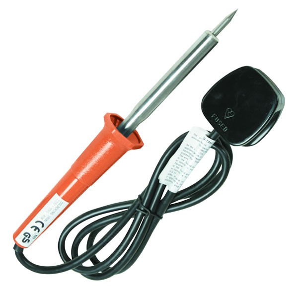

I was referring to the picture I posted, being "passive" suckers, so you still need your conventional solder to heat the thing.
BTW, just a nomenclature question, in english language, call you solder both the tool and the consumable?
http://www.howardelectronics.com/amtech/images/63-37-031.jpg
http://www.myopenrouter.com/downloads/newsletter/20100922/solder.jpg
I see solder as used in a joint between two or more components.
"to solder" is equivalent to saying : form a joint by soldering.
You can apply solder to a component without joining it to anything. This is normally given the term "tinning".
Similarly you can apply solder to the tool. If the tool is hot enough the solder will melt and flow over the clean metal. The cleaning coming from the action of the flux. Again this is referred to as "tinning".
There is another term given to preparing a soldering tool tip ready for soldering, what is it?
But to plate an item with tin is quite different.
Tin plate can be by electrolysis or by hot dipping, maybe sputtering as well.
Yes, be careful to differentiate between tin and tinning, one is Sn the other is solder and in the old days that meant Pb/Sn.
Now it's clearer, the name for the material is Tin and the name of the tool is Solder.
afraid not.
Tin is Sn
Old fashioned solder is Pb/Sn in a ratio to do the job required of it.
Electronics normally uses the "eutectic" ratio of 63/37 but there are an infinte number of non eutectic ratios. Plumbers solder is almost the reverse of the eutectic. This gives the solder a wide pasty temperature range and during the pasty stage (as the molten solder cools towards the solid phase) the joint can be wiped or reshaped or moved around. The plumbers "art" is almost lost.
The tool is a soldering iron.
The hot part is the "bit" short for tool bit.
