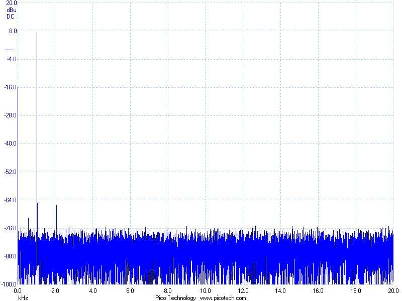

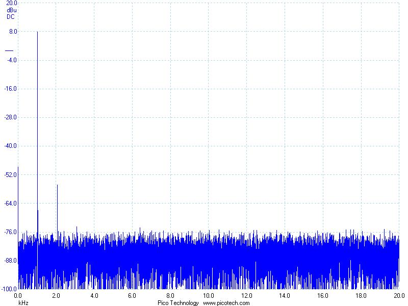

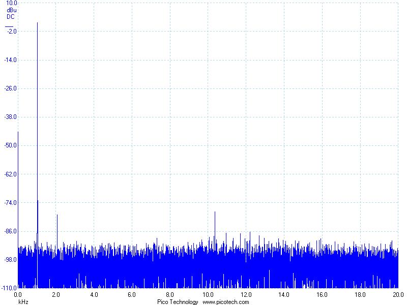

Nothing new here, but I am very happy I started to tweak the amp, just to get hands on on how things go.
The first picture is the FFT of the signal of my generator. I think not the best (anyone can recommend any good software or file to use? )
On the left channel I measure THD 0.02 % at 4 W and I have more than double on the right one. So I started playing with the right channel. I attached a 3 ohm resistor on one side and the distortion went up, so I moved to the other side and I brought back the distortion to 0.02 % adding two 0.47 ohm in parallel. I was really easy, and it did not move the bias and the DC offset of the amp.
Is there a lower limit for the source resistor ?
The pictures are before and after.
Fun !
D.
