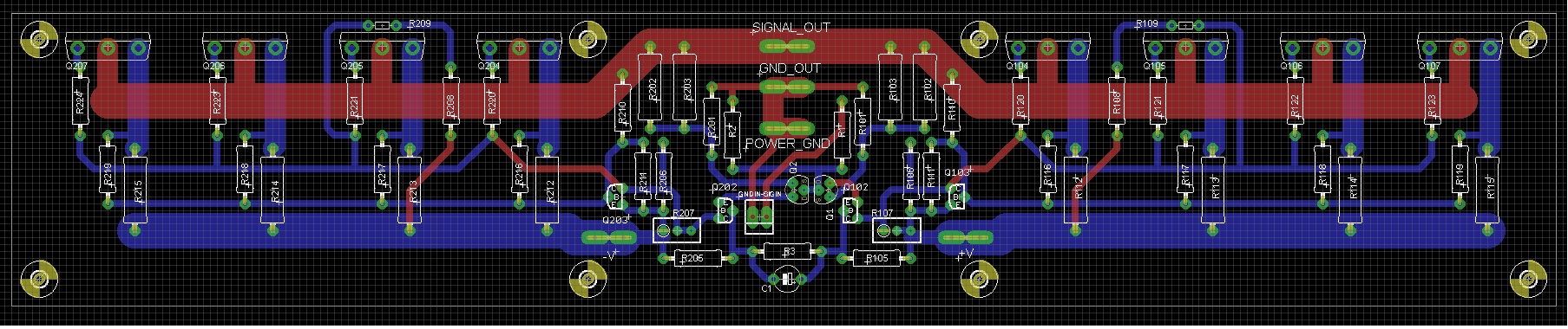

So, im asking again, what are the driving capabilities of the 2 input JFET's, people have succesfully made 3 output pair F5's so 4 pairs might work as well. But would be nice to have some sort of confirmation on that before I spend a small fortune on PCB's.
Optimized layout with gate stoppers closer to the FET's and moving of the input should be done soon.
I do not know the answer but you can still parallel input Jfets if necessary.
