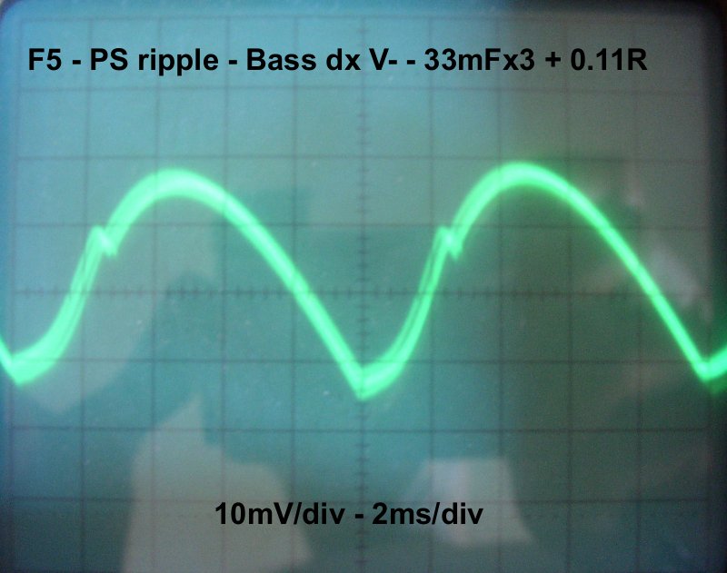

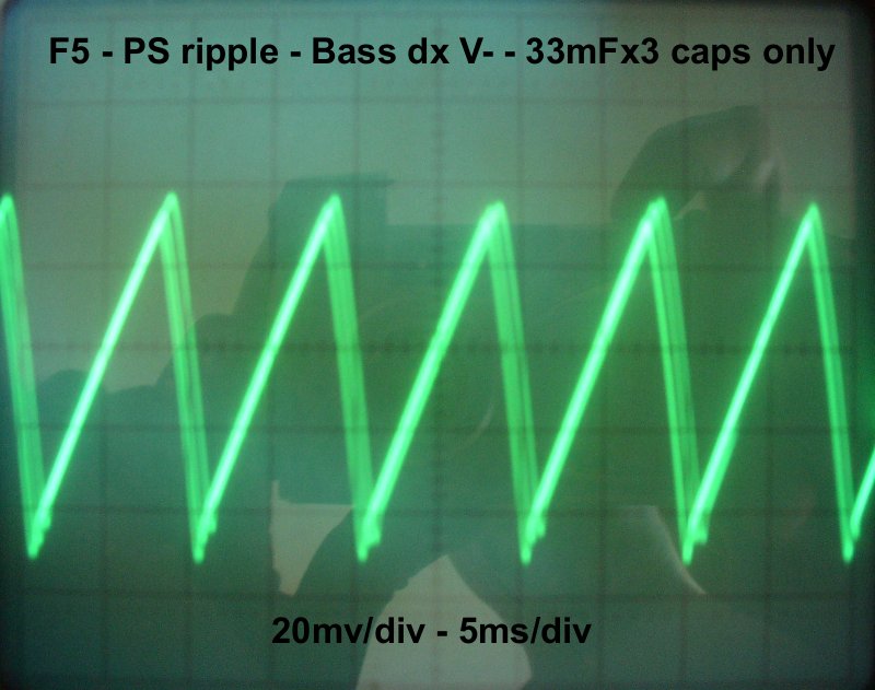

I think it's advisable to place the resistors between the caps as Pass scheme.
This is the ripple in my F5 at the board input without and with resistors.
(quality picture is low due to no camera tripod)
I enjoyed a marked sound quality improvement with R installed.

I shot scope pictures some time ago when I was aware that one of my treble monoblocks (I built four in biamplification) was clearly harsher than the other treble channel. I forgot to insert the R. After adding the resistance (from C-C-C to C-R-C-C) both treble channels started to sound similar and the modified one lost the harshness I noticed before.
Another 0.16R (C-R-C-R-C) limited and smoothed ripple to around 10mV, but I didn't notice any clear sound improvement.
