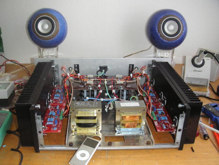

I love projects wich are running from the beginning.
No debugging needed (I can assure you, it is not always like this) :)
It's the first half hour, the amp is playing music. I set bias at 1A.
The heathsinks and the trannies are getting warm but not hot. I can touch it as long as I want.
Maybe I go up to 1.3A
But I have to look at the rails voltages: actually, with 1A each, I have rail voltages of +-11.2VDC. It should not drop much more, when I increase idle current, otherwise I will loose all headroom.
Here a more inside view:
Franz
I'd reckon you end up with less than 3W continuous power per channel, for 7 times the dissipation.
Like a tube amp, isn't it?
The little difference: the F5 is sounding awesome...
Jacco: I build this amp to drive my high efficency midrange and highrange horns. Not more power needed.

To be honest: 4 times dissipation is more exactly. Like the big F5.

Yesterday evening I replaced this two t-amps by the Mini F5 to drive the horns:
There is still one TK2050 T-amp driving the four FW250 woofers, waiting for the "big" F5.
After reajusting the levels of the crossover, the thing sounded quite fine, but I missed the magic from my other F5 experiences.
Even the small Veravox 3S I used for the inital test of the Mini F5 showed this fascination: they also play bass, driven by the F55!
After one hour, I removed the big black caps between the amp and the speakers.
Thats it! The fascination comes through now, but still missing some punch in the bass area. Waiting for the big F5 as I already wrote...
I remarked, that the Mini F5 standing in the rack and playing music, gets up to 55 degree on top of the heatsinks, about 32 degree over ambient level.
So, 1A idle current will be the max for my setup.
I will try some other bias settings as soon as I have time. Maybe I can drive the tweeters with different bias than the midrange.
